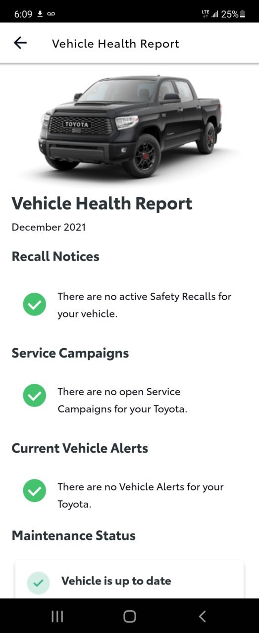

  10. Dec 1, 2021 at 8:31 AM
    #70
    diablodalton
    diablodalton New Member
    Jun 27, 2017
    #8307
    324
    Dalton
    Oregon
    2021 Crewmax Platinum MGM
    8" Ready Lift, SPC UCA's., Bilstein B8 8125, Amp Steps, 37/12.5R 20 Cooper STT PRO, On order: Valhalla Armor, Dirty Deeds Exhaust
    Do you have access to a different lookup tool? I have checked on the Toyota site and via my app.
    This is what I see when I punch my vin into Toyota's site

  13. Dec 1, 2021 at 9:29 AM
    #73
    tundraiggy73
    tundraiggy73 New Member
    Nov 15, 2021
    #70651
    68
    2021 Cement Crewmax Trail Edition
    That's probably accurate, but yes I do have a different way of looking it up.
