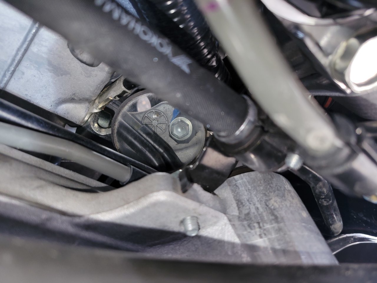

    I did not read all 17 pages of this thread, but I think the original post is about a different recall than the one sent out in Feb 2022.
    The recall I received today states 151 vehicles are effected if you were in for service for a power steering rack replacement after August 5th 2021. NHTSA 21E-103. Based on the verbiage, it does not to apply to me, but I did receive the notice.

    So i compared some of the failed pie pics in this thread and they are in the same pie piece location. I dont see any letters so im just going by failed dimple placement. Theres 8 pie pieces, my dimple is in the pie right next to the piece in the failed pics . Im assuming theres a,b,c,d,e,f,g,h locations so my dimple is in the a or c location. Heres a pic. Thanks

    Sorry forgot to mention build date 8/21. However as seen in the pic, the dimple is in a different location. Theres 8 locations the dimple can be set a,b,c,d,e,f,g,h, and the b location is fail. Im comparing to two other peoples pics of fail racks dimple locations. If that makes sense

    Basically just need to know- the pie chart on the rack, are the 8 pieces of the pie - a,b,c,d,e,f,g,h? Or half of the pie is A other half B?
    Witht his information there is no need to take to dealer, I have a degree in automotive technology, I am an ASE certified toyota tech with 6 yrs exp. However I am currently not working for a toyota car dealer (forklift). I am approved to do most of my warranty work myself and document it, but I am unable to acquire this info.
    With the proper information some of us can diagnose the rack to be pass or fail. Some folks know how dealer techs work and dont want them anywhere near our trucks.

    Found the information I needed on page 7, My rack passed my inspection and I will be documenting it myself.
