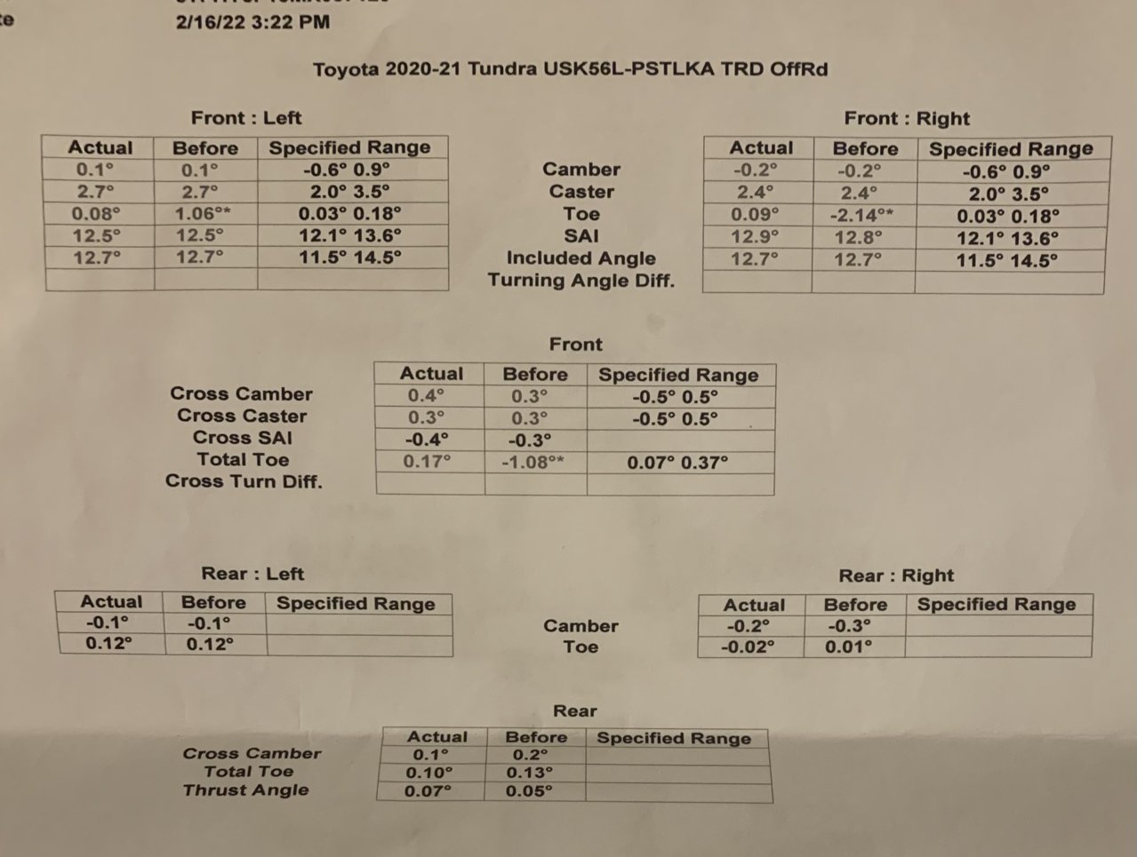

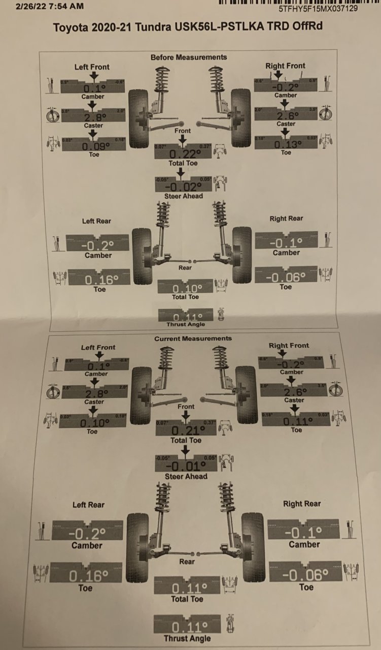

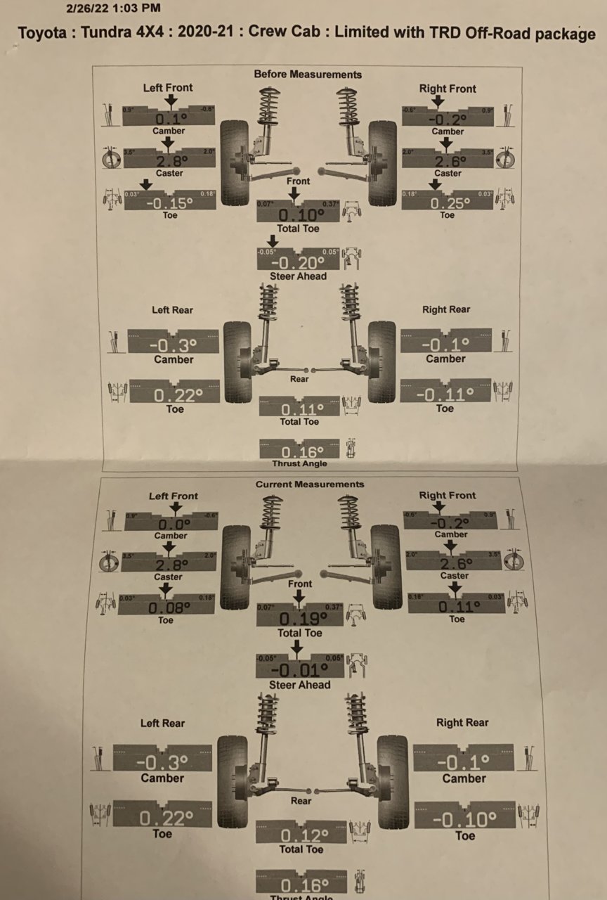

    For anyone that fails and gets a new rack, check your alignment sheet before you leave and then take a test drive. I’ve been having issues with my steering wheel not being centered.
    Took it back to the dealer and told them I wanted the steering wheel centered and the left caster .5 less than the right to compensate for road crown. I was expecting to be in and out within an hour. Didn’t happen though. 3 hours later they said it was perfect. I looked at the print out before I test drove it and they didn’t listen to me. The caster is still higher on the left. After a test drive the steering wheel is still off.
    I went back in and talked to the manager and explained the issue. They had a “master tech” come out and said he could correct everything but he would need to finish what he was doing. They offered me a loaner for the few hour they needed, but I had my son pick us up to run errands. Get the call that it’s done. Look over the print out and they still didn’t listen, however the steering wheel is centered and the truck tracks straight from what I can tell. They said that when they put the rack on last week the steering shaft was off one tooth. I said “doesn’t it have a spline or key way it lines up with” and he said not ok Tundras.
    I’ve wasted a lot of time on this and frustrated but it does drive straight and the wheel is centered. Will the current adjustment wear tires. If not, I may Just let it go. Note the times on the sheets below. The 1:03 is the latest.

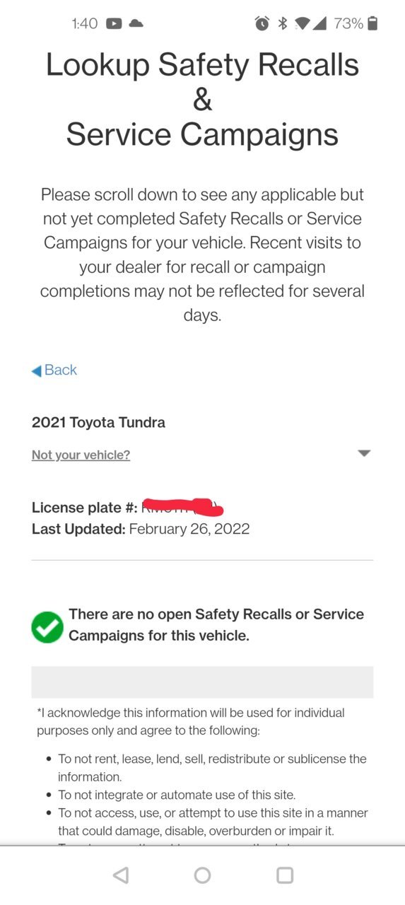

    I went there no recall for the Power Steering also not on Toyotas Site or the APP. I will be going in soon for my first oil change hopefully my rack is good.
    My truck was held at the Port for a extra month supposedly for steering column issues.
    I do have notification of a DCM Service Campaign which is new.

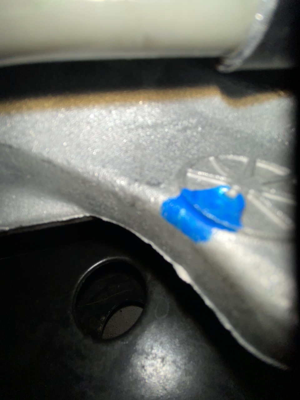

  26. Feb 27, 2022 at 3:50 PM
    #476
    clay5313
    clay5313 New Member
    Aug 30, 2021
    #67439
    23
    Hood County, Texas
    2021 LR PRO
    Update: Replacement complete. No noticeable difference. Pic of new rack with blue marking.8CC317A3-AB0C-4BE1-9B9F-B84725A3D3D4.jpg
    My truck was manufactured 8/21. I took delivery 9/21.
