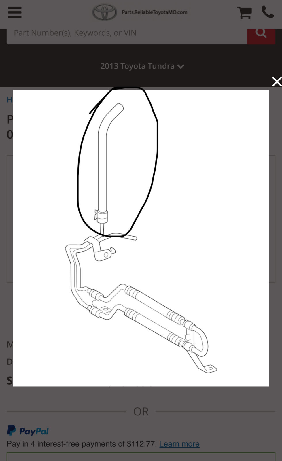

    Does anyone know how I can just get this hose without ordering the entire power steering cooler lineIMG_9064.jpg

    Can’t order it separately. You could probably make it if you have the right fittings. If it’s the high pressure PS line, best to have a hydraulic shop do it. I can’t tell by the diagram.

    On my FGT could not purchase separately and OEM part was crazy expensive. I purchased the sun song line from Rock Auto and used only the rubber hose. I think that like 75.00 but a fraction of OEM price

    It's hard to tell if that the pressure line or not. So me, it kinda looks like there's a hose clamp on around the line? If so, then you can probably buy a new rubber hose from a parts store. If not, AND you were crafty, you would braze on the appropriate sized AN fitting (maybe a -4 or -6?) on both end of the metal pressure lines. Then you could buy whatever length hydraulic line you want (such as Aeroquip). At the end of the day it's probably easier to just buy a new one.
    So it that rubber PS hose preformed?

    That’s a low pressure return line. Probably 10mm ID, but 3/8” ATF/fuel hose works in a pinch (double check ID).
