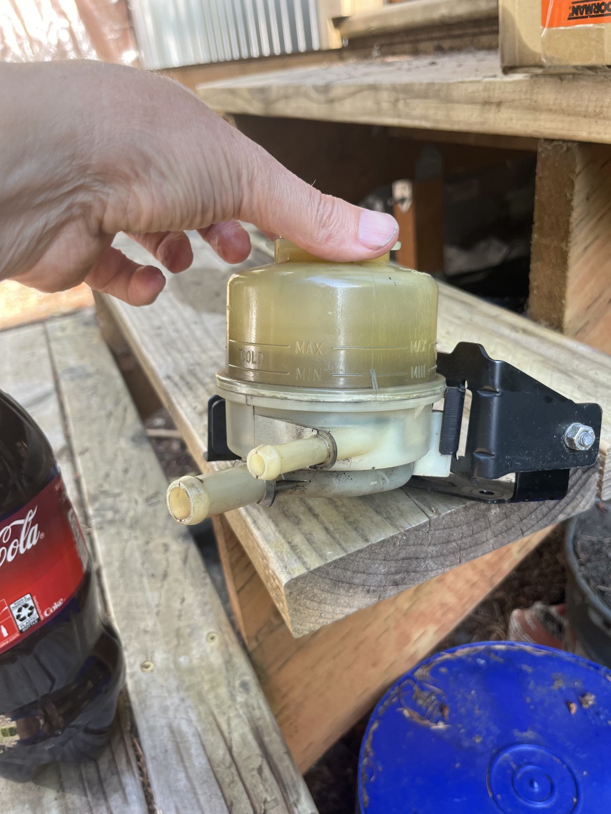

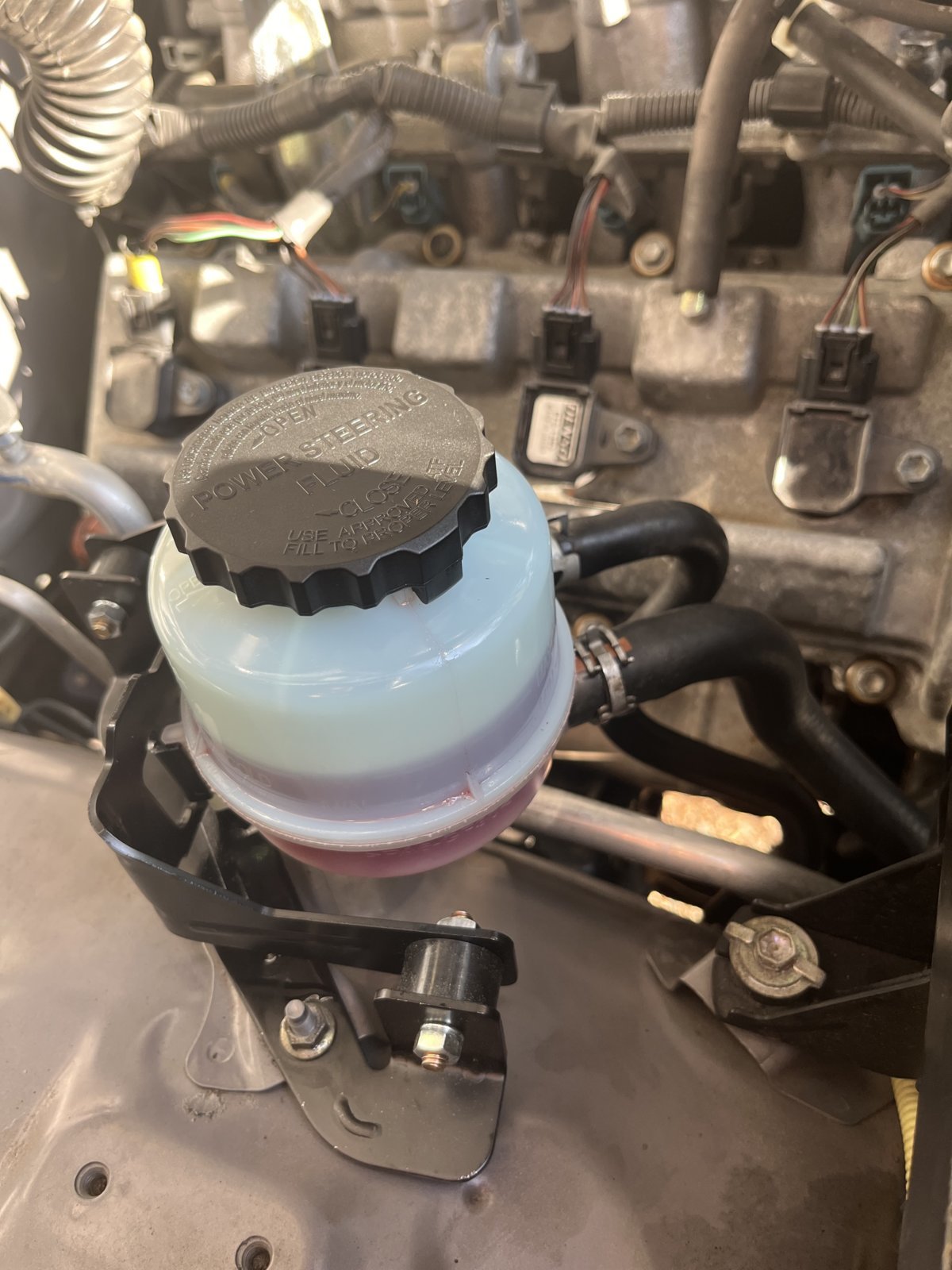

    Just did this. Replaced the reservoir and the hose to the pump too. So many original hoses on this truck. Now I can see the fluid level. Old stuff was way dark.
    bmf4069 and shifty` like this.

    Pics man, show us some pictures befor @bmf4069 comes in here, like, "Yo dawg, we like pics, like, a LOT"
    G_unit3000 and bmf4069 like this.

    I used a doorman reservoir. I bought a factory hose though. I think it was $70. Expensive little thing.
