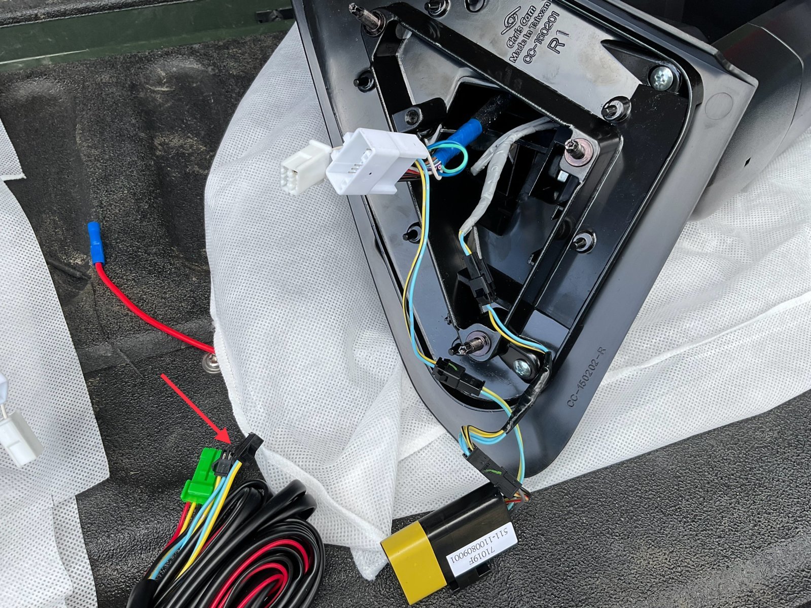

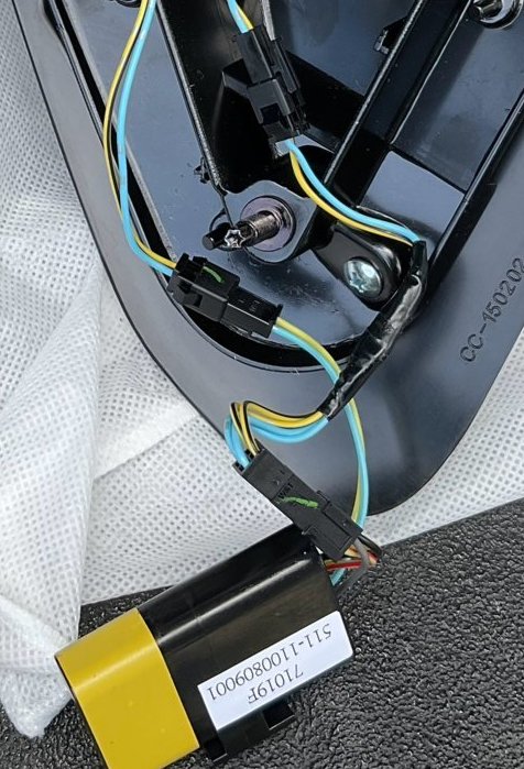

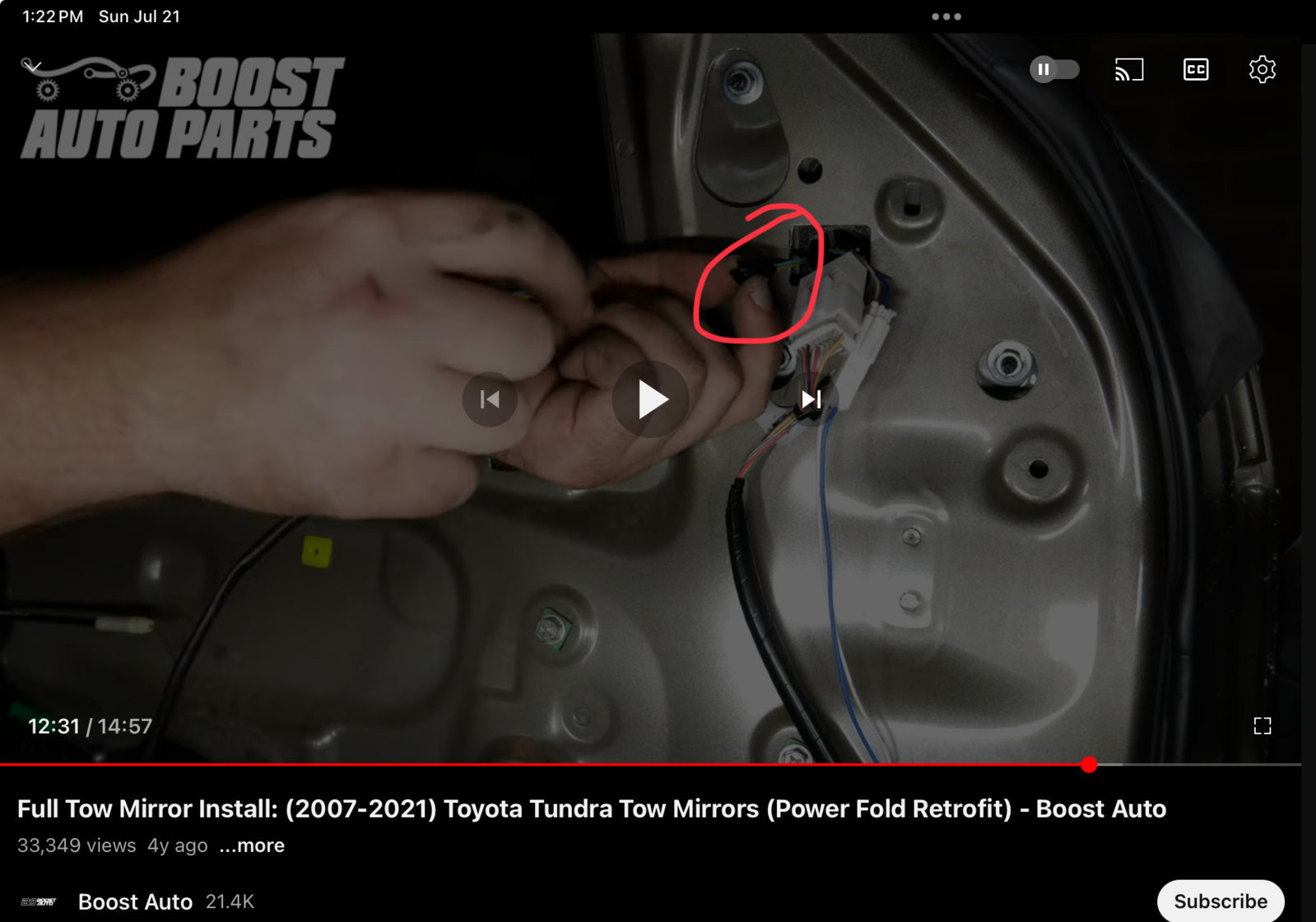

    Installing my Boost Auto mirrors with power fold upgrade. It appears that the plug for the power fold harness does not exist on the mirrors they sent me. I do not have this plug circled in red:
    Here is a pic of the PS mirror they sent me with the entire harness spread out. The red arrow is pointing to the ends of the power fold switch harness. These are supposed to plug in at the mirror. Am I missing something here?

    What is all this?
    Seems like that's where your harness would terminate vs that weird box. I didn't have that with my mirrors.
