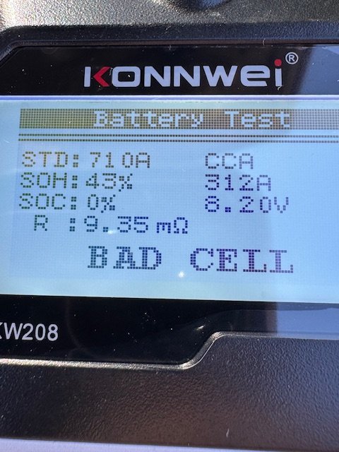

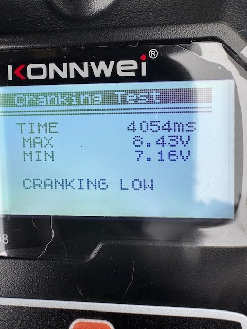

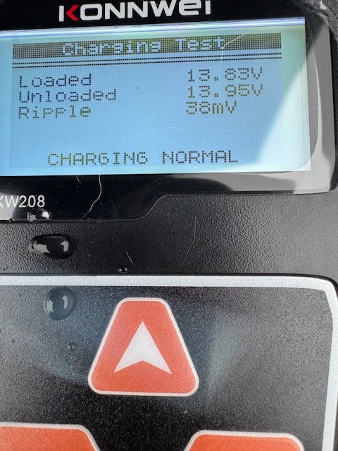

    f3ad1728-802d-464f-bac7-fc861b71d4ab_bd827c0d44b65224524d0f6d42e3f03283c810a3.png e70145b7-c9cd-46d6-9607-68413686f12d_5634b37b3bad653f1e1bf3e92ba20254d7df7442.png
    I let it sit overnight and tested the draw and it was between .25 and .30.
    The battery loses a 1/2 volt overnight whether it is disconnected or connected in the truck.
    I'm not driving it every day right now so if I don't start it every 2 days I have to jump it.
    It is still under warranty with Interstate, but the problem is they want to keep it overnight to test it.
    That is a problem for a few reasons.
    1. Because of shoulder surgery, I can't lift the battery out of or back into the truck.
    2. I have no vehicle to run to the store and back the next day if I could lift it
    3. I'm not leaving my truck in their parking lot overnight and having them pull it.
    So I'm keeping records and documenting this stuff in hopes they will swap it without the 24-hour hold.
    My cheap battery tester has helped a little.
    Amazon.com: KONNWEI KW208 12V Car Battery Tester, 100-2000 CCA Load Tester Automotive Alternator Tester Digital Auto Battery Analyzer Charging Cranking System Tester for Truck Marine Motorcycle SUV Boat : Automotive
    It has only come up once as a bad cell.
    It usually says the battery is good but it needs to be recharged.
    Cranks low after sitting all night.
    Charging system is fine.

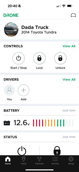

    The resting voltage of a battery cannot be measured until about two hours after any type of charging, including float charging. I suspect 12.2 is the resting voltage and you are getting the 12.6 right after shut down. Most batteries read about.3-.4 higher than resting after shutdown. It is just the nature of lead acid batteries.

    The 12.6 is after a start and 15-minute run.
    The 12.2 is in the morning as I lay in bed, looking at Drone app, not doing anything to the truck in the driveway.
