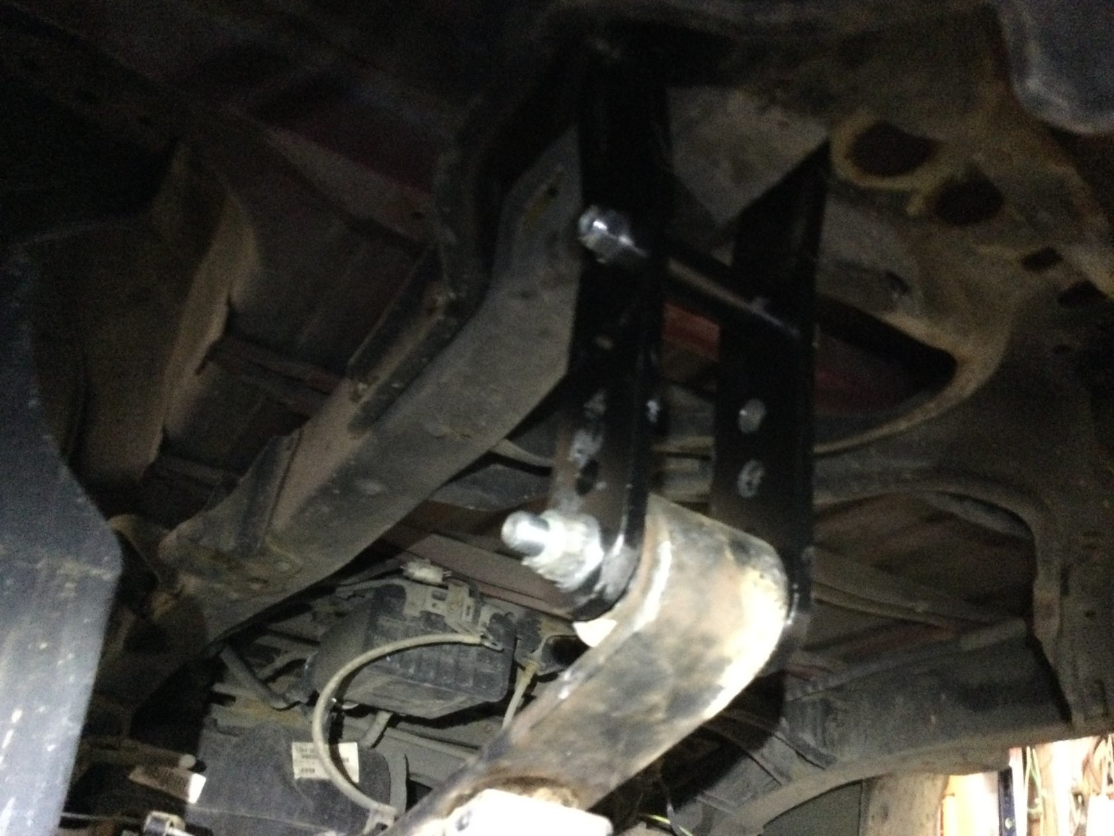

    Took a year, but today I spent 8 hrs and installed the SOS Lowering Kit and the SOS Airbag Kit. I ordered the Bilstein shocks locally. Tear down was pretty straightforward

    BTW. Pull the rear shackles first. Leave the front in until you have released the rear spring from the
    Swinging shackle. It will be easier to deal with controlling falling axles and stuff.

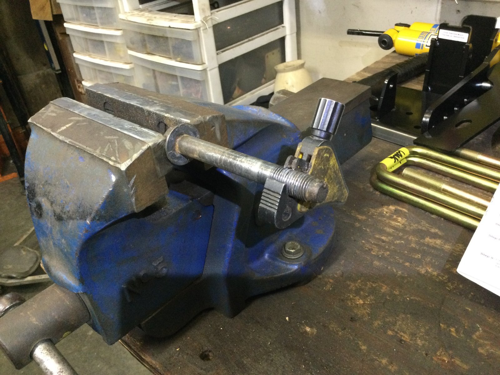

    Airbags loosely attached and the air line hole aligned roughly with the upper bracket. I was able to lift slightly on the back of the spring packs together here and pull the airbag up to attach the two bolts for the airbag to the upper bracket. Don’t worry about twisting those bags around. They are designed for the bottom of a truck, they are tough.
    NOTE: small cap screw supplied here. Notice the rear brake line and ABS sensor wire. They need to be relocated for airbag clearance. I reversed the P clip that holds the brake line and just pushed the ABS plug out and put it inside the bracket as opposed to outside. Early pics will show original position. This is a 10 min job. But provides necessary clearance of airbag to lines so no rubbing
