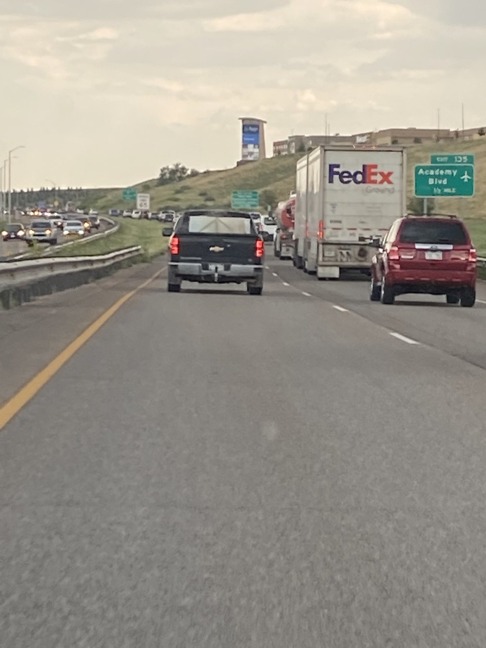

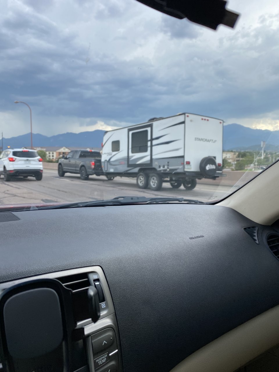

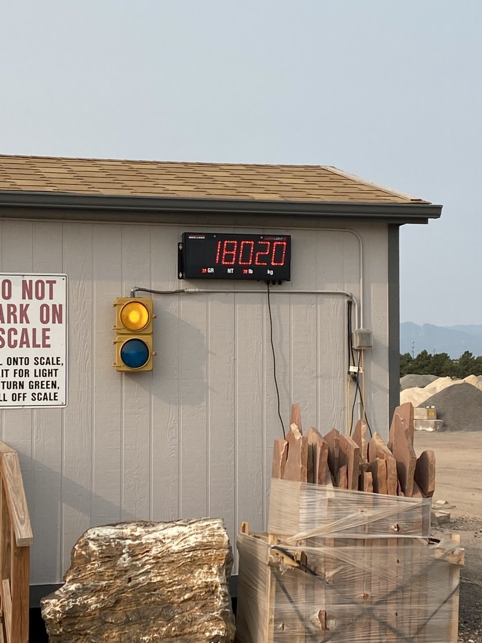

    I sure do enjoy these threads. Hell OP, I say go get it. See it all the time around here, and Colorado has some pretty tough towing. Towing in CA and GA is much different than here and probably has it's own hurdles to jump in comparison to where I tow.
    I also find it funny when people talk about "weight police." To me they have lost all credibility and the argument is over for them since they failed to prove that it is totally acceptable to go over the ratings of a piece of machinery. I would love to hear someone go into a dealership and literally show them with CAT scale slips that they were in fact over the weight ratings of the machinery and still demand warranty coverage. The service manager is going to tell you to eat a bag of dicks.
    It's not uncommon to see these shit shows on the road all the time. There were more in this group and I with that we could have been stopped to get more video of these "setups" driving on the freeway.
    So let's look at this set up. He actually had a LDH, but obviously not set up properly. Notice anything else?
    What about this guy? See any issues here in this Chevy 1500?
    I'm not going to bullshit anyone and say "I always am under my weight ratings at all times." Just last week I had to have a yard pull off material due to the weight on the scale. I wasn't totally sure since most landscaping yards I can only get my rear axle/trailer axles on the scales. I hit just a bit over 20K lbs. Would I be close or just a bit over? Most likely due to knowing my front axle is probably 4-4100 lbs. By doing some 3rd grade math on the fly, that puts me over my trucks GCWR. So we removed material until the scale was ~ 18000 lbs. Would my truck pull the extra weight? Oh hell yeah...it didn't even struggle with the 22K combined on the 5 mile drive home. Everyone has a devil on one shoulder and an angel on the other. I know better so the angel wins in most cases. Hell, both of my trailers are over the GCWR of my GMC 3500HD. 11500+16000=27500 lbs. I should have a trailer rated at no more than 14500 lbs to stay under the 26K rule. However, that is still over my GCWR of 23700 lbs.
    Well shit Chris, why do you have these trailers then? I will tell you why:
    1) Not in commerce.
    2) Trailers are built well to handle the weight.
    3) Brakes are HUGE. 12x3 1/4 shoes is a lot of braking power if I ever need it in an emergency.
    Let's talk about these SAE J2807 standards that some think is BS. All trucks are tested the same way, so I'm not sure what the controversy is on that. The vehicle being tested can either perform the tests adequately at a certain weight or weight is removed until the vehicle can pass the test.
    https://fifthwheelst.com/SAE-J2807-Tow-Tests.html
    https://www.motortrend.com/how-to/1502-sae-j2807-tow-tests-the-standard/
    So why didn't the latest Ford and GM have some heating up issues on the Ike Gauntlet Test? They are SAE J2807 rated right? Maybe the standard J2807 test is pretty good and there are definitely harder tow tests in the US for sure. I can think of CA, NM, CO, UT, MT, WY that have tougher passes than the Davis Damn.

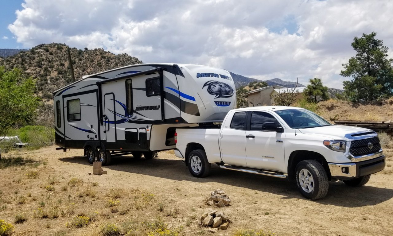

    My 5th wheel is very similar, we have an artic wolf 284 drl with a pin weight of 1465. There are 5th wheels out there that the Tundra can tow and it tows it well even here in the mountains. PM me if you want more info.
