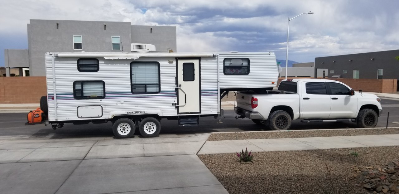

    Years ago I had a 24 ft Komfort and my crappy Z/71 pulled it fine. I don't care for 5th wheels myself anymore but you can do it just don't over do it.
