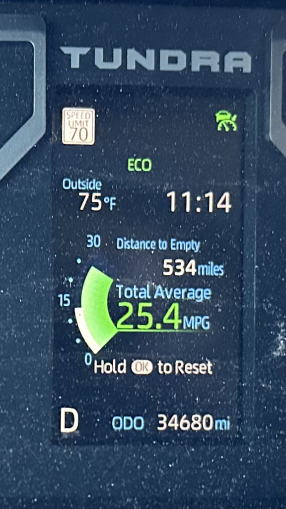

    On April 23rd, I got my Tundra back and the next day took it on a short road trip to visit a friend in Poulsbo, WA. His house is about 535 miles away so after I arrived, I did an oil change at a local dealership in Silverdale, WA. The service rep looked up my truck and asked if I knew about the engine recall. Since it was just completed the day before, we figured it was paperwork lag. He said he'll have his crew look for anything unusual like odd leaks or loose items. After the service, he reported everything looked fine. Unfortunately I had forgotten about getting the oil tested so nothing to report there.
    After that short trip, I left for a longer road trip on April 28th thru May 8th. Drove to Champaign, IL thru Utah, Wyoming, Colorado, Nebraska, and Iowa. Stayed there for a few days with plans to hop over to Indiana and Kentucky to visit the Indy 500 Museum and Louisville Slugger Museum & Factory. Sadly the timing didn't work for me on that particular weekend. Louisville had their Kentucky Derby while torrential rains and road construction projects delayed my arrival in Indianapolis to arrive 30 minutes before closing.
    Despite those plans falling thru, I did have an awesome time with my buddy, who I haven't seen in 20 years. His wife commented that it looks like we haven't hung out for a week rather than 2 decades. Despite not seeing each other in person for so long, we did keep in touch by phone, email and even the old timey hand written letter now and then. I also got to know and play with his 2 dogs, a German Shep and a Belgium Malinois. They were a bit wary at first but warmed up after giving them snacks and lots of lovin'. I used to have a Shep a long time ago so I was a very happy camper. Now I want to adopt a Shep again.
    Anyhow, my return trip home went on a southern route thru Missouri, Kansas, Colorado, and Utah. Originally I was going to drive from Denver, CO to Provo, UT thru the Rockies but a late spring/early summer storm dumped a lot of snow on the 2 routes I was looking at. I ended up going thru Wyoming to reach Utah. From Provo to home was very windy but uneventful.
    My truck now has a bit over 35K miles, 5K on the new engine. I don't have any road trips for the rest of the month so I'll take it in for another oil change and inspection next week. I'll ask the service rep about an oil analysis service and get the oil tested. As for performance, as reported before, the acceleration lag is gone and hasn't returned. What was a nice surprise was the improved gas mileage. The old engine would average 20 mpg on highways but now I was able to hit 25.4 mpg on flat lands while going 70-75 mph. In mountainous/hilly areas, it dropped to 20 mpg but still an improvement from the old 17-18 mpg. When I go on long trips I tend to use 91 or 92 octane rated gas while sticking with 87 locally.
    On a side note, a new gas station near my house has 87 rated ethanol free gas and that one gives me 22 mpg locally. I tried to do a long run with pure gas only but not all gas stations along my path carried it. I'll probably experiment with pure gas after I map out the locations of gas stations that carry pure gas at a later time.
