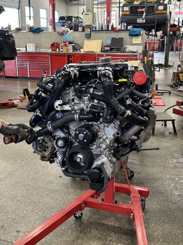

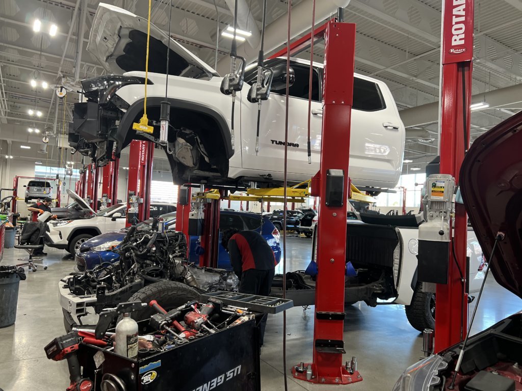

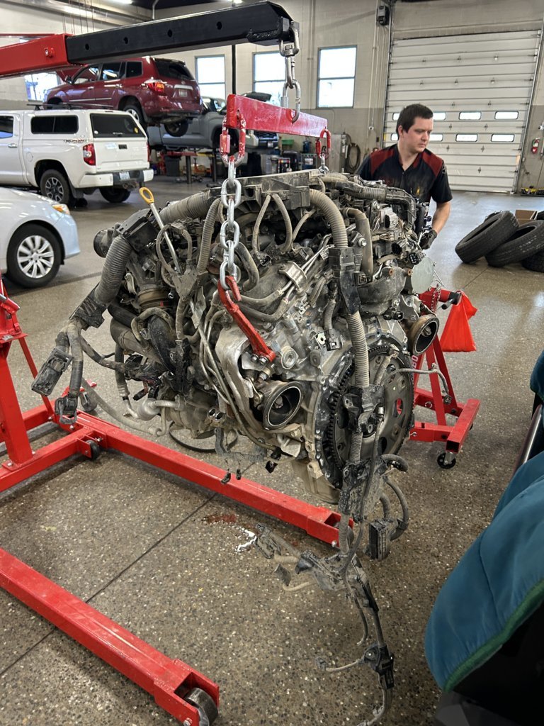

    Well considering I watched them pull and place my engine, if they are familiar with the concept it’s pretty simple. The new engine comes full of oil, ready for the turbos to be connected, and the AC compressor/alternator/wiring harness to be swapped over. If the dealership says 6 hours and gets it done in that timeframe I don’t think that warrants a red flag that the work wasn’t carefully or done correctly.
    Now I did take donuts in for my techs! :)
