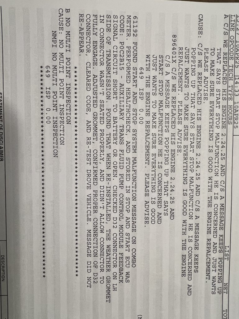

    I had been having a code pop up about Start/Stop malfunction. The auto start stop didn’t work, which was nice, but the message was super annoying. I finally got time to take it back. Turns out a connector was a little loose from the swap. Fixed for free. Checked out some new Tacomas, 4 Runners, and LandCruiser 250’s. Tacoma back seat is kind of pointless. The 4Runner and 250 are on point though.

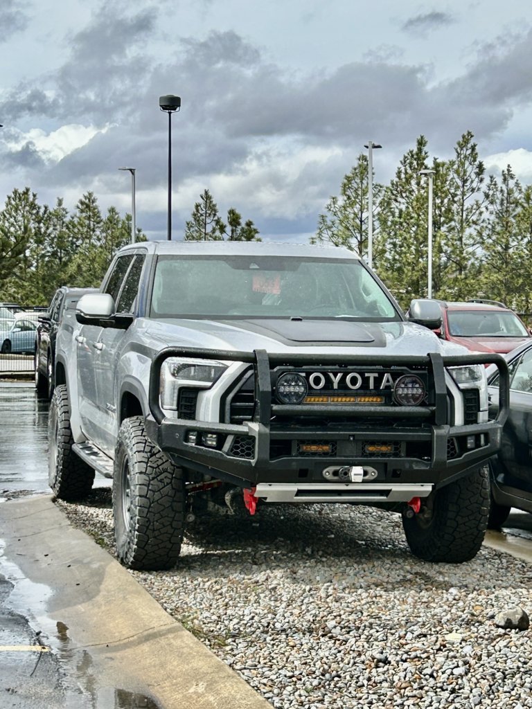

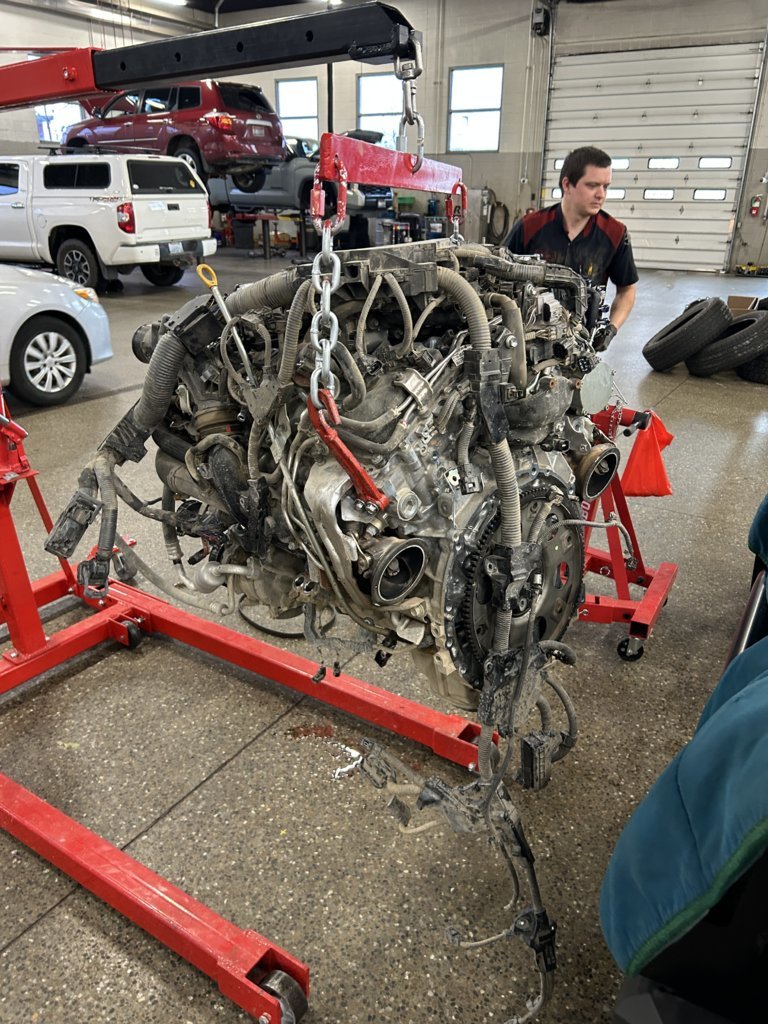

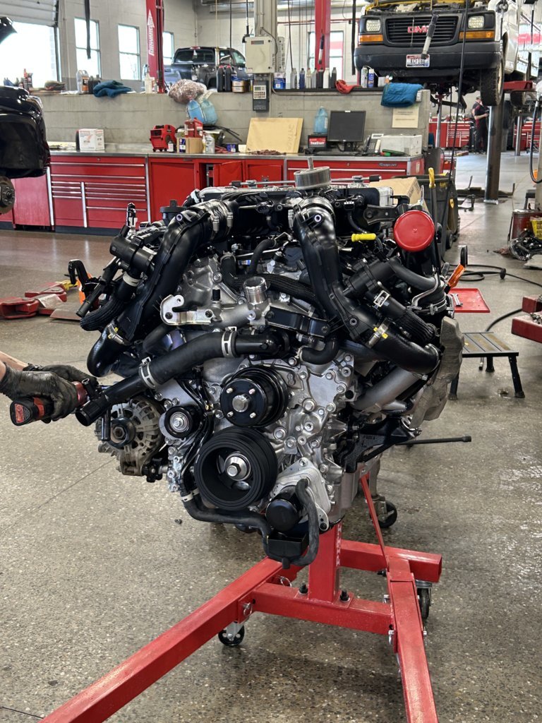

    2022 with 51k no problems till finally a wastegate on the turbo got stuck in the closed position. But they weren’t going to fix a turbo so they ordered an engine which took 6 days to come. Parker Toyota in North Idaho gave me a free loaner for the week and I put 1776 miles on a 2025 Tacoma. I drive a lot. Haha
    They took my hood off and even with my bumper picked it up right up and out no problem. They said cab off is the hassle way to do it and they can get it done in 6 hours. And sure enough they did. Engine runs great, no issues, one signature at the end. I made some Instagram posts about it as well. They reuse the AC compressor, wiring harness, and alternator. My tech was a cool guy and I hung out and watched for a chunk of time. They’ve done about 60 so far. I have about 250 miles on the new engine and coolant levels are fine.
    https://www.instagram.com/reel/DH39uycSTs-/
    https://www.instagram.com/reel/DH6xhCUzfVN/
