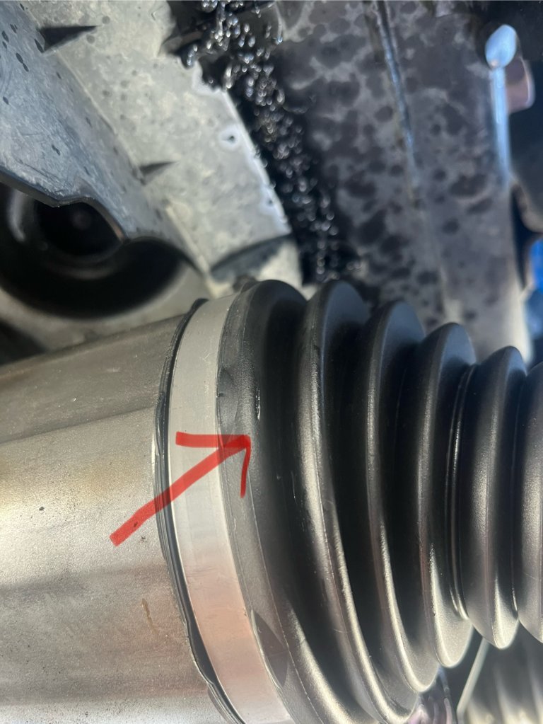

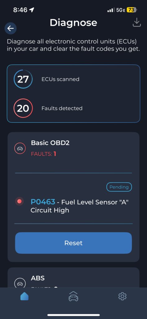

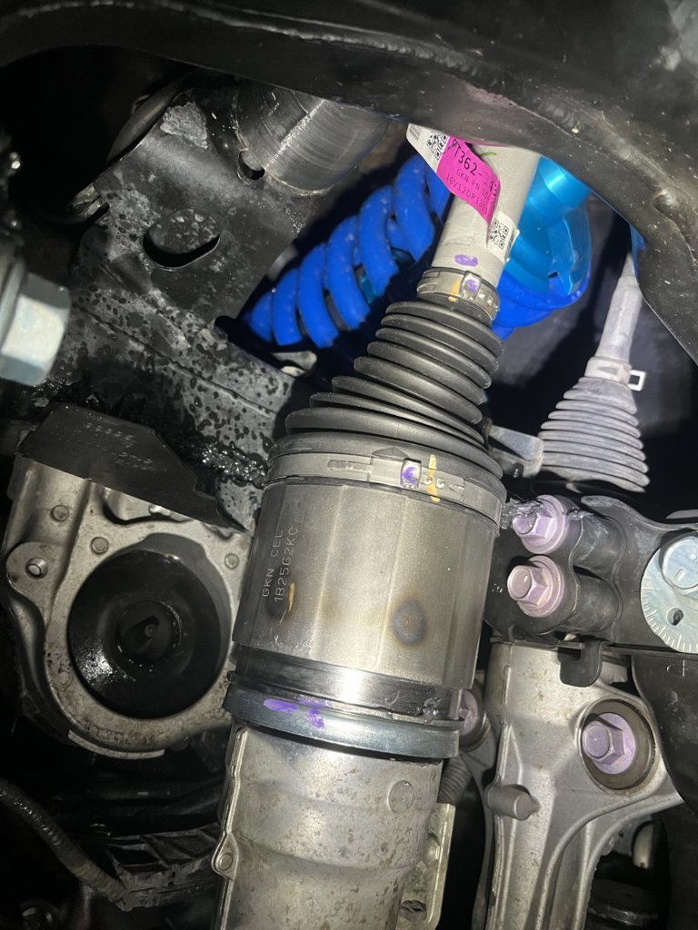

    • Well, here’s where it gets fun. I first drove my truck home, checked all over for any leaks, loose connectors. Couldn’t find anything. Then, (admittedly this is a dumb fucking idea after getting an engine swapped), I drove out to the desert. Quick two and a half hour drive. Enjoying having my truck back. Then, I hit a dip in the road going about 45 through borrego springs, which is the speed limit through there. I’ve hit that dip many times before doing 50+ “for testing purposes”. Never had any problems. But, this time, my gas immediately goes to empty and my truck starts saying to refuel now. I pull over, turn the truck off, look underneath. Gas tank is still there! Great. Peaked at the connectors on the gas tank. All seem to be good. Pull out my Carista to scan for any codes and got this:
    so on top off the fuel level sensor fault, they never cleared any codes during the engine swap I guess? The others were mostly communication faults to just about everything on the truck that got disconnected during the cab off. I’m not gonna jump to any conclusions or say how awful this is bc I could be wrong about the codes. Would love for any input on that. My guess is a loose connector on the fuel sender. But yeah, made it out to the desert fine, fuel gauge eventually came back, and tomorrow my service advisor is gonna get a fun call from me! In hindsight, should’ve listened to @DADKILL n went up to RSM Toyota. Ya live and ya learn. Probably won’t be going back to capo valley now (other than having them go through the fuel connections again on Monday). Mistakes happen. I’m safe. Truck still runs great. Just happy to have my truck back :)
    update: I think they also punctured my brand new cv axle lol

    Update: dealer found the loose connection on the gas tank. Fixed that. Both the axle boot and the silver passenger side axle are on back order. Dealer ordered both and will install whatever comes first.

    #104738
    136
    How on earth did you spot that? Was grease seeping out?

    Looks like the grease from it is caked right above it in the photo.

    :thumbsup: Tunnel vision, was just looking at the small crack.

    Yup, as Tucson noted, it’s sprayed cv grease everywhere. There was a bubble of grease on the cut but I wiped it off for a pic. Just got a text that a part came in so either the new boot or new cv came in today - much better than the 9 day wait I had to go through to get an oil seal. upload_2025-3-25_14-8-9.jpg
