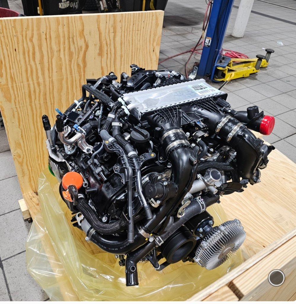

    Trying to attached the picture but my internet isn’t the greatest. But the engine is in and all the gaskets to seal up all the connections are still from the old one was what I got told.

    They should have had your gaskets when the engine came in...
    Tomorrow will be a week with my new engine, everything is going great. The pic is from this morning when I had 675 miles on it, has 800 tonight. The 1k oil change i will do Friday along with the diff's and transfer case (basically a new truck with 88k on it!). This new engine definitely gets better fuel mileage than the original engine, I was lucky to get today's kind of mileage with summer blend fuel before...

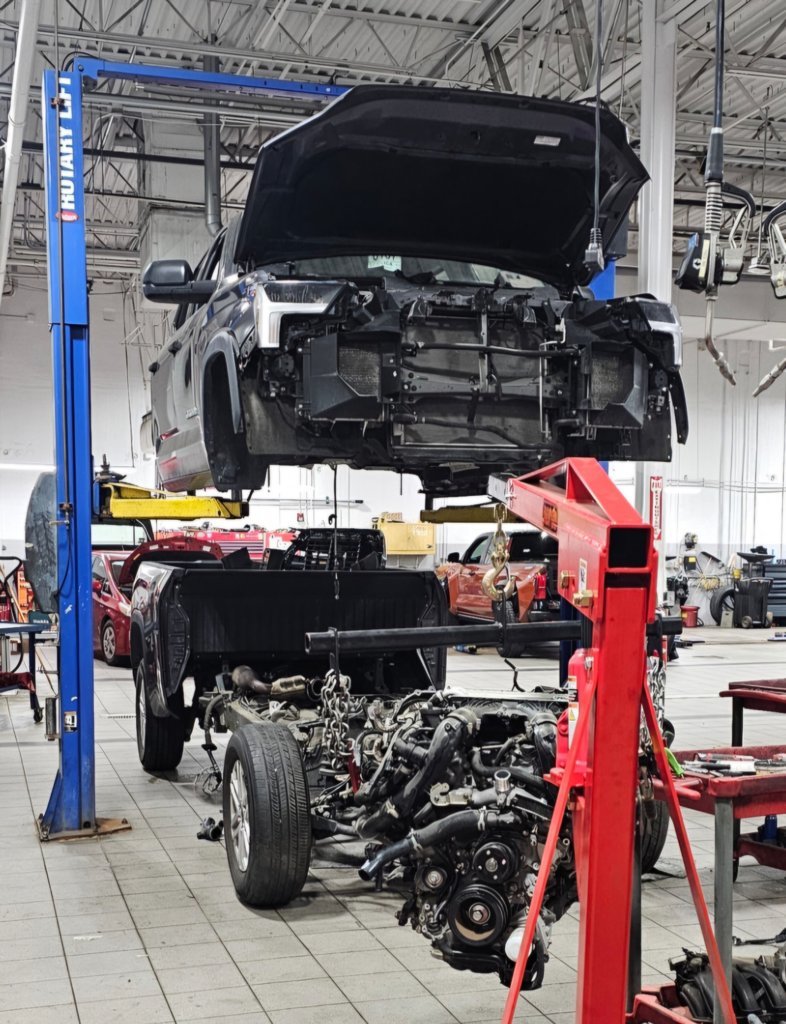

    It's actually a complete engine & not just a long block.
    Cab off is the best way of getting the job done, 10-12 hr job.
    We have done at least 35 & have a few more engines waiting for the truck to be dropped off.

    Northern Illinois
    interesting, so you guys don't follow the motherships guide 100% just find what works for you guys type deal?
    cab off always looks worse than it is I think, but I would be concerned with new rattles, etc vs just popping off the hood

    I can't imagine the cab off approach being easier than the cab-on videos that are floating around.
    But, after 35 engine swaps, I'm sure the techs have found what works best for them.

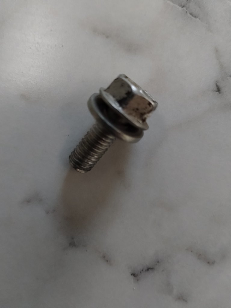

    So yesterday I changed the oil on the new engine (changed fluid in both diff's and transfer case as well) . As I was wrapping up I thought I might as well clean the TRD air filters so the truck would be 100% on all maintenance. I was surprised to see a 10 mm bolt stuck in the pleats of the filter. Not too happy but if that's all I could find after going thru the truck from top to bottom I will take it. Side note, new engine is getting summer mpg on the winter blend fuel, hope it stays that way!

    Dang, that would drive my OCD nature crazy wondering where that bolt goes.
    Glad the new engine is working out for you.
