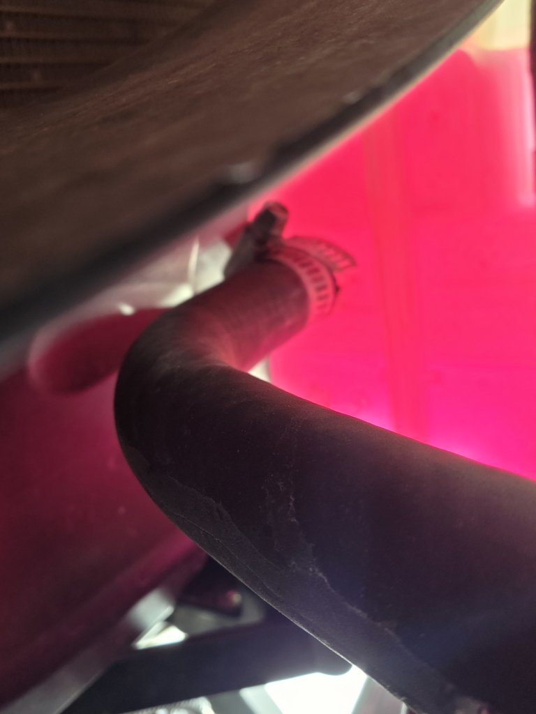

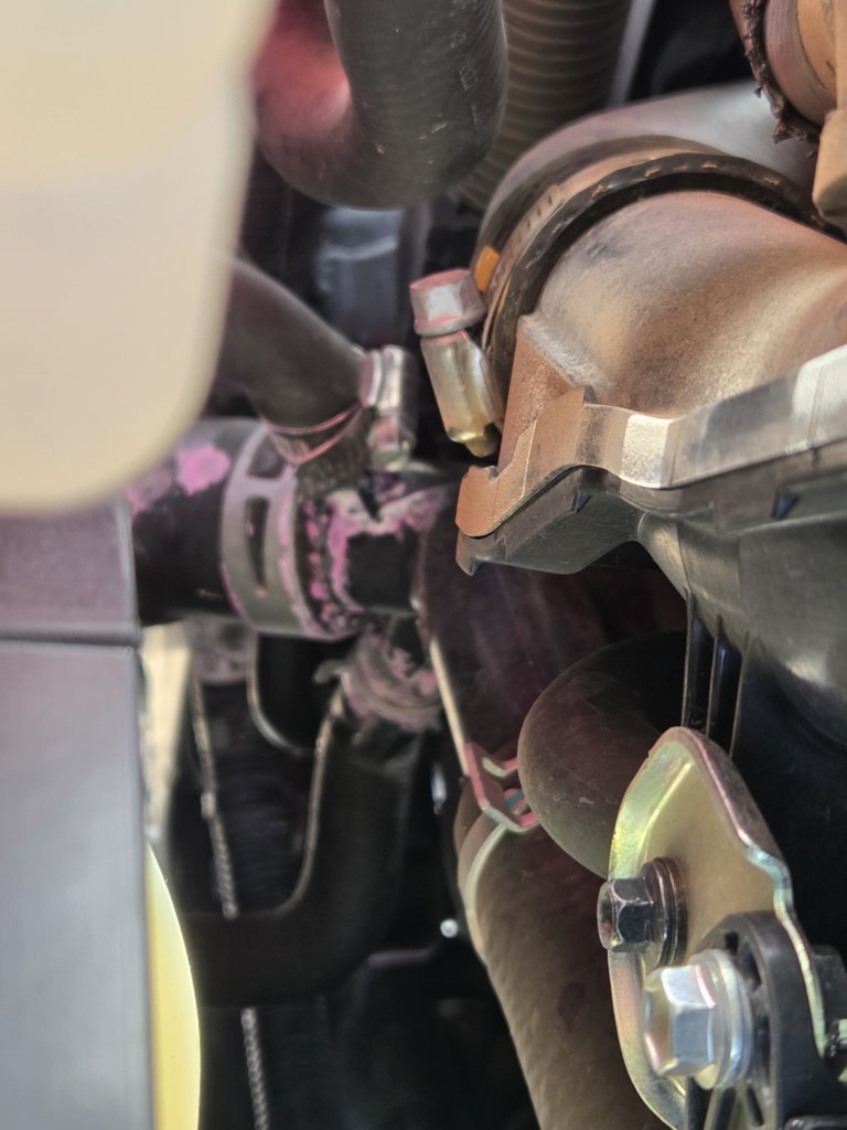

    Well, after looking again today after this week's trip I was looking at the truck again and they didn't fix the seepage that I had on the engine side of the coolant system. The hose clamp was slightly loose. I guess I will replace the hose and both clamps.

    Those are not OEM clamps. Unacceptable

    I'm guessing they ran out of factory clamps and just went to local ace hardware across the street for something similar?
    Maybe half a turn on the screwdriver would stop the leak?

    Yeah, we told him those weren't factory clamps when he first discovered a leak after his engine replacement. Apparently he never did anything about it.
    Manufactures haven't used those worthless worm gear hose clamps for decades.

    Um why not use the ones that were there? I usually just slide the clamp back onto the hose when removing the hose and when it's put back in place, I slide it forward. Absolutely no reason to lose the clamps. Looks like a tight area so maybe the tech found it easier to use the worm screw clamps. The flexible tool you use to deal with these clamps should be in EVERY Toyota technicians tool box. As the guy said below, those worm screw clamps suck.

    I wonder if the plastic neck is cracked and leaking and the worm clamp was used as an attempt to stop the leak

    I thought this too as it looks like the infamous "cracked coolant pipe" on the back of the 3rd gen Tacomas. Guys got three worm screw clamps on in different places so maybe the tech was chucking clamps at it. Definitely worth looking into

    Both ends of that hose have the worm drive clamp. I got a good 1/2=3/4 turn on the clamp but will replace the hose and clamps.
