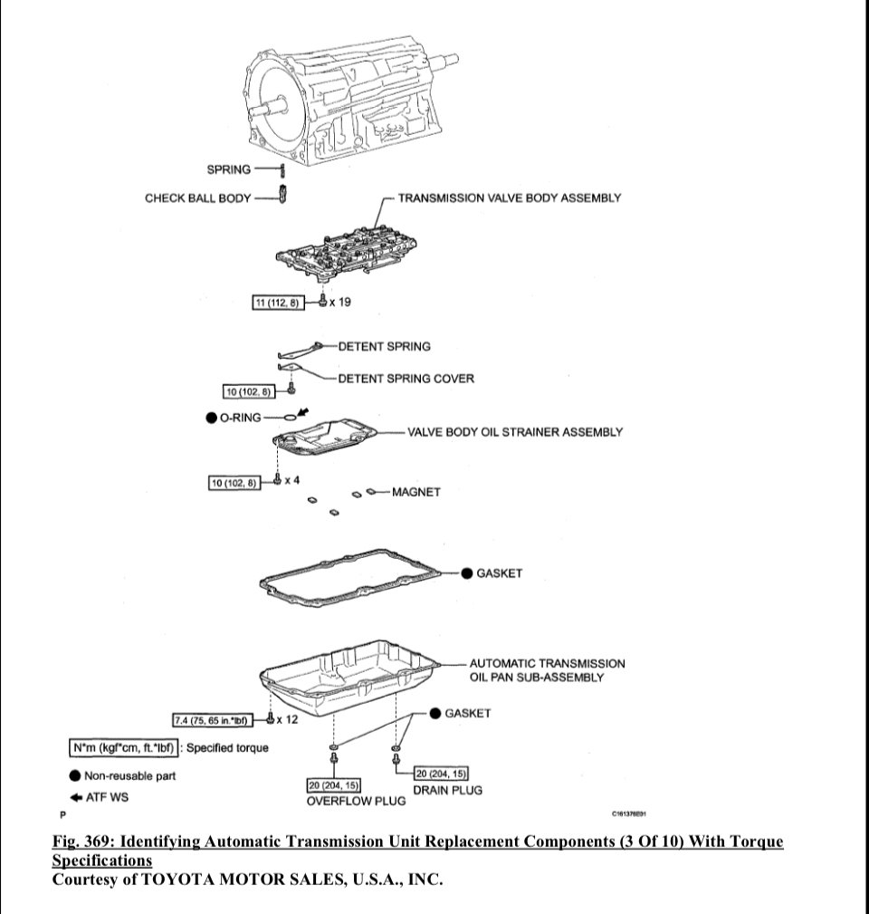

    If it does not have a factory cooler then there will not be any external lines with transmission fluid. I would double check to make sure that it does not have the cooler attachment behind the puck like timsp8’s picture.
    Also, you do know that the transmission pan two things that look like drain plugs. An actual plug to drain the fluid and also a plug that covers the standpipe for measuring fluid level. Just making sure.
    If you did pull the drain plug and got no fluid I would put enough fluid in it to get the fluid level high enough to start dribbling out the standpipe plug before I tried to run it again.

    Thanks guys...I VERY much appreciate the input and expertise. I definitely pulled the actual 'drain plug' and got nothing, I actually had some trouble breaking loose the overflow plug(from the diagram above)...but I think I'm going to do as suggested by most above and add fluid until it comes out of the overflow (after looking for any obvious leak areas).....I'm just kinda stumped at this point where the fluid could have all leaked out from. I would think with that much fluid, there would have been some signs. I'll report back after checking it over and refilling. Thanks again!:thumbsup:

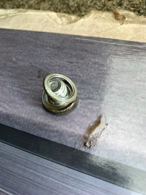

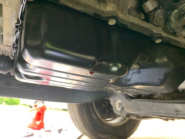

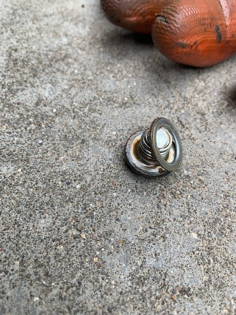

    Report!....good news/bad news as it seems to be the theme with this truck. Good news first: I FOUND the leak! Bad news: the $!#$-hole that stole the catalytic converters and cut the brake lines...also knicked the transmission pan. I saw it when I first started looking around today, but it didn't seem to go all the way through the pan....so, I added about a quart of fluid and then saw the drip (see pics). I also had a question about the seal/gaskets for the 3 bolts. I'll also include pictures of those. Per the Carfax, the transmission fluid was changed about 30K miles ago....wondering if they didn't replace the seals/gaskets.
    Maybe I should start a GoFundme page since every unexpected problem I've run into is because of a "rookie catalytic converter thief"....usually these guys are surgical...this guy made a bigger MESS than just taking the cats. OMG!!!!

    Sorry...first pic is the leak location on the pan, 2nd pic is the drain plug bolt/gasket, 3rd pic is the overflow bolt/gasket, 4th pic is the fill bolt/gasket (which is the only one that has a rubber seal....I thought they all were supposed to have a rubber seal too??)

    Pretty sure those are all correct. Does it go into gear now? Personally id use some JB Weld or some other cowboy method of stopping the leak until you figure out if this thing is worth saving.

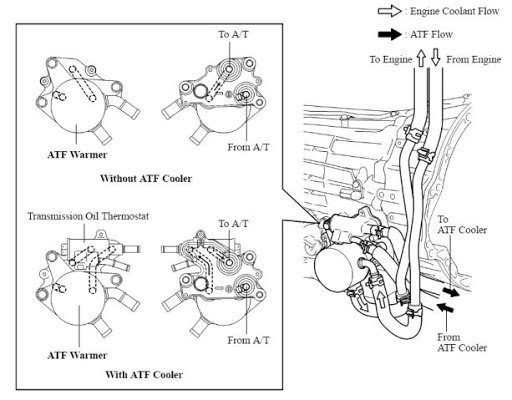

    Been awhile since I crawled under there, but it seems logical you can just run a hose from the pan back to the pan and completely bypass the entire cooling loop so it's just pumping fluid back into itself. Then fill it up and see if it works.

    Your seals look correct. I agree with what has been said. I would figure out something to seal the pan (JB weld, RTV, etc) so you can see if it goes into gear before I found a more permanent fix. I can't really tell from the picture but if it is as small as it sounds like it is I would drain it, clean it really good and TIG weld it. You could always do that later too.
    The good thing is I would imagine that once you get fluid in it the transmission will shift fine.

    JLS in Wa - Since the fluid is basically leaking as fast I can put it in, I'm not sure if it will go into gear with some fluid in it.....but, I like your idea of a 'temporary fix' until I can be SURE the transmission is good before investing anymore. Thanks!!
    Snivilous - I assume you are referring to if I had a transmission cooler, then route the lines back to itself...correct? otherwise, I'm not sure what you mean. Thanks!
    huntertn - the knick is just that a VERY TINY knick (like I said, it was so small that I didn't even think it went all the way thru the pan...I couldn't believe it was leaking from it. But I also agree that I think I will figure a pretty good 'temporary fix for the tiny hole' and fill and see if the tranny works before I invest anymore.....Thanks again for all your help/suggestions. I will report back soon. i'll have to let the quart I put in leak out and clean and seal the hole.

    Sorry misread what was knicked, I thought it was one of the cooler lines. Agreed with everyone else, JB weld (or honestly even just duct tape it) and run it.

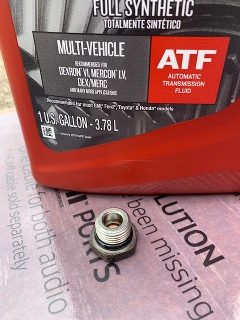

    Is that fluid in that last pic there what you are trying to put in? That's a multi vehicle Dex/Merc style that is not the same as the Toyota WS that (I believe) is recommended for your 07.

    NickB - yes, it is Valvoline Max Life. This supposedly meets the WS requirements for Toyota (per the label, and several others suggested it since I wasn't even sure the transmission was any good) if things work out.....I will probably drain and refill with WS. but it does say that it is an appropriate substitute for Toyota WS.

    Cool. Just wanted to be sure.

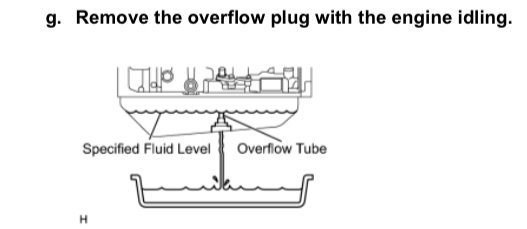

    I would put enough fluid in it to get it to run out the check hole. Start it. Shift through the gears. Shut it off. Refill until it runs out the check hole again. That would be a good place to start.

    Thanks! That sounds like a good idea. That might be safer than just 'going for it'. I appreciate the suggestions!

    I've GOT transmission!! Yesterday, I opened the "check hole" and fluid came out, so I started it up and ran it through the gears....I could feel some pull that I hadn't before, so that is GOOD....so today, I reopened the 'check hole' and no fluid came out, so I left it open and filled it again until it came out and then closed it up. I started it and it definitely felt MUCH better and moved the truck 'normally'.....of course I won't know for sure the fluid level until I can get the radiator in and warm it up to correct temperate and re-check via the 'proper method'....but, I feel much more comfortable putting more money it in now that it runs and "drives".....I appreciate the help I've gotten here so far and look forward to giving more updates on the progress. Thanks!!
