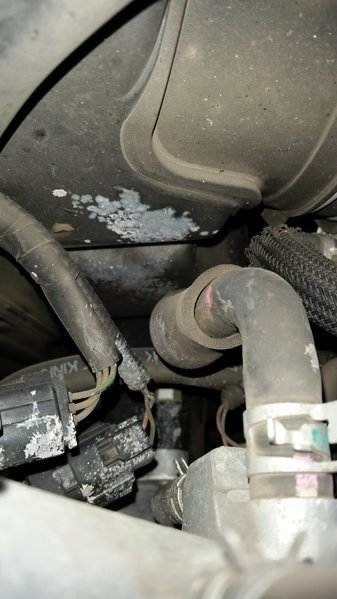

    Today I was looking around at his engine (05 4.0L v6) and I think I found a coolant leak. I'm pretty stumped on where the hell it's coming from. I only could get one good photo of it posted below.. I attached it to the thread as well, incase the pictures posted don't work for everyone.
    so this is pretty much what I found. there was a few spots on top but nothing showing a visible path running down. It looked like it was mainly coming from this area and it was running down in paths on the front of the engine block.
    there's no puddles or drips below his car where he parks it every day.

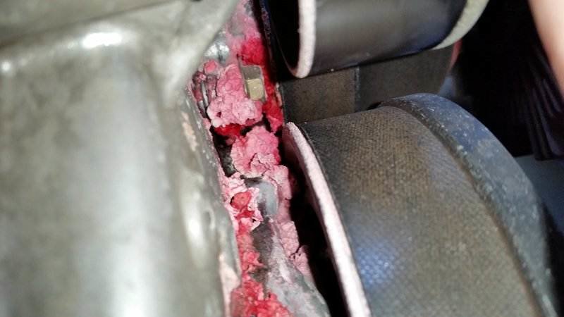

    here is what we noticed higher up the engine, we were looking for any paths running down.
    we couldn't pin point a location any of this was coming from. it looked like the fan or highway driving was blowing it around over here. there was random drips that were pink but nothing showing an actual leak.

    My guess is water pump

    Yeah I found a few threads with the same waterpump leaks. after I posted this

    When I changed my water pump I had the same thing.

    Sohc 1GR? It’s most likely the water pump, they were known to have water pump failures as well as headgasket issues. Other than that normal maintenance and they work great
