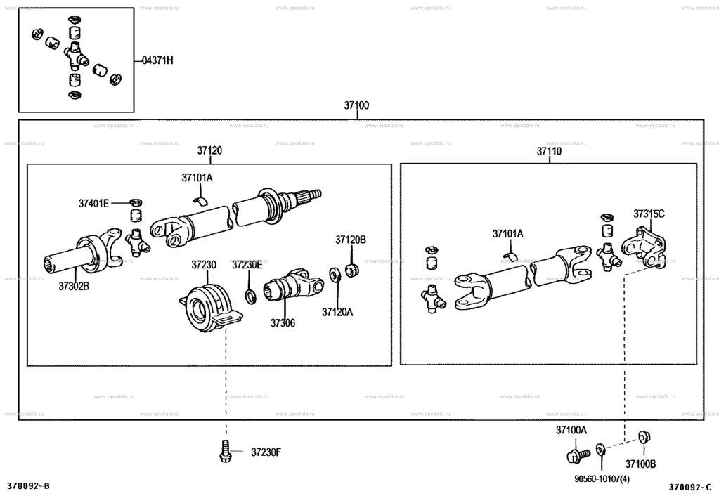

    06' Tundra SR5 Double Cab rwd
    Ya'll...that fucking diagram shit is absolutely ridiculous! good God almighty! Ok, I'll check it out! Thanks!

    I have no experience with Carpenters and I don’t know Benji Carpenter but he seems to get good reviews. Obvious he’s more convenient than driving an hour. Go talk to him about LBJs and why you want OEM only. See what he says. If he agrees good. If not, run.
    carrier bearing. Several threads on that. Dana Spicer make the OEM carrier bearing. They have a couple different ones you’ll see for 2000-2006 Tundra. One is for 4WD and the other is for 2WD. The only difference AFAIK is the 4WD version has a seal on both sides of the bearing to prevent water and dirt from entering when off road. I think they are interchangeable for our trucks. The Dana Spicer bearing should be about half the cost of the Toyota part even though they are the exact same.

    2018 SR-5 CM 5.7, 2000 SR-5 AC 4.7L
    PS - those diagrams on the EPC site are the only way to 100% ensure you get the correct part numbers for replacement parts. Any other source should be verified.

    06DC2wd
    So far Toyodiy.com hasn't failed me. Just Plug in your vin and off you go.
    Alright, I give up...I have the part for the carrier bearing or center bearing (whatever it's supposed to be called) from the diagram...and I've got dana pulled up, but out of the 4 they say fit my truck...none of them match the part number or even the year! I can not figure it out and they don't offer any option to contact customer support or anything. Can someone help please? And I've got the lbj's on the way, whoop whoop! Lol! No, still haven't cleaned off the cross member...honestly I don't know what to use either...brake cleaner? Oven cleaner? Lol!
    OK, had to delete that last post cause when I typed in the part number from the diagram shared, it keeps coming back as a Tacoma...on the dana website and when I plug it into Google...wtf? I'm just gonna call Toyota, this is giving me a headache. Sorry ya'll
