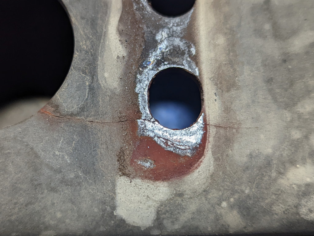

    OP, here's an image of what to look for that may very well be the cause of your popping sound considering all the components you've already replaced. Look closely and you'll see the fine cracks in the center of the old cross member in the image.

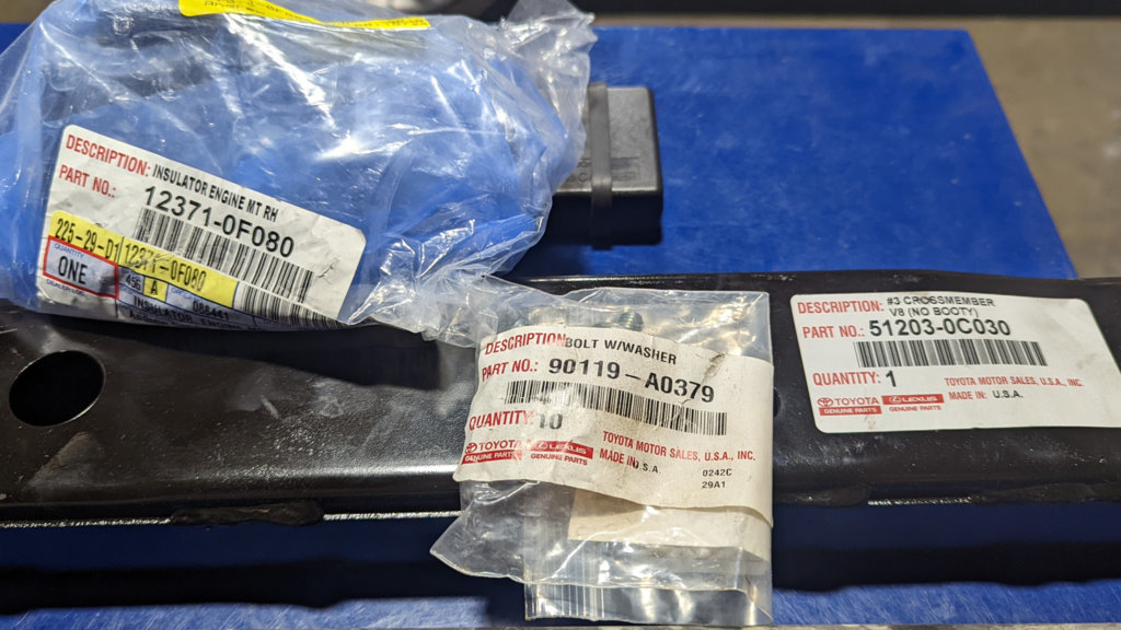

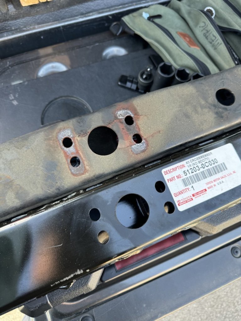

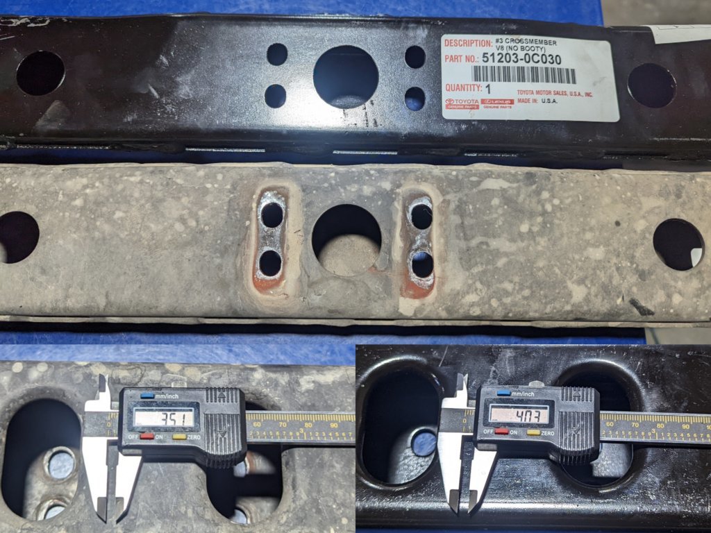

    I just replaced mine not too long ago.
    Hairline crack:
    Parts (bolts x4, not 10 as shown on bag):
    Measurements showing newer crossmember is thicker, despite same part #:

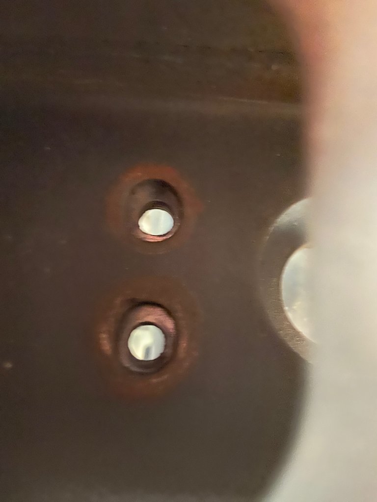

    Well, I also have that clunking. Thought I might as well take a look. At least there does not appear to be any cracks. Who needs all four bolts anyway?
    Seriously, guess what I am doing tomorrow. Already went to dealer to get bolts. Replacing the sole survivor too.

    I could not see any cracks, so didn't want to drop $200+ on a crossmember and $90 on a HF transmission jack (on sale right now) if I did not need to. Also ordered the 243 blue loctite as it appears to be better suited for that size of bolt. As it is basically a 10 minute job, I'll give the bolts a shot first. I'll mark them too to monitor movement.
    If the problem persists, then I will pay the money. Now, if it was a 4 hour job, I'd do the crossmember anyway.

    Replaced the 3 missing bolts (as well as the sole surviving bolt as who knows how that handled doing the work of 4). Clunk GONE!!

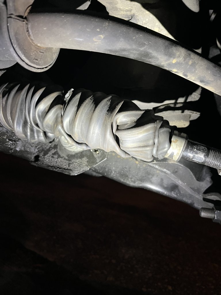

    That boot looks like someone rotated the outer tie rods to do an alignment without holding the inner tier rod in place.
