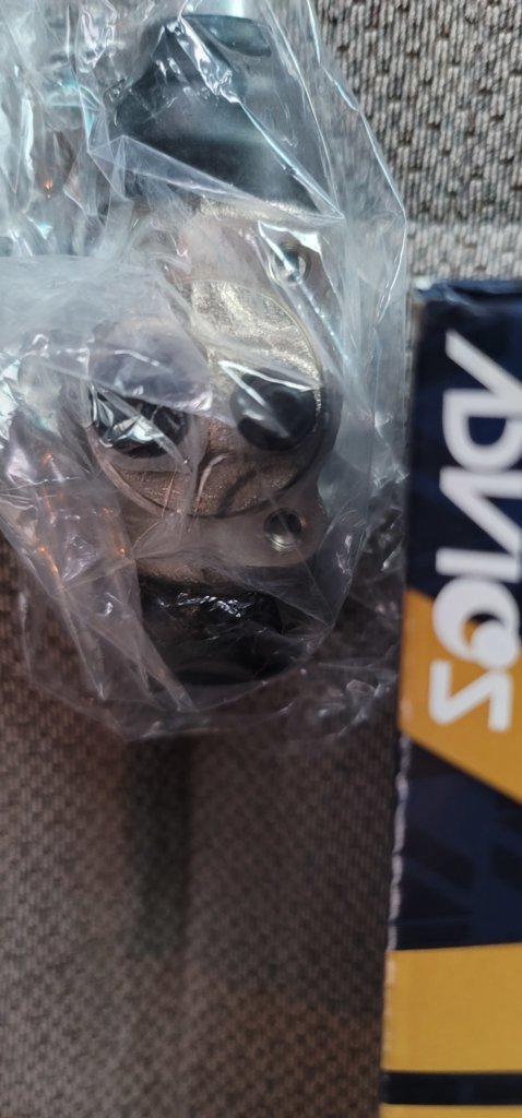

    Got my wheel cylinders in and plan on installing and bleeding this weekend. I was originally going to just do the old 2 person bleed method by either pressing half way or putting a board under the pedal, but saw your post
    The biggest mistake people make with these trucks, other than improperly adjusting the rears - which is often a major source of braking issues and shitty pedal feel - is trying to 'classic' bleed these trucks, i.e. pumping the pedal. They push all the way to the floor and blow out seals, or don't get air out.
    Ideal way to bleed these truck is using positive pressure at the MC reservoir. 2nd best way to bleed is hand vacuum at the bleeder.
    It is highly likely you still have air somewhere in the system. If so, you're not going to get it out using old school pedal bleeding. If you were able, I'd be shocked.
    Do you mind please explaining the positive pressure at master cylinder method? I'd rather give this a go if it is the ideal way.

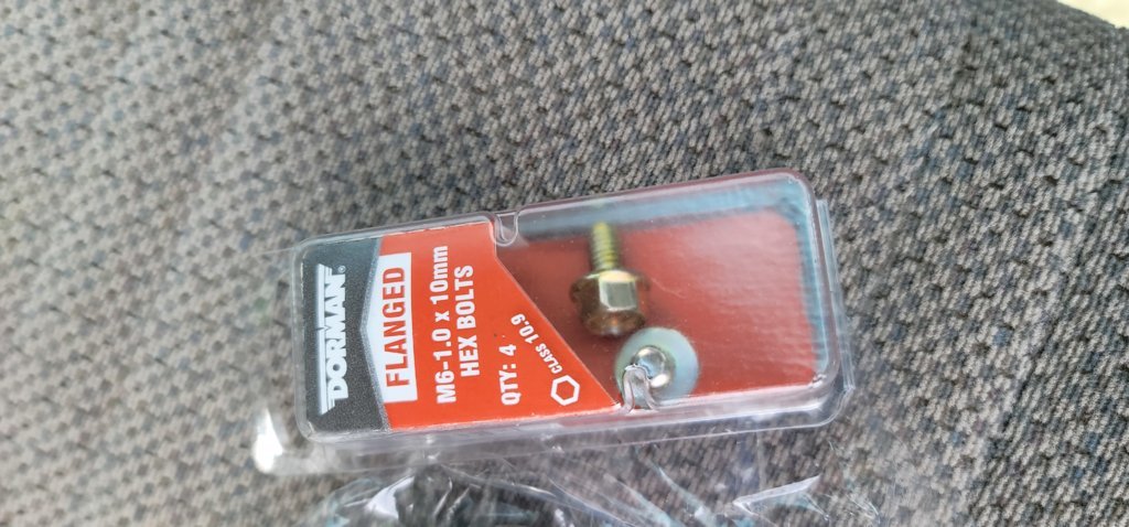

    Does anyone know the bolt size for mounting the wheel cylinder to the backing plate? I'm anticipating the bolts being rusted and probably snapping when trying to remove since this has happened a couple times already on other parts. I'm assuming m8 of some type?

    Believe they are M6, though it'd be pretty easy to bring those to a hardware store and find a bolt that fits, just have to make sure the length is right.

    You're right, it's a m6 1.0 10mm. If looking up by part number its 90119-06084. My home depot didnt have that size so ended up just getting this dorman pack from carquest
