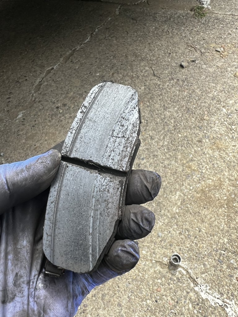

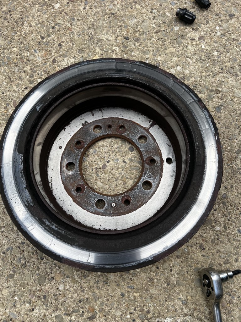

    So just a brief update. The popping sounds which coincidentally began the exact same time as I installed the RAS were found to be related to rear brake pads that basically became one with my rotors. Every morning when I pulled out I heard the sound of the pads releasing from the rotors. Crazy how a completely unrelated thing can come up just as I installed a mod.

    Strange coincidence, but at least the mystery is solved.
