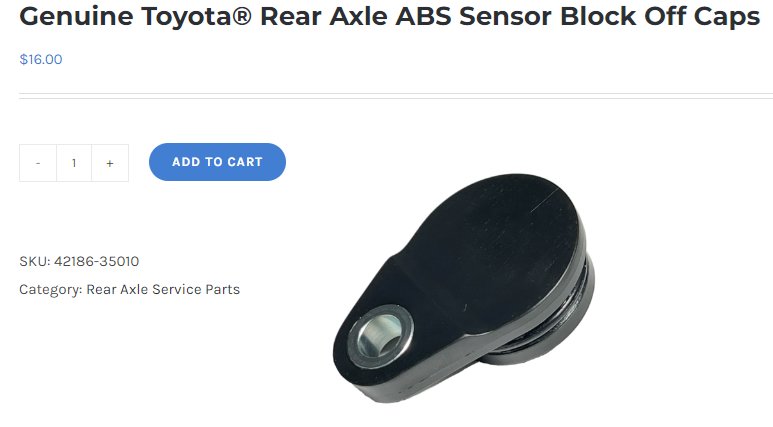

    I would contact a company like Yotamasters, who sells delete plugs for T4Rs and Tacos. See if this is compatible for the 1st Gen tundra and let us know. b/c it's been asked before and I don't recall an answer. But I also can't imagine the sensor is radically different for these years. And if it is, maybe they have a part for it.
    https://www.yotamasters.com/shop/ax...e-toyota-rear-axle-abs-sensor-block-off-caps/

    Nice, but at $16 plus tax and shipping, it's more than an Amazon sensor. I'll reach out to them to see if they have a solution.

    It's true, but I feel like it's a cleaner solution! There may be cheaper products out there searching for "ABS sensor caps" on fleabay or scamazon.

    Eh, it's a 320K mile work horse. I'll trim the wires at the sensor and call it a day. :D
