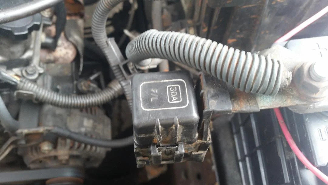

    Hi everyone.
    I need help identifying a cable. I removed the battery on my 1st gen to replace with new batt and new alternator. It was a few days ago and now I cannot remember what goes where...
    Ok, I know the battery (-) and the (+) locations.:)
    However....
    I do not remember how many cables are part of the (+) cables. The terminals were taken apart to clean off corrosion.
    There's one that I cannot remember. Its an assembly that has a 30A fuse and reads F/L on the top.
    Does this go together with the 2 other cables attached to the (+) battery terminal.
    Its a 2001 4.7, Limited 4x4
    Thank you

    that goes to pos terminal of batt and believe it’s trailer light fuse
    as a side for your future ref….any wire that has a fuse will lead to a pos termination point somewhere

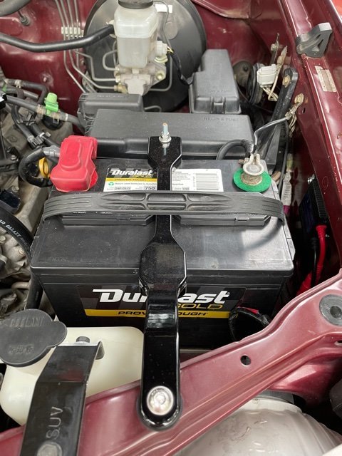

    another favor...could you post a photo of how these 3 wires get "assembled". As you stated, it goes to (+), but just want to make sure it looks factory and not like a hack job stereo amp cable spliced into the terminal.
    Thank you once again.

    Worked out great. She started right up. Thank you very much!
