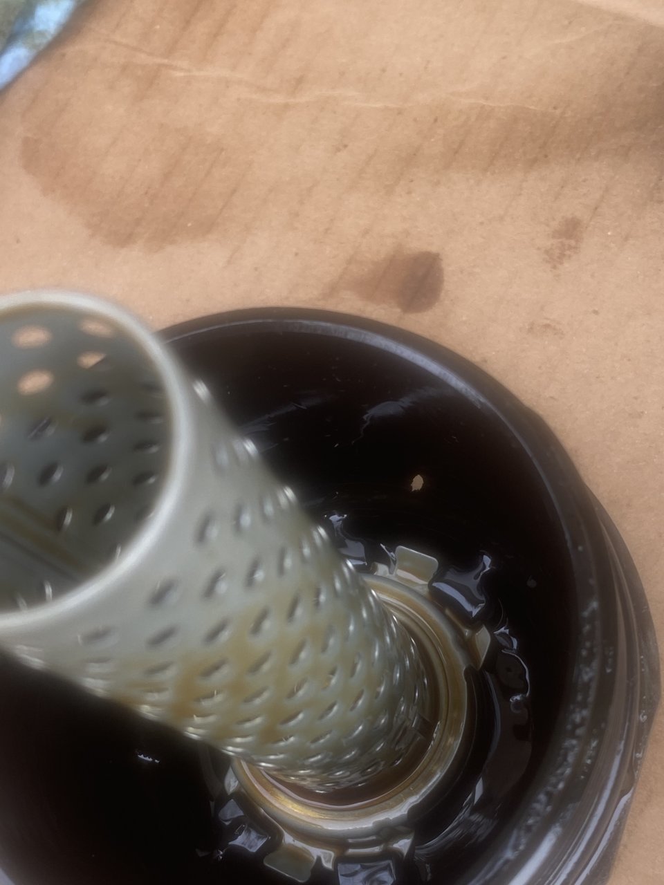

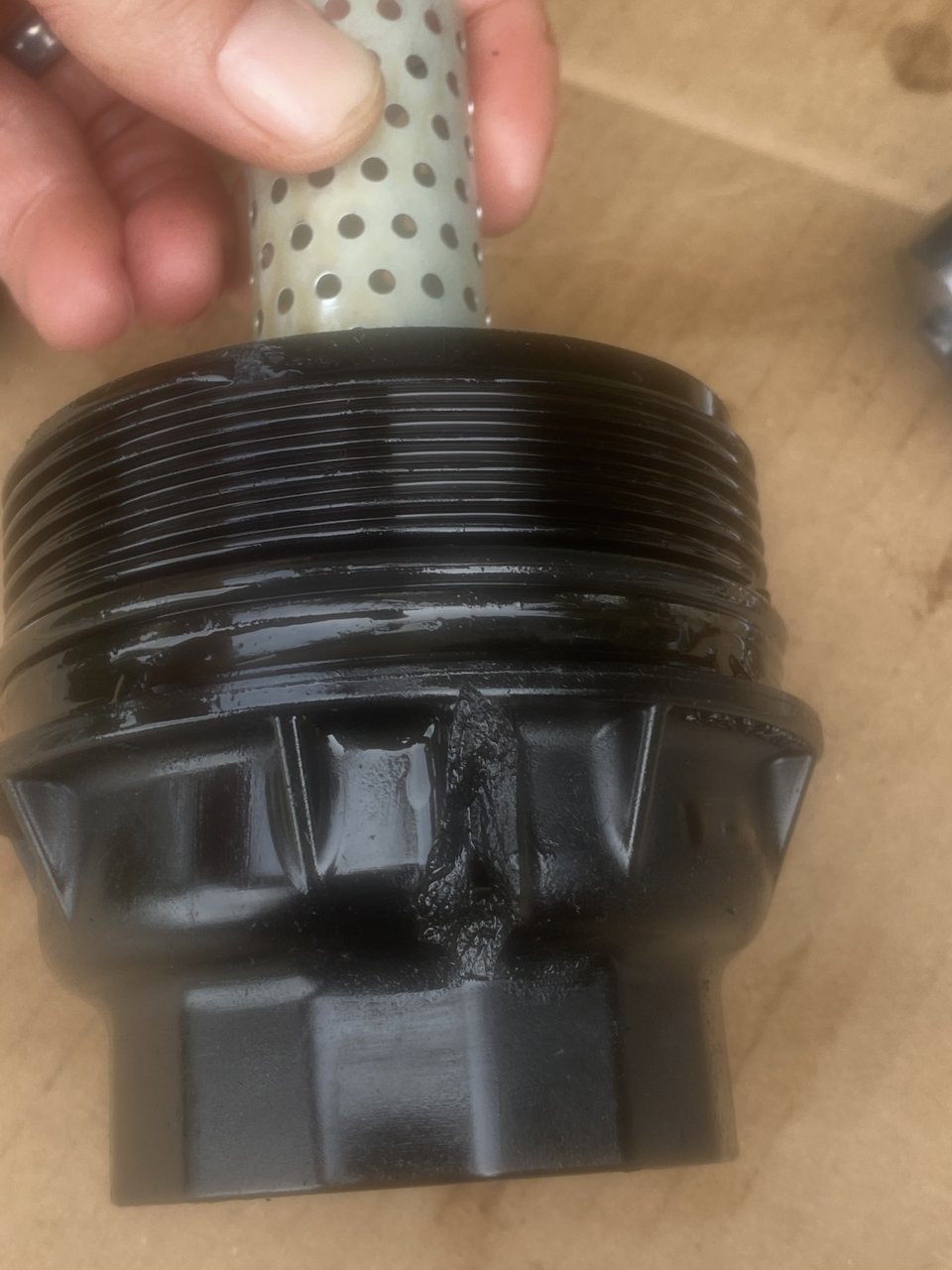

    Just a PSA and friendly reminder. I bought a 2017 Tundra a couple weeks ago and am doing my first oil change on it. Whoever installed the housing prior to me completely ham fisted it on. I put a new aluminum replacement housing on order right before I got the breaker bar out since I had a feeling what path I was about to head down. Anyways, got it off but broke the housing and put a hole in it. I guess the truck will be sitting for a couple days.
    Pics of the carnage:

    I assumed as much. Took at least 100ftlbs to get it off.

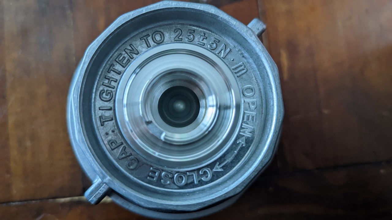

    Shit just changed mine last night 18 Ft Lbs and 9 for the center cap. Get yourself an aluminum cap. search Amazon

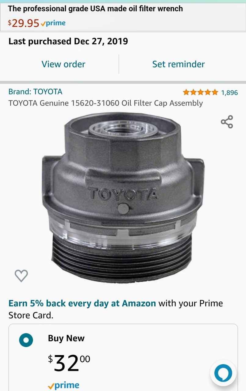

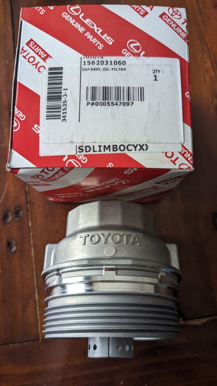

    I bought my metal housing off Scamazon and noticed does not have Toyota cast into the side like the one pictured. Wonder if I got a counterfeit one

    Yes. It may be a simple Amazon warehouse picking order mistake too
    It should look look like this. Mine came from Megazip as it was the cheapest shipped to Canada.

    The bottom is exactly as yours but does not say Toyota on the side. Also noticed it does not seem to engage the spring clip like the plastic one did but I’ve done 3 oil changes on it and no issues. Just did one last Saturday so might be a couple months before I see it again

    Hmmm… I didn’t notice a “Toyota” on the side of the new aluminum filter housing, but I didn’t look for it either and I don’t really feel like pulling the skid plate to check. It came in a Toyota box and installed easy enough.
