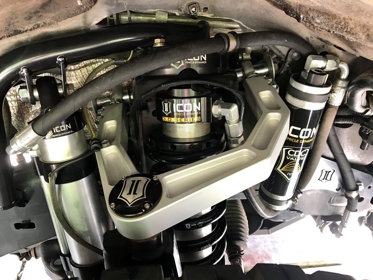

    Also, Icon porn since we’re on the topic. We went with them for the same reason many have mentioned. They’re the only company that makes shocks and arms and hoops and coilovers specifically for the Tundra. They engineered everything to work together from soup to nuts.
    Bad ass build Pat! :bananadance:

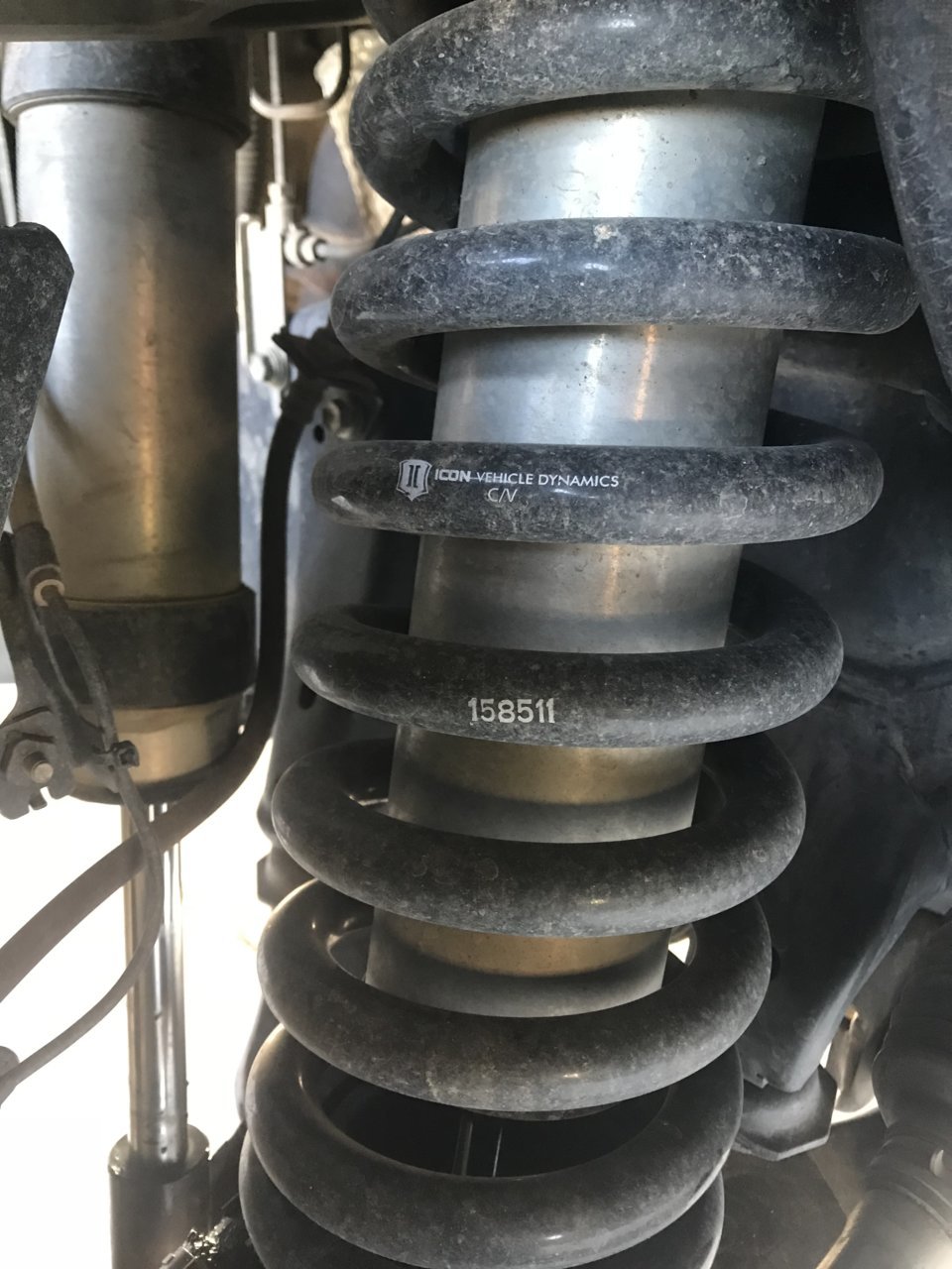

    According to Icon, it's a 600lb spring. Not a 650 on the 3.0 fronts. They do not have a 700lb spring. The 3.0 springs were supposedly custom made.
    The 2.5 shock has a 600x16"x3"ID spring, the 3.0 has a 600x17"x3 5/8"ID spring
    @olsin6 Do you know if this is true?

    Well then idk lol @olsin6 HALP
    @KevinK can you send me a pic of the numbers on your coils?

    These are the only numbers I see on the 3.0 spring. 158511
