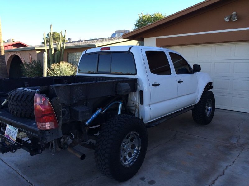

    I'm a fan of keeping shocks under the bed

    That’s nice!

    Look at the size of those Resis.

    Lol that was was old Tacoma, the rear end on it was dialed, Defined Engineering SUA, Deavers, King 12" Comp adjusters, bumped and strapped at 13" of travel.
