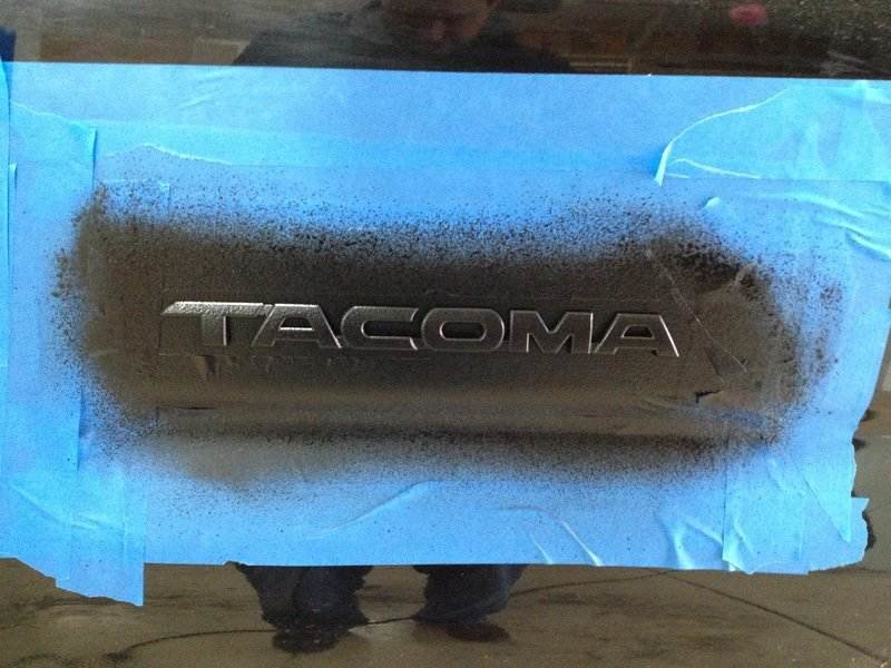

    Yea its not hard to do. Just tape around the emblem leaving an inch or so around the emblem. This will help you peal it from the truck. Spray around 5 coats, let it dry then peal away the access from the truck.
    Pic from when i did it to my Tacoma.
