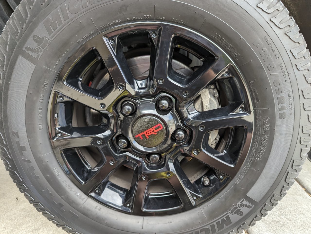

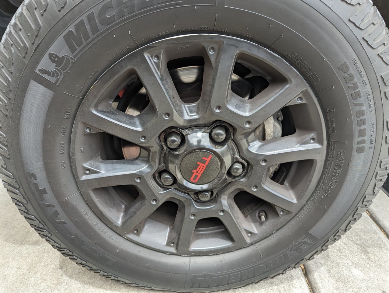

    well, after two years it was finally time to peel the plastidip off. Overall, i think they heald up really well. There was a little bit of peeling on the edges, but nothing crazy.
    I had TVD Vinyl overlays sitting on the work bench for the last year or so, so it was time to give it a freshening up.
    It took about 1-1.5hrs per wheel. The plastidip peeled off easily, except for inside the barrels. It just wouldn't come off. Luckily i had ordered some Xylene (you cant get it in stores in CA, but found a 3rd party reseller on Amazon) and that stuff immediately dissolves plastidip. I poured some on a rag and a little wiping and it was gone. I ended up doing a second pass with a fresh rag and Xylene to get any last residue off. Overall it wasn't perfect but good enough for me.
