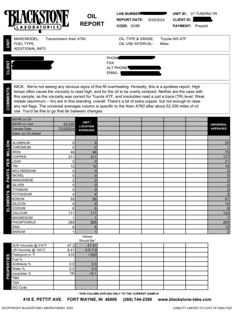

  28. Aug 29, 2024 at 4:20 PM
    #88
    bucketlintels02
    bucketlintels02 Newish Member
    Apr 30, 2024
    #116160
    118
    NW Georgia
    2021 Tundra TRD-Pro Crew
    RAS Road-Active Suspension System HD. 2" (estimated) Spacer and Block Lift . S&B CAI - closed VLED Footwell lighting MESO Customs Interior Lighting 285/65/18 KO2 Gator Hard Cover Tri-Fold AJT Designs interior trim CSU 9 - year ceramic coating Rigid Amber Fog Covers Full Tint (70% Windshield) 20% all others.
    Blackstone report on my drain/fill right after the cooler install. This is with several trips towing our 7k lbs. travel trailer.
    not bad.
    Ponderosa_Pine and ID-Matt like this.
