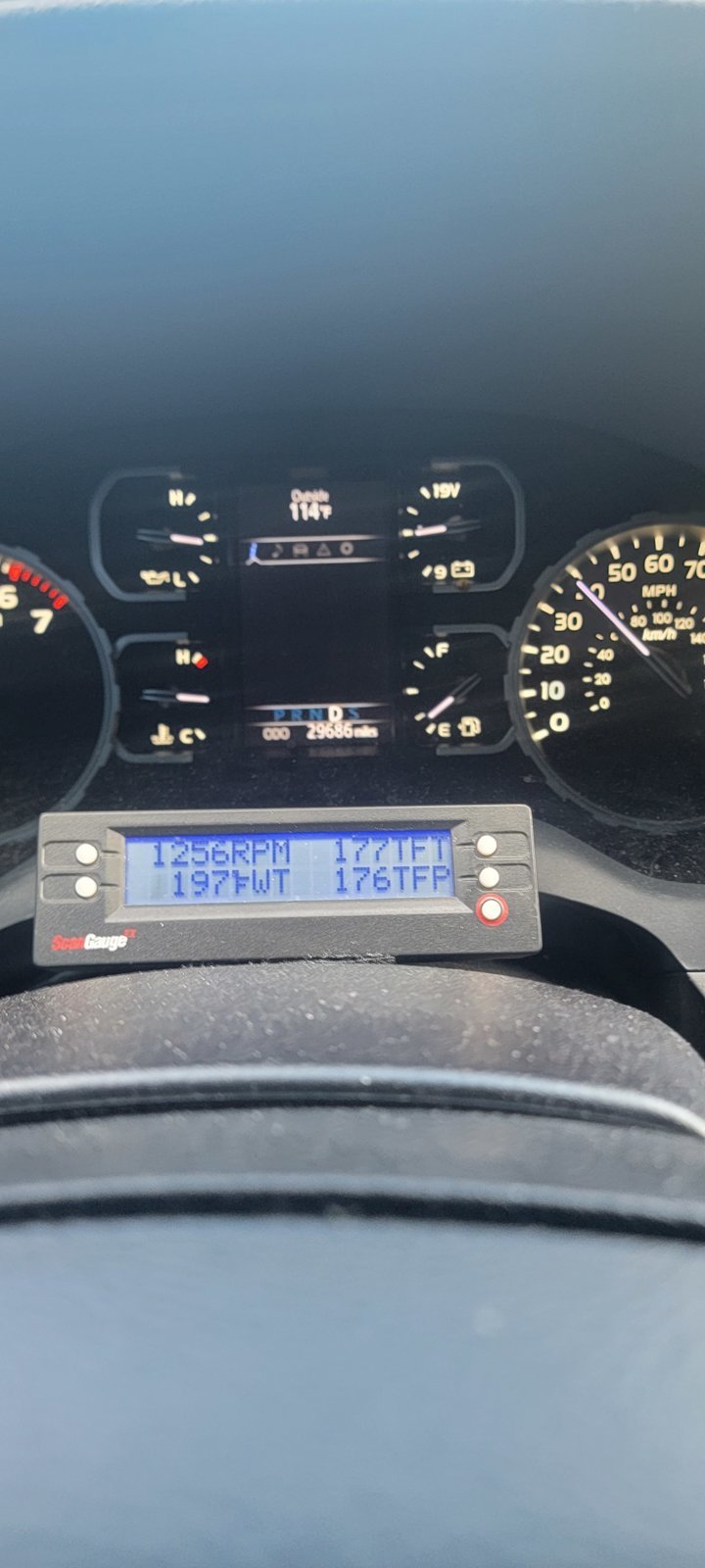

  26. Jun 7, 2024 at 4:26 PM
    #56
    Chip_Tundra
    Chip_Tundra New Member
    Mar 25, 2020
    #44310
    281
    Keeping my thermostat pinned.
    Temps on a completely stock, unloaded truck on a 113 degree day:
    Mdl likes this.

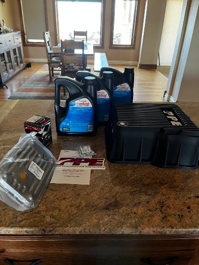

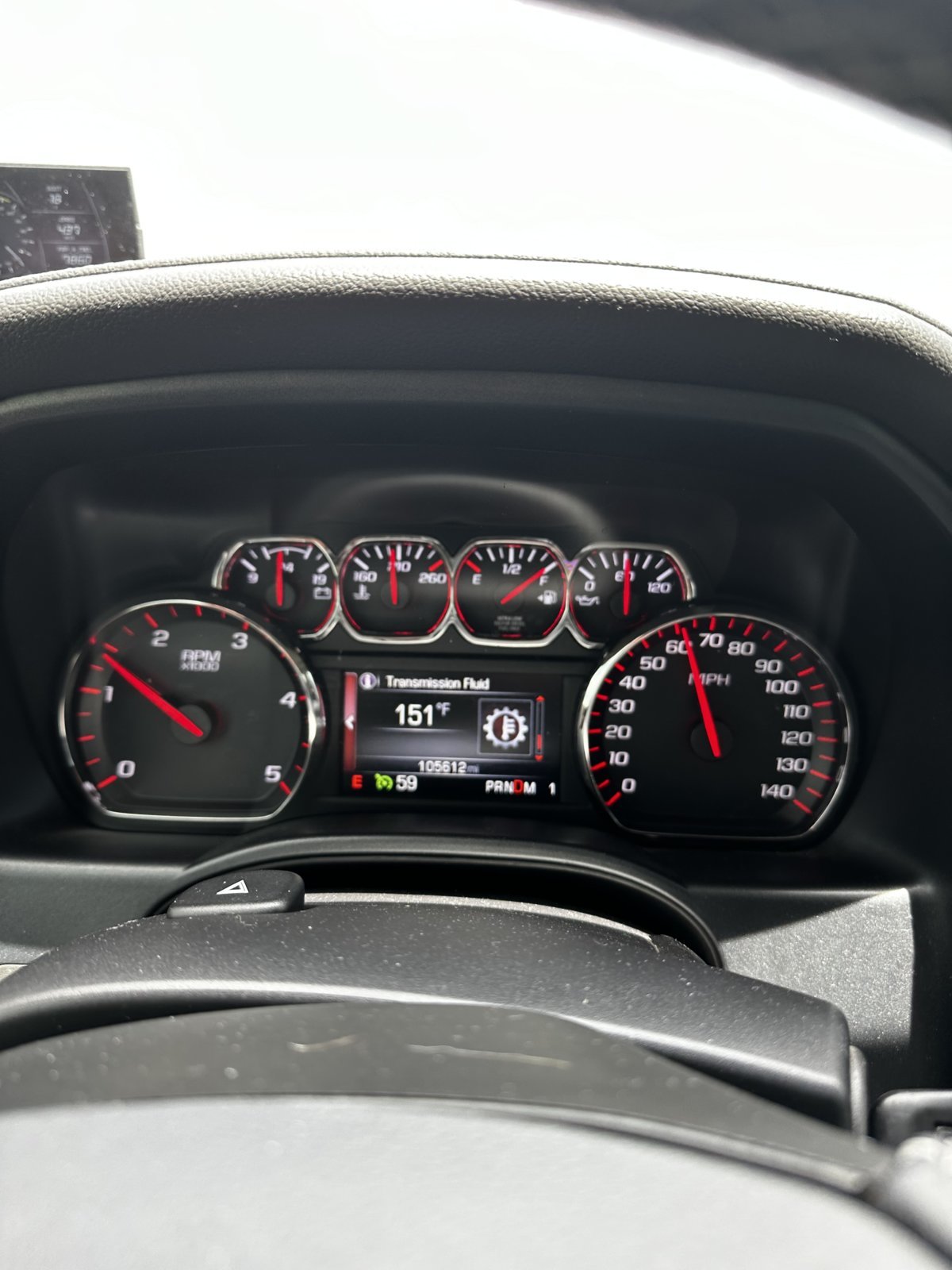

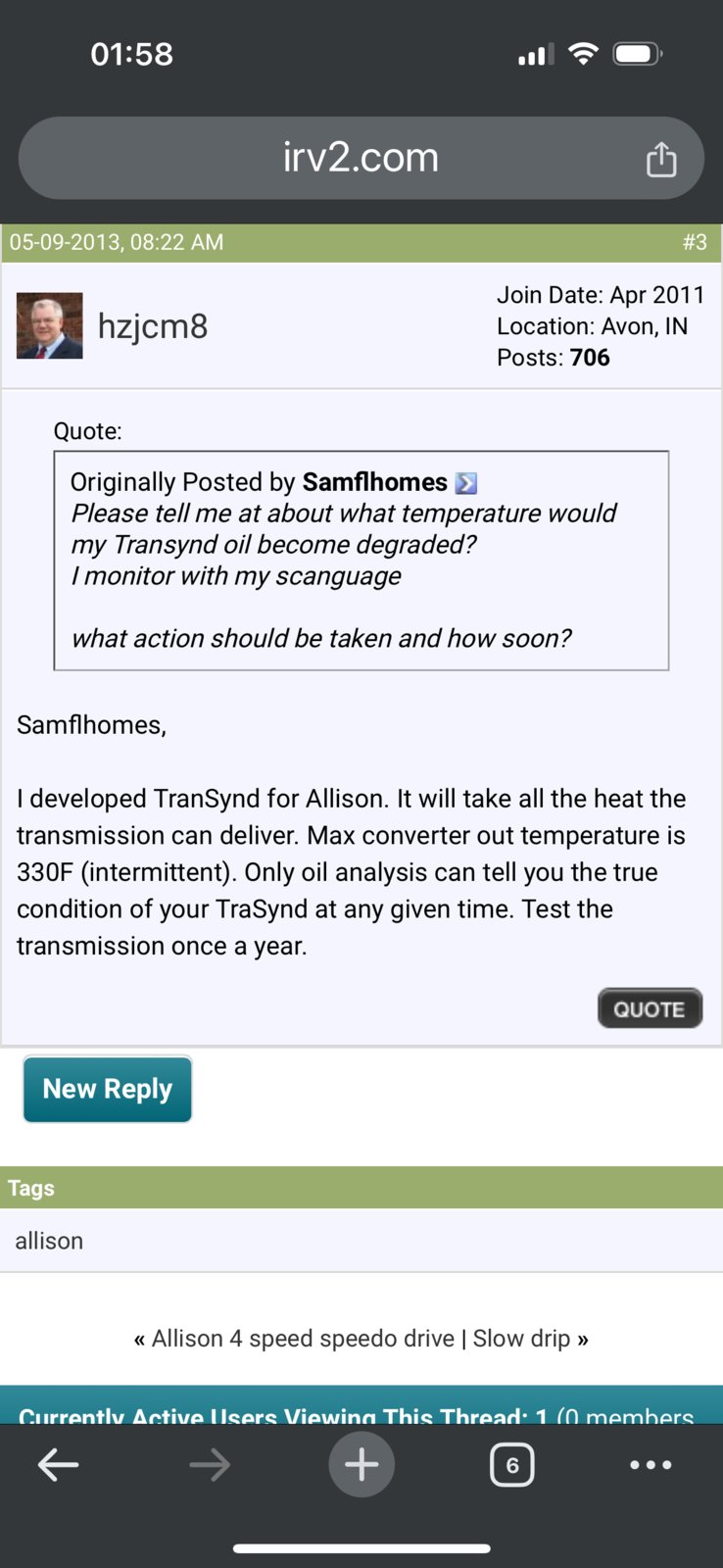

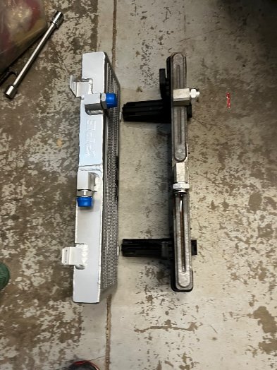

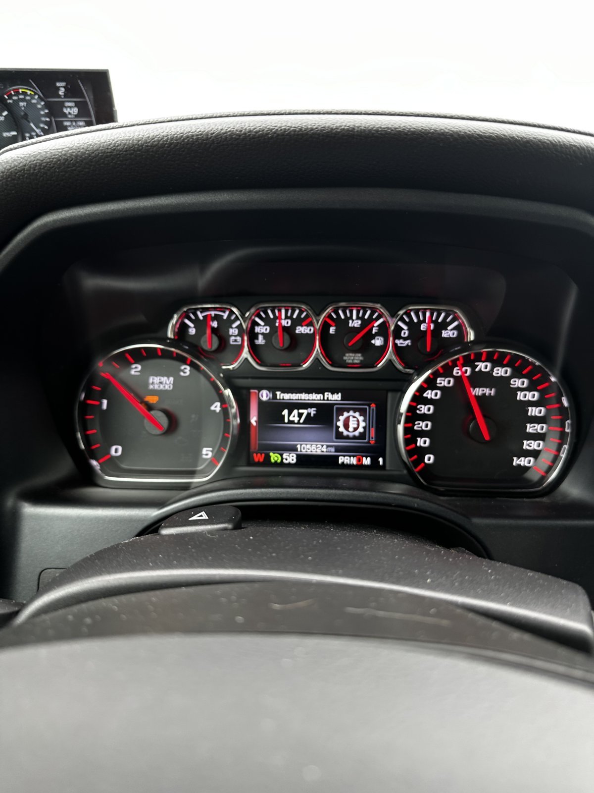

  27. Jun 8, 2024 at 1:42 AM
    #57
    ColoradoTJ
    Feb 24, 2016
    #2766
    40,935
    Ask your BIL what temps he pulls in the winter. That might surprise you.
    The other day it was 95*F (at 7000'+ elevation...that's hot) out in town and I was driving my truck around town and I seen 180* trans pan temps.
    Today, remembering this thread it was 84*F ambient and I had to finish up an exhaust regeneration so I got some numbers for you all. Now doing a regen on the DPF filter can raise the trans temps a bit due to the exhaust temp raising to 1100-1200 deg F.
    I would like to preface this with I have a transmission tune that raises line pressure. This increases the trans temp 15-20*. I'm also running larger heavier tires. To offset these increased loads and temps I added a larger transmission cooler (65% more surface area) and a larger/cooling trans pan.
    Running around town and then continuously in hilly terrain with CC on 55-60 mph, 80-85*F.
    In this last picture, you can see my tow haul was enabled. I ran like this for a few miles and it dropped the temps. This allows the Allison trans lock up the TC. Since I was going under 68 mph, the truck was in 5th gear instead of 6th.
    I have serviced this transmission about every 30-35k miles and the fluid comes out like brand new. I'm thinking this next interval will be longer. Allison recommends 90k miles but that is a bit far for this guy.
    This member on an RV forum developed the fluid for my specific transmission and this is what he had to say about temps:
