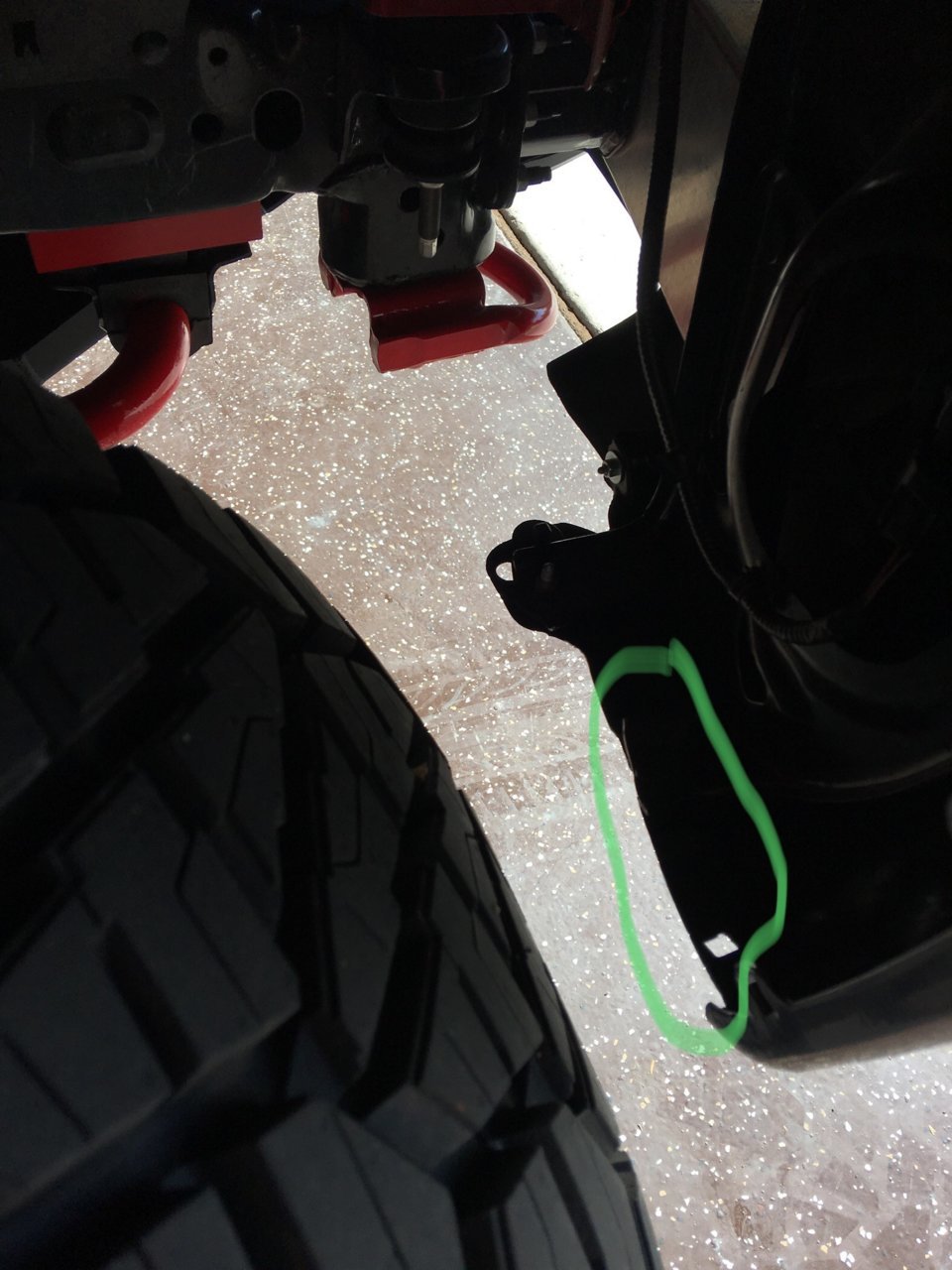

    I trimmed the fender at the very bottom (nothing on the side) and folded the pinch weld seam up to 1st mounting hole for the liners. BMC up to flange of the bushing mount. I also trim the front when I had the stock bumper. I also modded the liner and mud flap for cleaner look. See pix for the mods. No rub at full articulation while at full lock.

    Those are stuffed in there!
    I like it!!
    Not sure I can pull it off with my 20” +25s.
    Well, at least until I install my bumper and do BMC.

    Wheel diameter doesn't matter relatively speaking. One major key is wheel offset, ideal is +18mm to +25mm and you are within it.

    what trimming was required?

    Inner front wheel well liner and a small lower portion of the bumper
