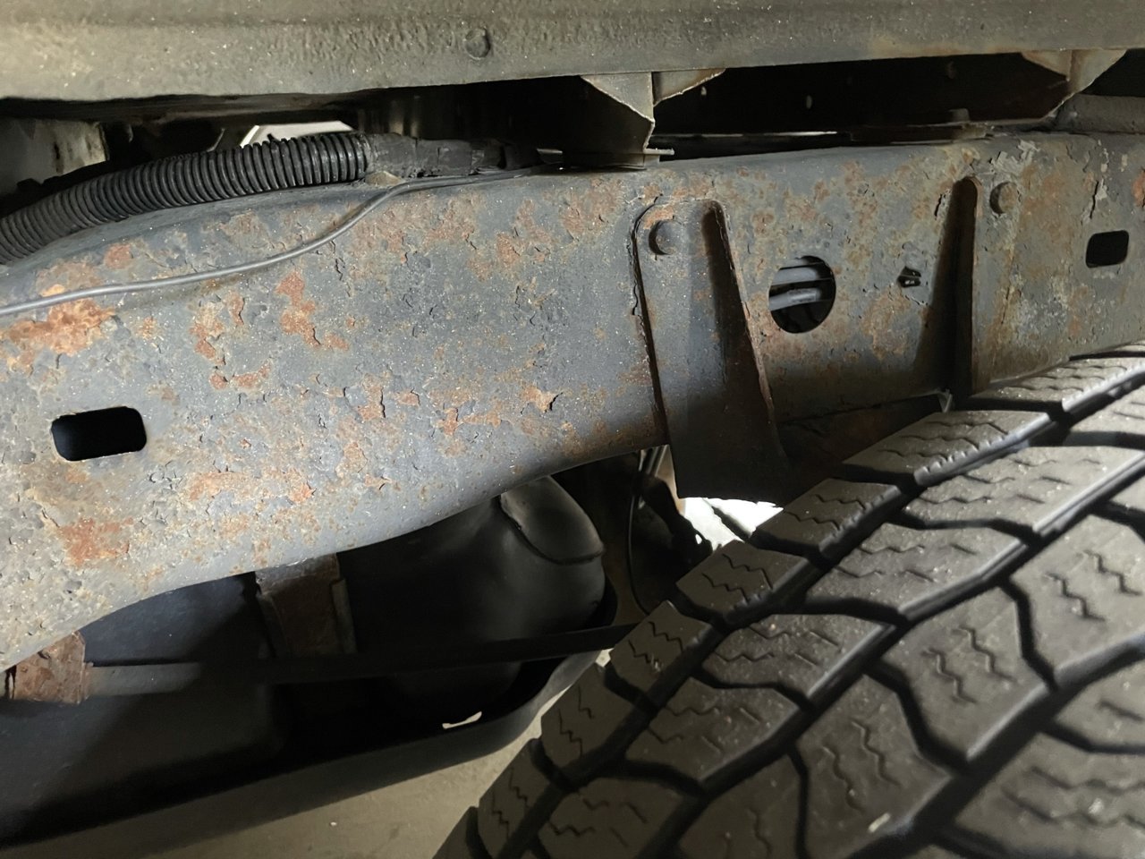

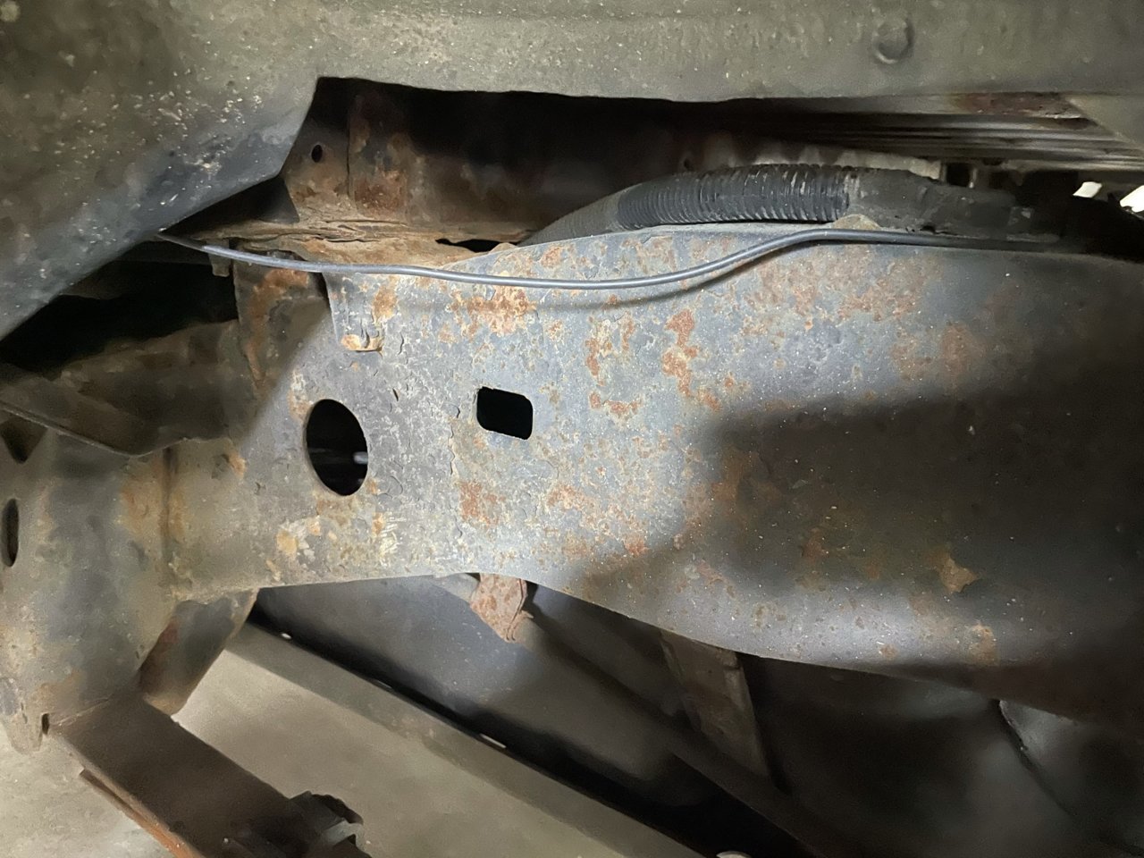

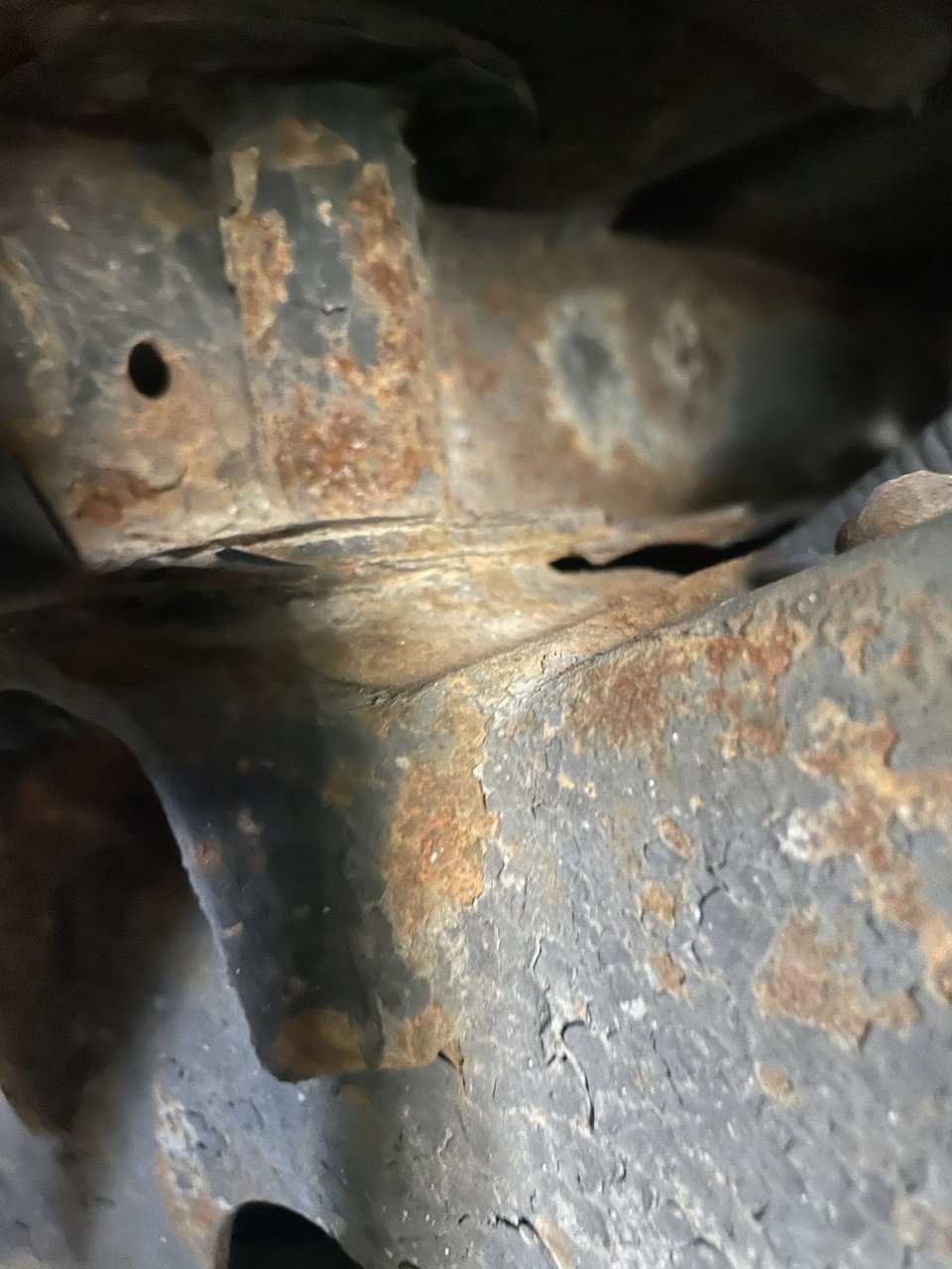

    Your experience is suspect when you tell us about your purchase and then post pictures that are way worse than the problems you described.
    In the picture of your crossmember alone there are at least 3 things that raise big flags and you didn't mention any of them. Frame is cheese grated @ the crossmember mount, GIANT patch on the frame rail and your sway bar bushing is dangling on the sway bar.
    So then the question becomes, how did this guy NOT see those things ? If its your lack of experience, thats OK. Own it and ask for help, you'll get it.

    I honestly don't think that should be on the roads in that condition, either swap the frame or cut/replace

    It looks like the whole frame has been either painted or coated with por15 stuff right over the existing rust. It's already rusting from inside out.
    I would leave away bar off and patch that section good before do anything at all. And remount the sway bar mount.

    Most the frame looks like this, I obv noticed the patch and the cross member bar. That doesn’t bother me as it’s replaceable. And for the price I got a pretty great truck with zero mechanical issues.
    Yes I can weld, I don’t think I’m that good at it so prefer not to. I have no idea how I missed this, only thing I can think is I’ve had and been driving around for almost 2 months and it could have snapped off or looked different.
    My feelings have not been hurt, I just think 1/2 the reply’s are useless, and someone’s opinion without seeing the full truck. I didn’t ask what guys thought of the safety or the viability of patching I simply wanted to know the best way to go about this...

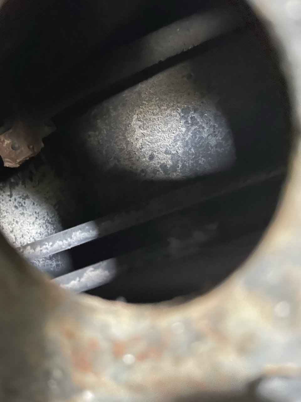

    Inside the weep holes of the frame look even cleaner (see pic) I checked them all - obv mad I missed this bc I could have neg a better deal but mostly bc I wouldn’t have been bombing around in this thing for last few months
