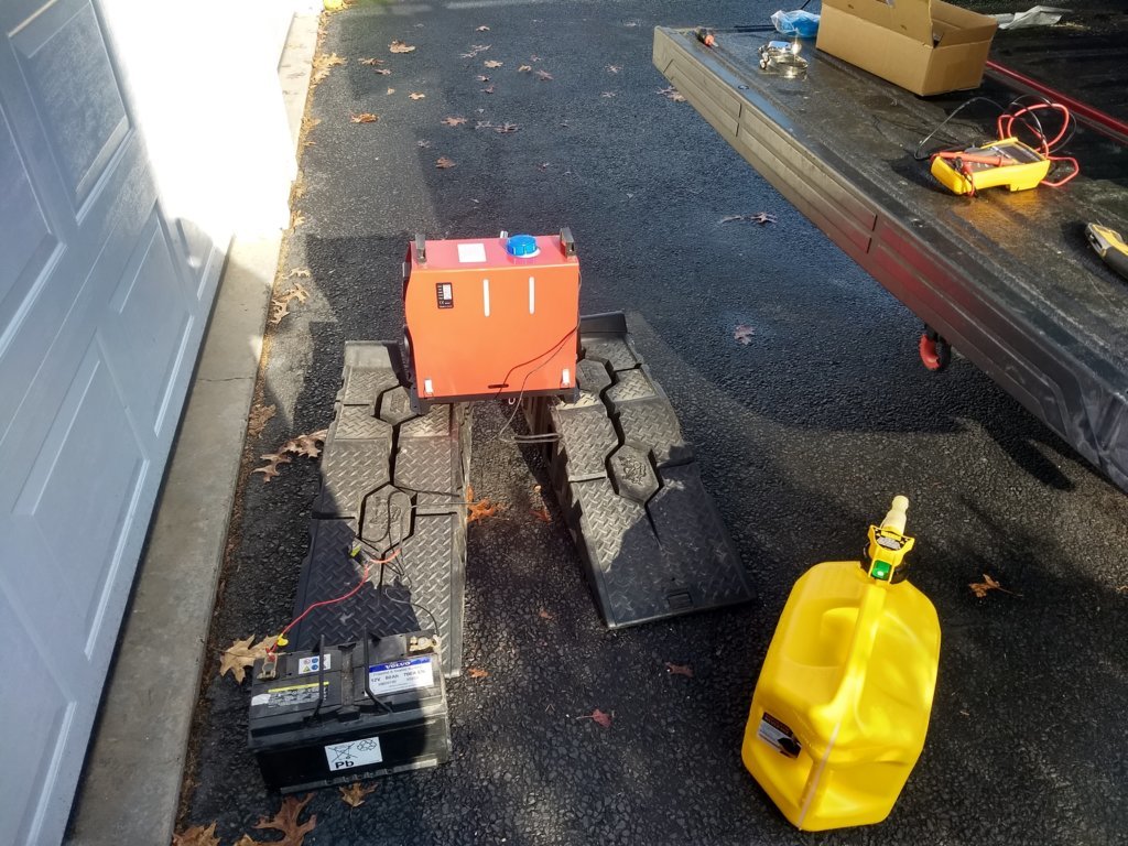

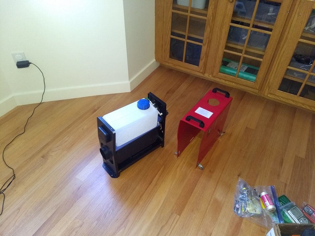

    Ok, I get older, joints move slower and painful in cold. Sleeping in single digit negative temps in unheated bed cap is possible, but requires too much effort. Efforts if you ask: stop drinking about 2 hours before going to bed, dehydrate, have 3 insulation layers on top of tote, 0F sleeping bag, wool blanket, possibly polyamide emergency blanket if it's very windy, 4 layers of warm clothes, balaclava, something on the face all night long. God forbid going out to pee at night. It's definitely doable, and I did it many times, but enough is enough. So here my Christmas gift: the cheapest Chinese diesel heater.
    It had front controls screws positioned strategically against very thin fuel tank, no fuel filter and soft fuel lines. These have been fixed immediately. I may need to replace a noisy fuel pump, but it's not too bad. And it makes more sense to soundproof the sheet metal cover first.
    First run was a success, it was able to prime the line on its own, and heated up to 360 F in a few minutes.

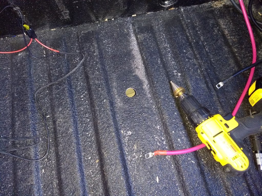

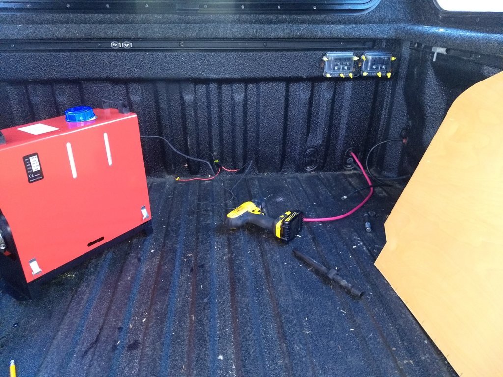

    The idea is to install it semi-permanently in bed, by the secondary battery, and have it push button ready. I sleep in cabin lately, so noise will be greatly reduced.
    The best location as it seems is close to the front of the bed, above the heat shield. Don't blame me, but I drilled a hole for exhaust pipe in perfect bed :)
    Would need to rust-proof it later. The heat shield acts as a splash shield as well, so the moisture entering the bed shouldn't be a big issue.

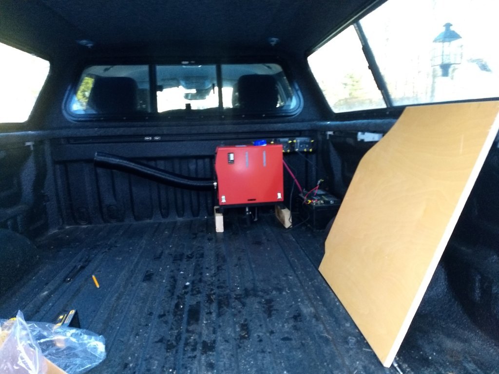

    Did a pilot run, with a 10 ft long flexible exhaust pipe.
    And almost died of a diesel fumes stench. But it was warm :) Declare it a semi-success for now.
    Lessons learned:
    - flex exhaust hose sucks
    - need to use 90 degree elbows
    - all exhaust joints have to have some tailpipe putty
    - exhaust heats up significantly, need to route it carefully around brake lines and electric cables
    - which is impossible/impractical with flex hose
    - so have to redo it using straight pipe and elbows
    - fiberglass wrap does not provide enough insulation
    Thinking whether I need to use a stainless steel pipe, or copper would do it. I can weld both.
    Also it seems the exhaust must be venting waaay away from truck. I may fabricate a rigid exhaust pipe with exit in the vicinity of engine's tailpipe, with some sort of removable lid, so I could still offroad, and attach that 10 ft long flex pipe when camp spot is found.

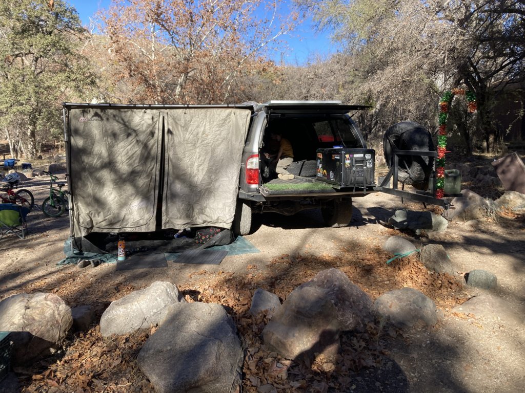

    I’m on a heater FB group and waste oil is a big no no for these reasons. I’ve ran kerosene but that stuff is almost 3x more than diesel here.
    Since I run mine in my uninsulated tents it’s usually at 60% or higher and my exhaust pipe is always clean as a whistle! This last trip I opened the tent to check on the kids and it was like a damn sauna inside so I had to turn it down! Hahah another trip I come in the tent and my kid is sprawling out on the cold tent floor, I’m like what’s up dude? ITS SOOO HOT IN HERE!!!!
    IMG_7462.jpgNice and toasty this past weekend
    Warreng and vtl[QUOTED][OP] like this.

    ARB awning room! I have one, too! :)
