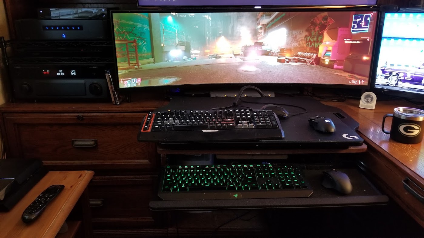

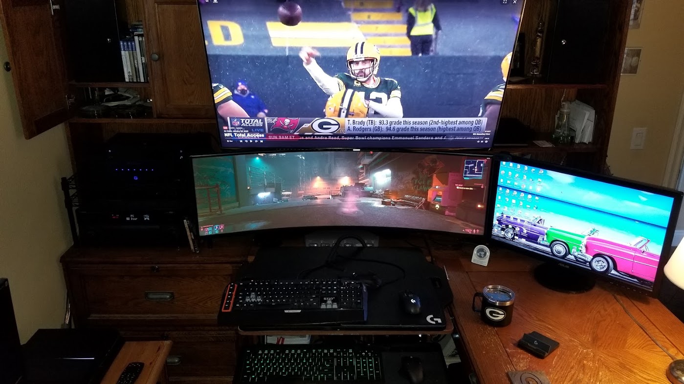

    49" Super Ultrawide gaming monitor, processor/amp to the left, and dual keyboards/mice. The top keyboard is dedicated to the gaming rig, the other is on a 4-port KVM switch so that I can switch between 2 work laptops, my laptop (pic further below), and also the gaming rig.
    Samsung 50" KS8000 TV mounted above for 4k HDR movies, and additional monitor for work. So my workspace is essentially 3 1080 monitors. All that real estate makes productivity/work so much better! I could never go back to a single 1080 display for work ever again. And I won't apologize for the GB plugs. :D

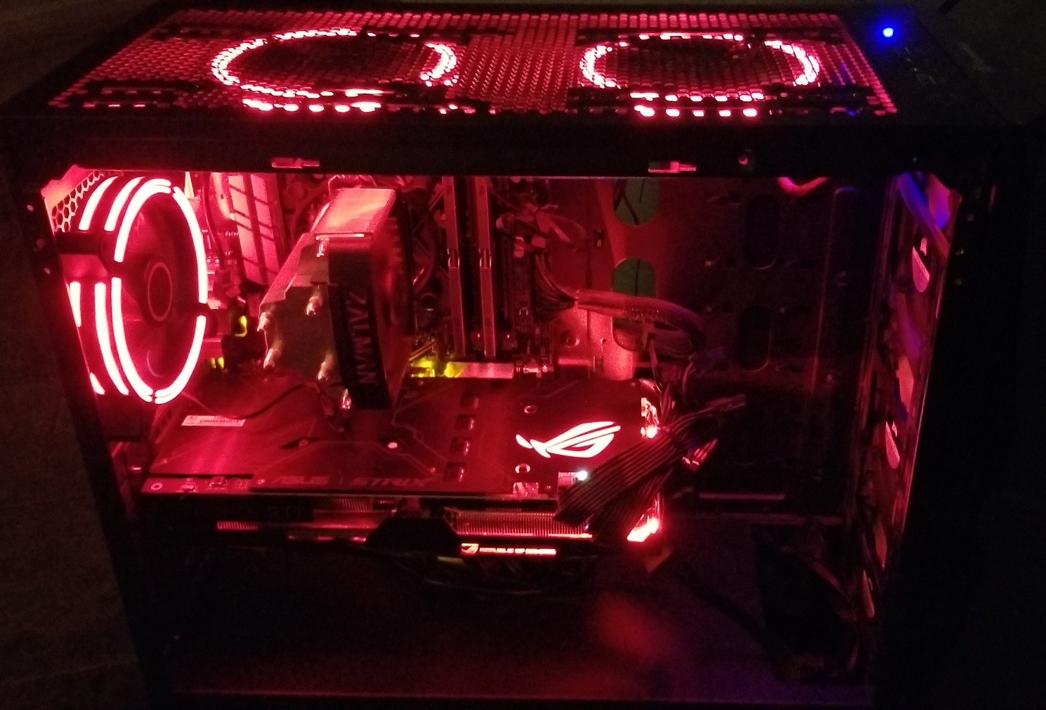

    I kicked the 2060 Super down to my son and helped him with his first build. He wanted all red.

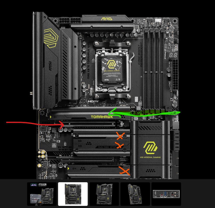

    I looked at your motherboard. Here is what I sketched out to hopefully help you out. I started with a screenshot of your motherboard and highlighted where your primary SSD will go, video card and extra m.2 slots. Your motherboard has heatsinks for 4 m.2 drives but only two pcie 5.0 lanes. One will be used by your video card and the second by your primary SSD drive.
    The green arrow is where you will install your primary SSD. You can see the motherboard already has a heatsink for it as it will be installed under the heatsink. The red arrow is where your video card will go. It will cover up your SSD drive but as long as you use the heatsink provided by the motherboard then it will fit just fine. The orange x's are the extra m.2 SSD drive slots that are under the heatsinks by the motherboard.
    Order of installations is to install your SSD's drive(s) first and then your graphics card last as it will cover access to the SSD slots depending on size.
    4 TB's is a large drive, I don't see a benefit to having a smaller OS drive with a secondary drive. Just stick with 4 tb with everything in it and if in the rare chance you fill it up, then add a second m.2 later on as needed.
    Your selected motherboard:

    I prefer to keep games on a separate drive than the OS, so yeah I have a 2 TB SSD dedicated to games. I've been doing this since long before SSDs were a thing, but that said it isn't as critical today since SSDs are so much faster than old school disk drives. But still, I've been doing it long enough that it just seems weird to me to have the OS and game r/w operations running on the same drive. In reality it might save you a few seconds in load times, but don't expect to get a significant jump in FPS or something. And since you're going with 64 GB of RAM (which might be a bit overkill now, but definitely a furture-proof decision), that should help minimize things like page filing that might decrease performance.
    As for the GPU covering the SSD, that's pretty normal with the size of GPUs. Unless you plan on pulling it out regularly it shouldn't be a concern, and install it first before the GPU like @AZBaldy said.
