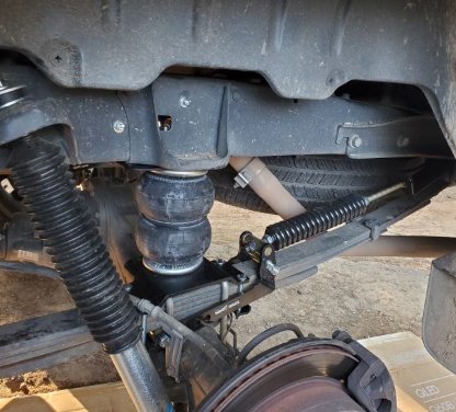

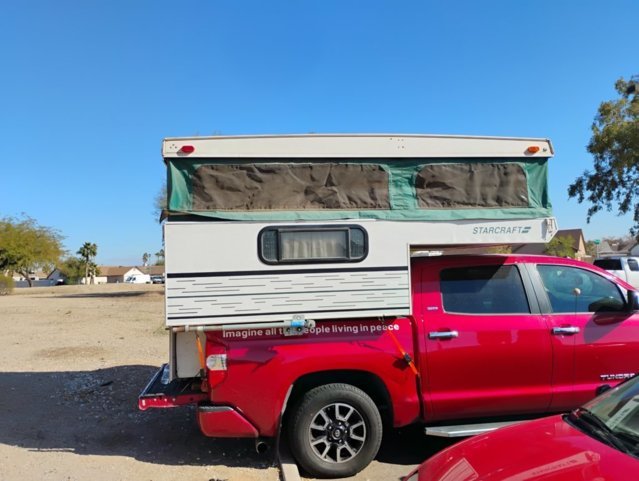

    I've had this on for almost 12k miles now, other than a couple W shaped leaf springs there has been no negative repercussions.... Yet.
    Definitely want to add support, I went RAS and bags because it would sway like a dog with a waggly tail.

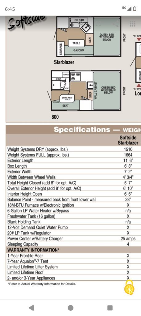

    For reference the camper is just under 1500 lbs
