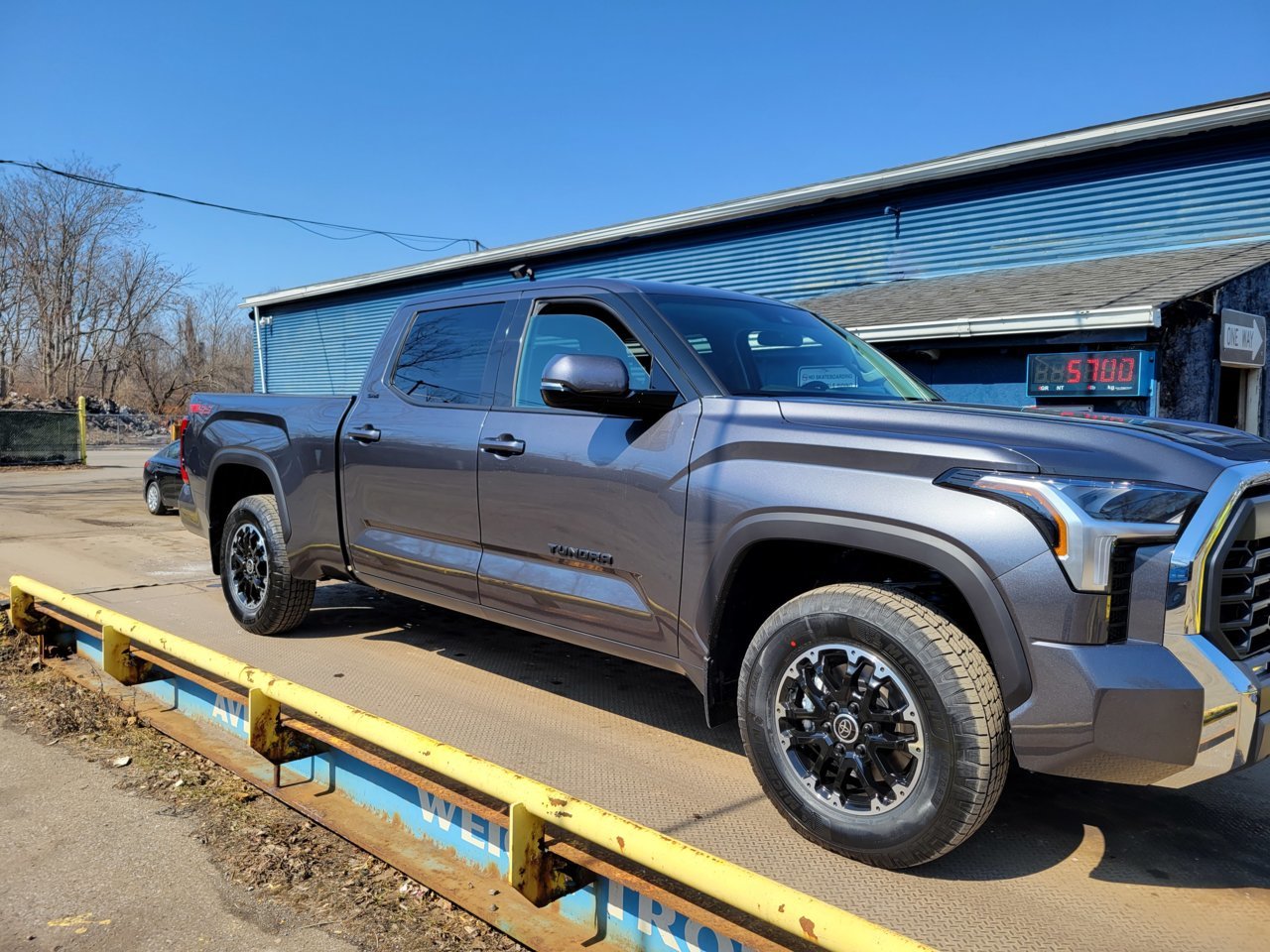

    Here's actual weight on my 4x4 SR5 TRD OR CrewMax 6.5' with FULL tank of fuel (32.2 gal). No one is in the truck.
    Options include Softex seats and TRD OR package.
    1355lb - 11lb = 1344 payload sticker rating.
    GVWR = 7340lbs
    Curb weight
    = ~5700lbs full of fuel
    7340 - 5700lbs = actual payload of ~1640lbs as equipped
    (FYI, this same truck, except with manual fabric seats should be 1450 lbs sticker)
    Front axle weight

    Toyota is being conservative on the Payload stickers even though their marketing literature shows higher payload capacities. I dont think we will ever see an actual payload sticker on a Tundra that reads 1900 lbs or whatever they claim the maximum is.
