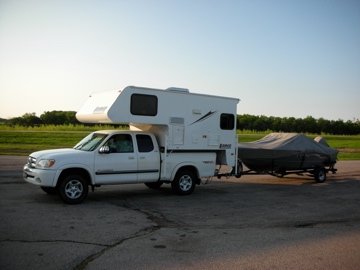

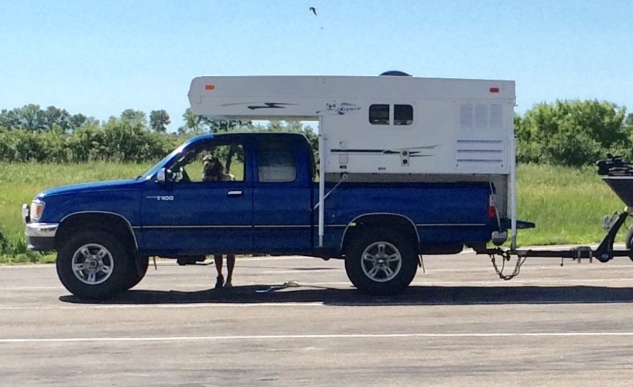

    Yep, and in that last T100/Fleetwood angler picture I lived in Alaska and couldn't afford to pay the year round gas prices of an F250 etc. I don't camp year 'round, but I need Toyota dependability full time.
    I will not own a domestic truck period.
    Think about it, old school Toyota class C campers were 20'+ long powered by 20r engines. It was slow going, but reliability ruled the day. I adopted the same thinking with my truck/camper rigs.

    That weight guess is about right. The Starcraft = 1400lbs empty.
    No exaggeration to say that I've had about 8-10 camper configurations over the years. My latest is the best imho. I'm 6'5'' and the Starcraft Stargazer pops up enough for my height.
    The T100 below was from '16, and that was a Palomino camper. The full sized rear door is a 'must-have.' No mini-me doors for moi, dunno how folks cope with that.

    Last pics, promise. Grin....another T100 and Tundra with yet a different Palomino. They are a good choice for an entry level camper.
