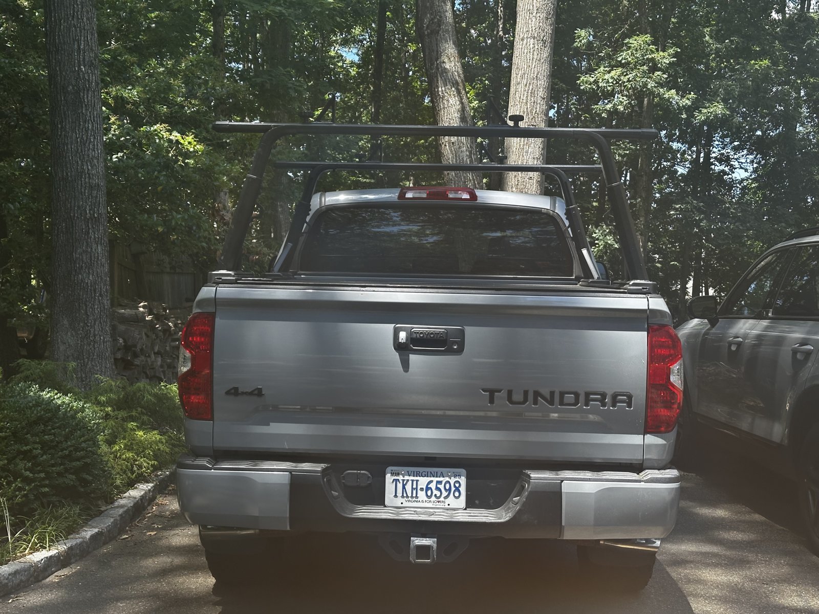

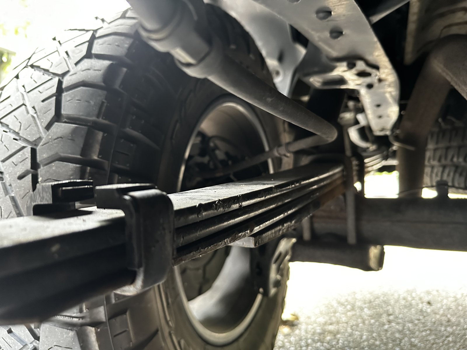

    My rear passenger side has a lean of approx 1.8" lower than the driver side? Wondering what could cause this? Could the rear shock or spring be worn out? Has 92k miles. Here's a pic and I just measured from center of wheel to top of wheel well.
    Shock doesn't seem to be leaking.

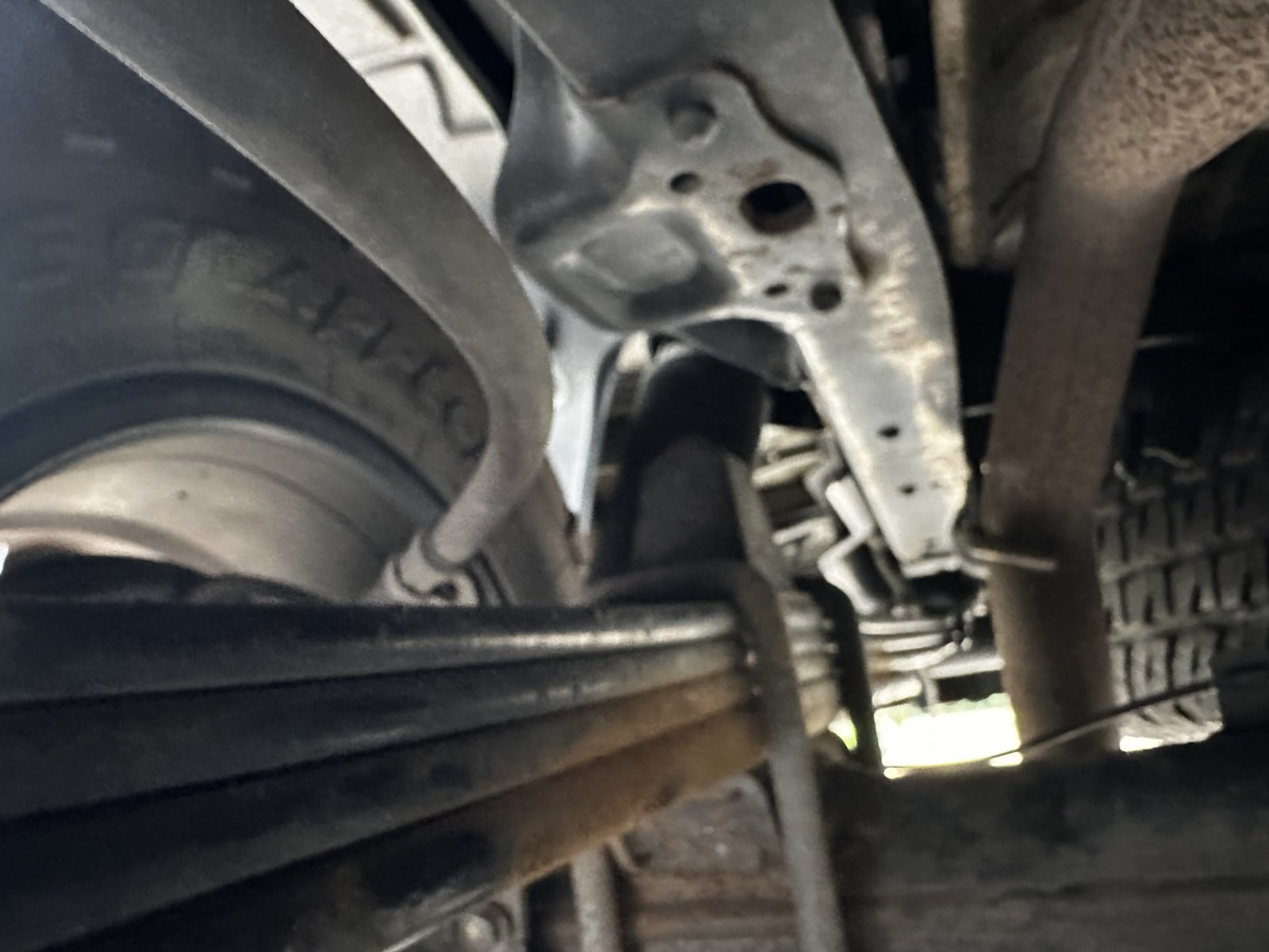

    So i measured the distance between the bump stops and strike plate and there is definitely aprrox 1" difference. The passenger side is less. I don't see a broken spring but here are pictures of the spring

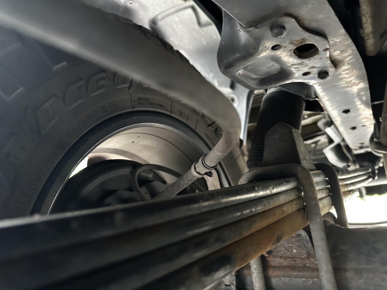

    Definitely looks compressed to me

    Your spring appears inverted at the mounting plate / U bolts and are practically touching the overload. Them dudes are flattening. Oddly mine have a similar appearance, minus the touching the overload.

    Should I replace the spring? I wondering if that would fix the sag.

    Yes. Both sides.

    Any recommendations on where to source springs. General spring seems to have regular and heavy duty versions. Should I look elsewhere?

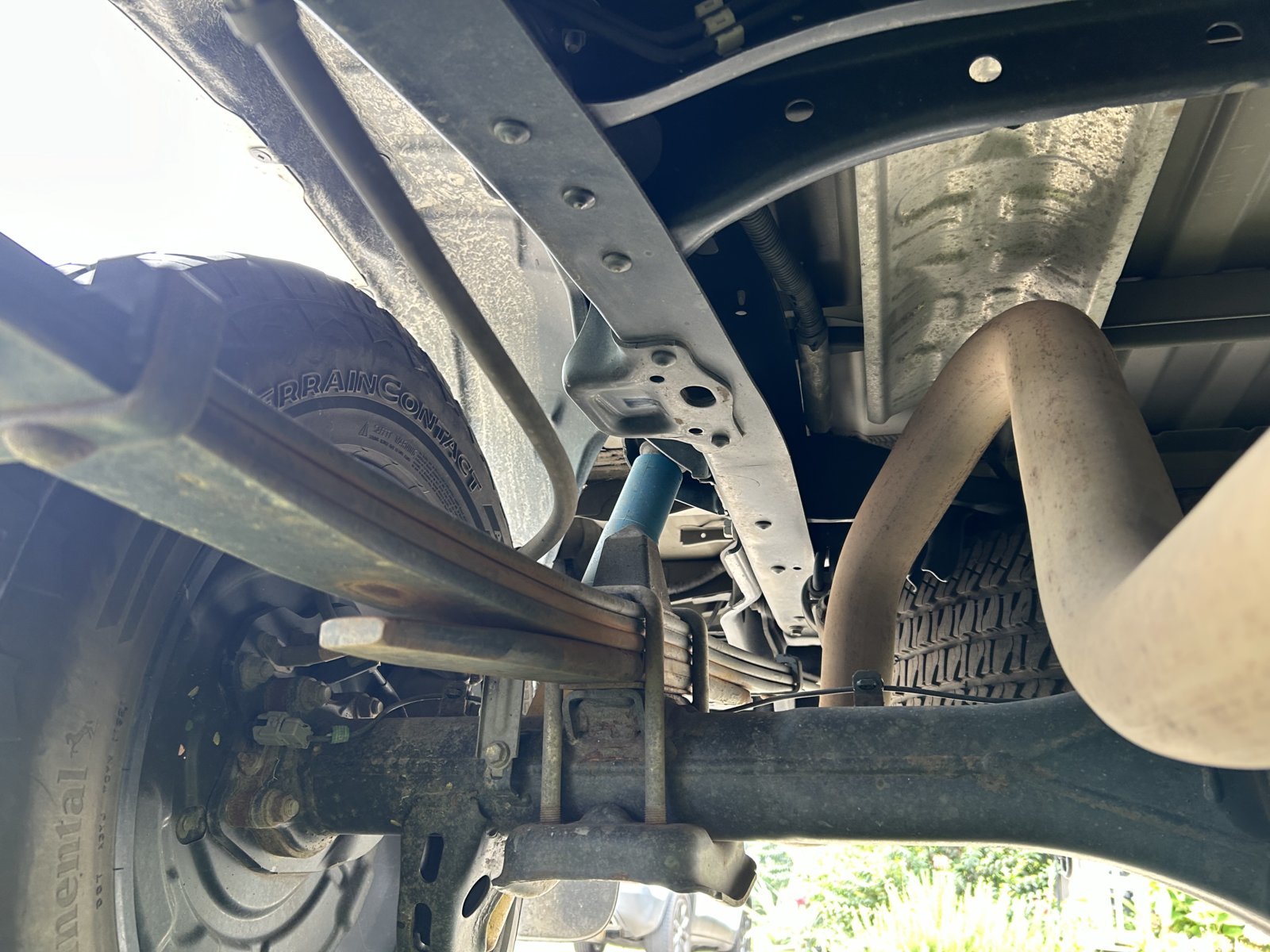

    I'll be doing Dobinson 330-770lb leafs, perhaps next year. My 6.5' bed is sprayed, has ~200 lbs Leer cap, 50 lbs roof rack, awning, canoe mounts, so about 300 extra lbs unloaded.
    Also you may want to replace your shocks.

    Okay, I think i'm going to order the dobinsons. I don't carry much load so not going to get HD version. What else should I replace with the leaf springs?

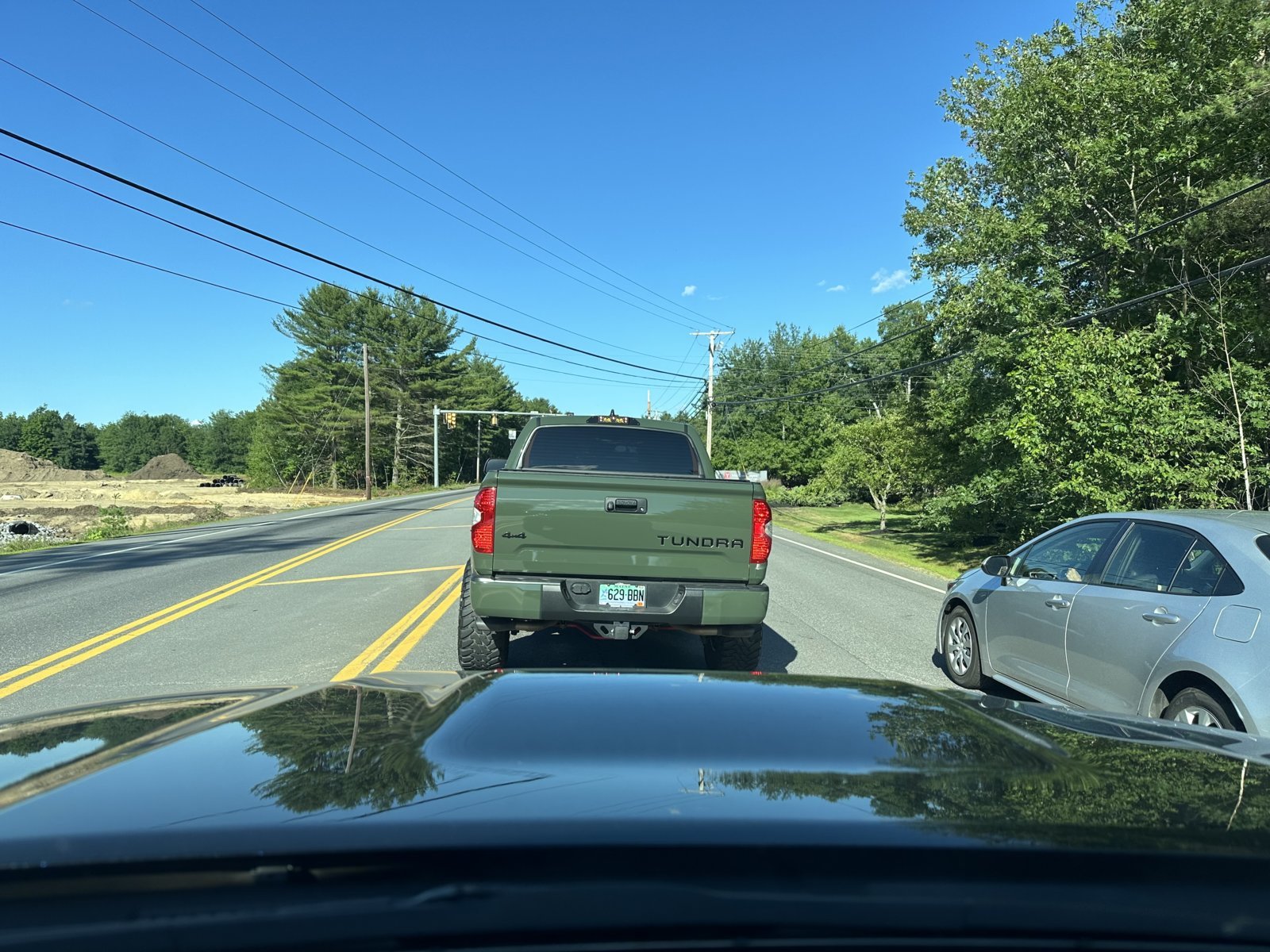

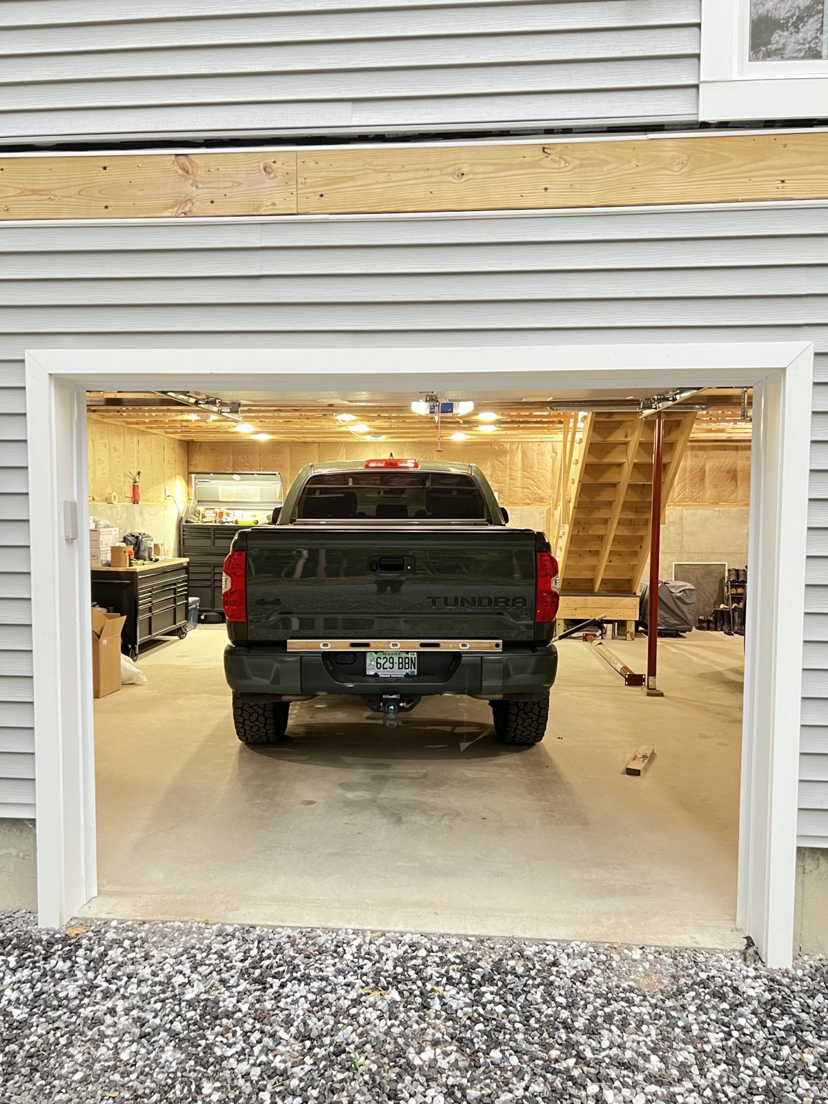

    My truck also has this same lean, my wife was behind me and snapped this pic because of how noticeable it was. I noticed it when in my garage on level floor before and measured all kinds of points on the truck with no real answer other than the bed it self is leaning. IMG_4967.jpg

    My wife did say when I floor it the lean looks ridiculous. So maybe you’re onto something. Since my truck is supercharged I wonder if it has worn that side out completely… I’ll post in the general supercharger thread and see if other people are noticing the same thing.

    This was from 2 years ago when I discovered the lean. I’ll have to get another shot like this later today to compare.IMG_0694.jpg
