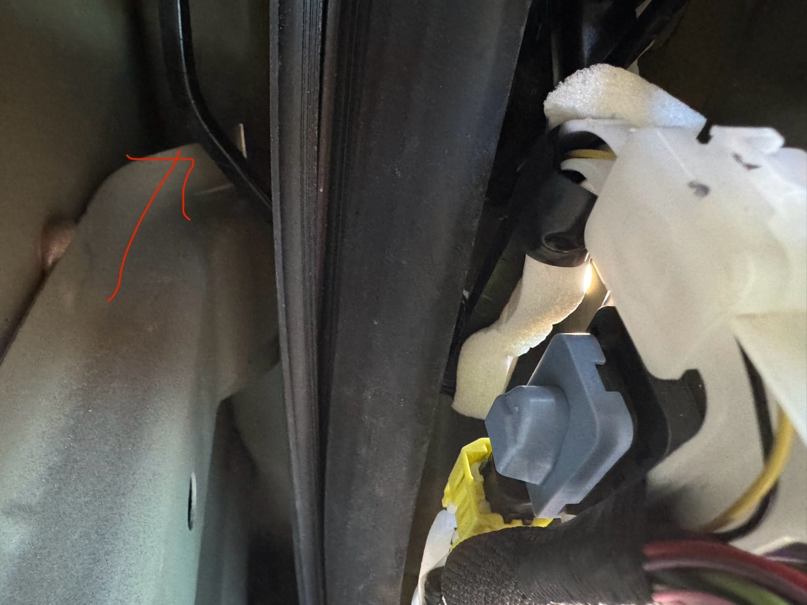

    #88012
    Vru
    2022 tundra
    Alright folks, found the issue. There is an armored wire that goes from the door handle around the window glass tray to the lock button wiring. This cable is armored in hard plastic to avoid snagging with the window. However, it’s loosely hanging and keeps banging against the door sheet metal on both sides when you hit a pot hole or bump. I put some 3m foam tape around it and no more rattle.
