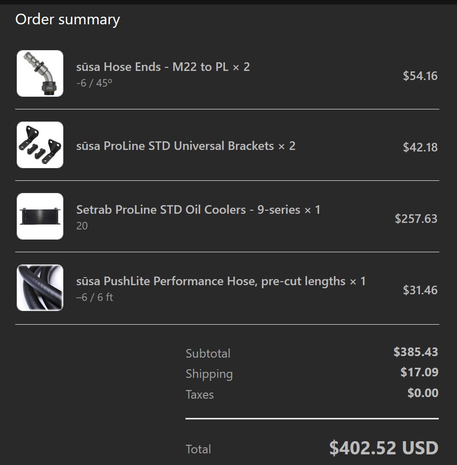

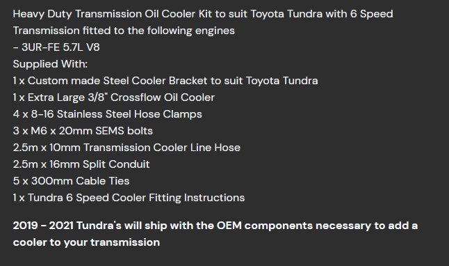

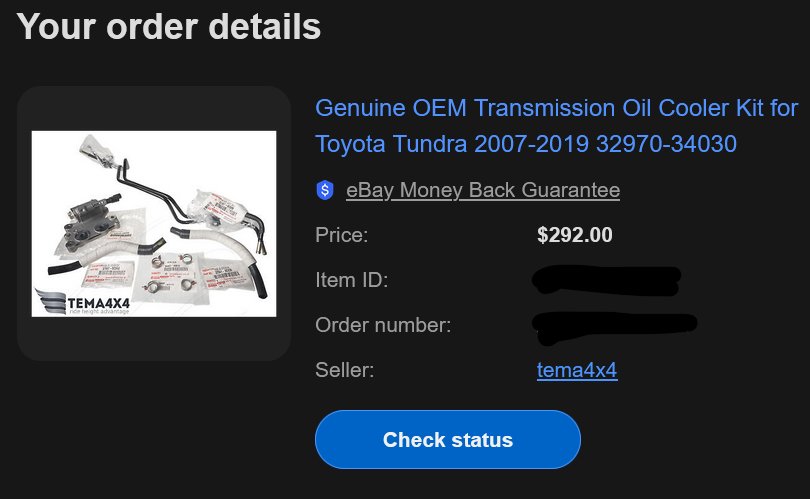

    Metrowest MA
    Paging Johnny @Cruisers & Co.
    Based on the bold print at the bottom, and based on the price difference between the model year ranges, I'd say "Yes" everything is included. WAT's own videos on the coolers themselves is also a pretty good watch if you have time. Same companies and people we had the GB with for the upgraded valve bodies.

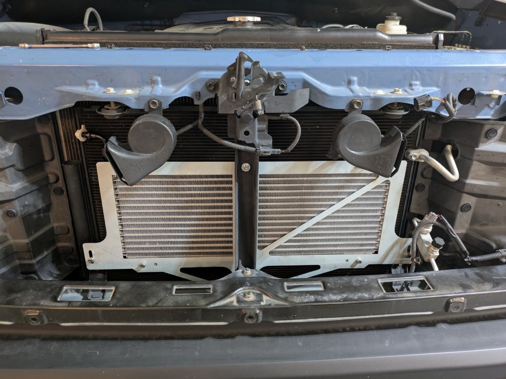

    Update since it has already been 2 years since starting this thread/installing the cooler.
    I've now added around 17k miles to the truck, quite a bit of towing and no issues.
    A few things to comment on:
    • No issues with A/C performance from the larger trans cooler. I'm in SC, so it gets plenty warm here.
    • No issues with engine cooling performance. I monitor coolant temps consistently, they remain 190-200F during normal driving, etc.
    • Transmission cooling performance: The key objective was to keep trans temps down. I monitor pan temp all the time while driving. I am also able to see which gear the trans is in and if the TC is locked via the scan gauge. Very happy with how everything turned out.
      • Initially i left the inline thermostat to operate as normal. This yielding pan temps in around 192-195F while cruising down the highway. Anytime the TC unlocked (even while idling at a light, cruising slowly), pan temps dropped to 185-188F. I was (am) very happy with this. The highest pan temp i saw was 199F where i was climbing a few mile 6-7% grade in 3rd gear (no TC lock) while towing a trailer. Very acceptable in my opinion.
      • After debating, i went ahead and pinned the thermostat this past week in preparation for towing over the weekend of the 4th, just to see what difference it would make.
        Now, pan temps warm up to around 150F (warmer puck is still in place as normal) then usually settle around 155-170F. Towing (6k TT) and pulling hard with the TC unlocked yielded a max temp of 175F which then dropped back down once the TC locked again.
        For the time being, i'm just leaving the thermostat pinned. From what i can tell, the TC has no problem locking even when the trans temps are low (my 5th gen 4runner would not shift to 5th/lock the TC until temps were over 100 or 120F-ish), so as of now there seems to be no disadvantage to pinning the thermostat.
    On the highway with the rolling hills i've tended to tow the travel trailer in S4, then drop it S5 on the downhill/flat sections.
