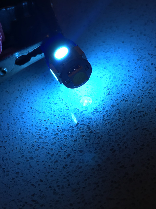

    Had a set of headlights to do so I tested one of the bad bulbs with my 12v bench supply.
    https://youtu.be/jBrpBIyCreU
    And eventually it died.
    T
    he other two bulbs held steady for 10+ min.
    Filthyphil likes this.
