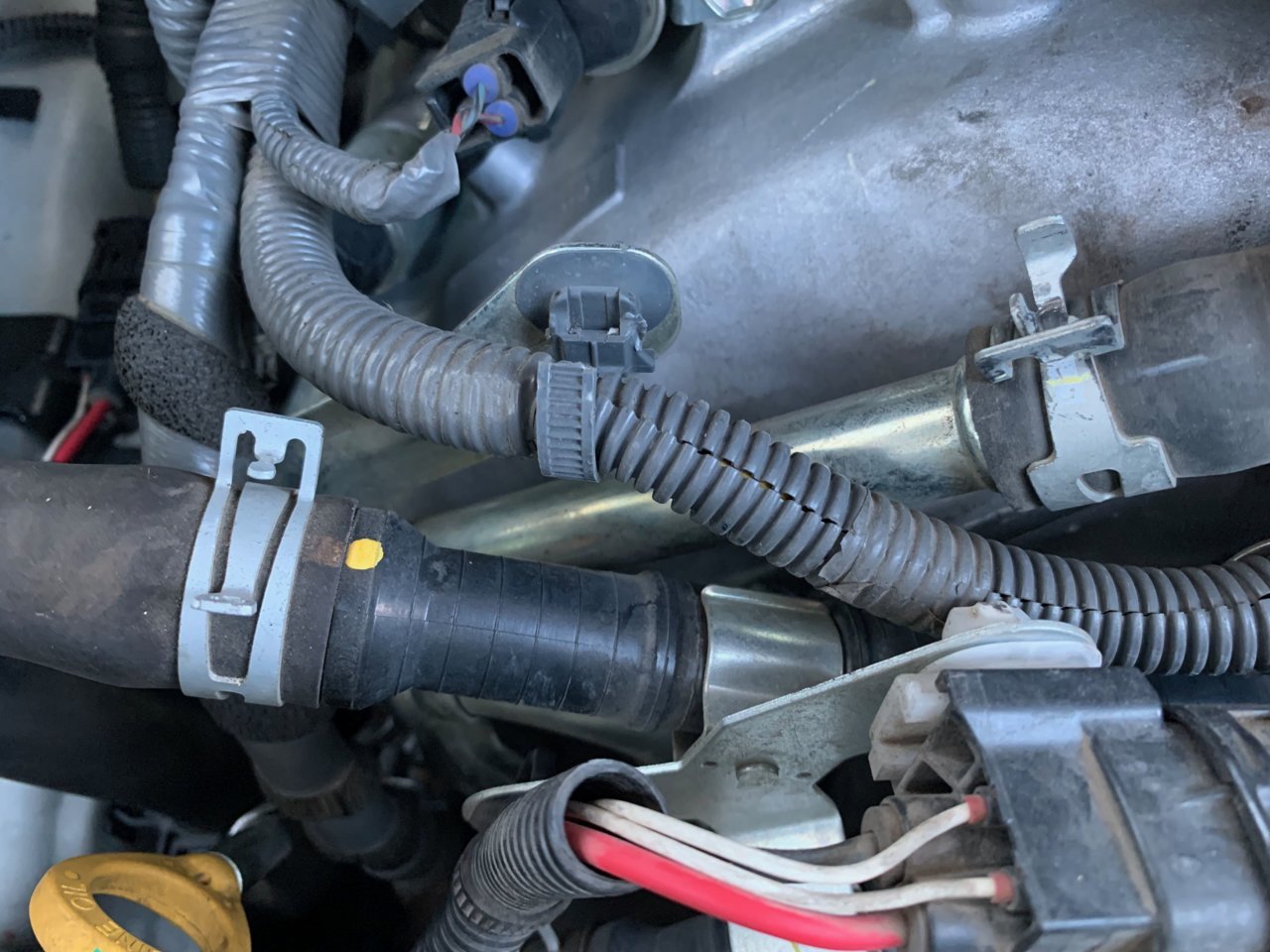

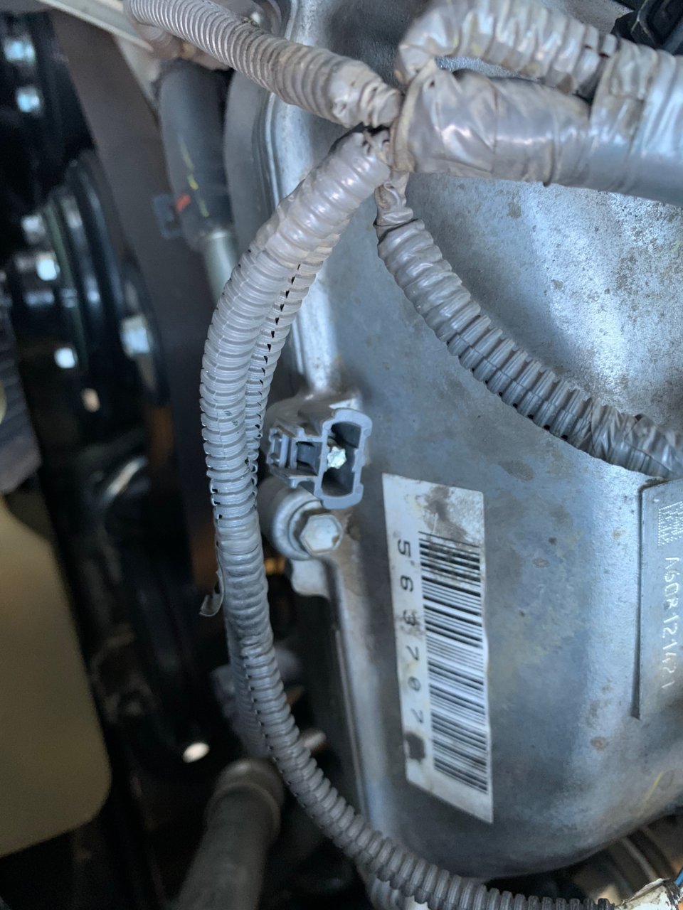

    My Tundra has had the valve covers off in the past and, as a result, has several broken clips that hold the wire harness to the valve covers.
    I'm looking for a parts expert that might be able to get me part numbers for the attached engine harness clips.

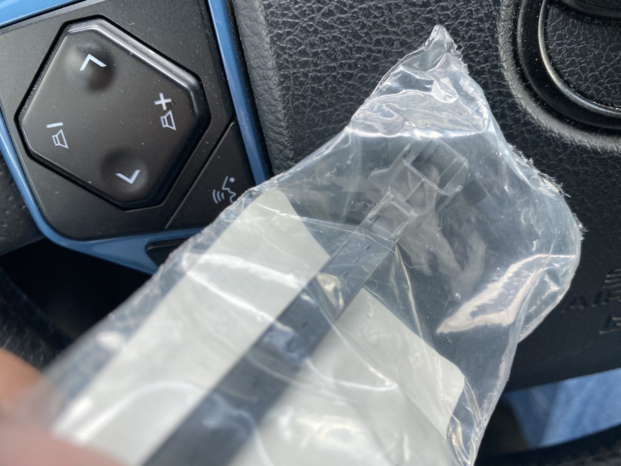

    I can only help with the one in the middle picture. I am still looking for the others though... may take a bit...

    Thanks @ElNopal - The clamp in the first picture has the number 50210 on the inside of the strap. I'm not sure if that means anything relevant though.

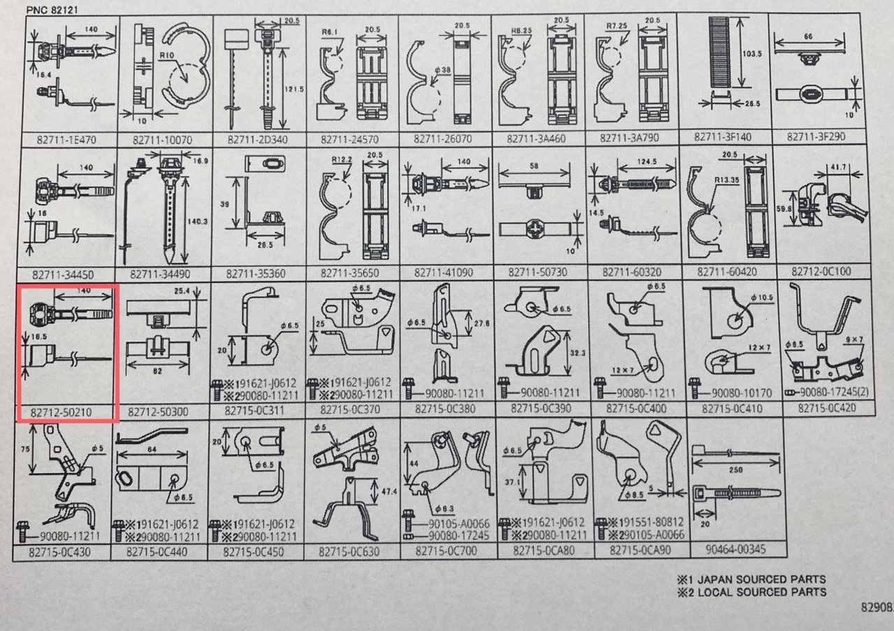

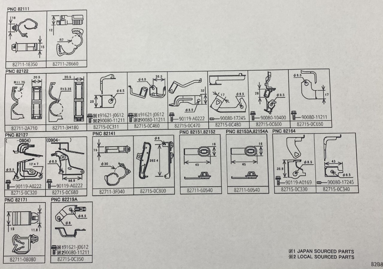

    Okay, I have not forgotten...
    I needed more help and my stealership guy was out for the holidays. We looked some more and couldn’t decipher much more.
    The following are schematics from his parts screen. Toyota is not typically that great about where some of these parts “go” but instead just group them, like what is the case for this situation (engine harnesses).
    The number you relayed appears with a prefix of 82712 and is boxed in red.
    I apologize for the delay. Let me know if you think I can be of further help.

    Thanks for the help @ElNopal - These parts showed up today.
    pic 1: 82712-50210
    pic 2: 82711-2C250
    pic 3: 82711-34450
