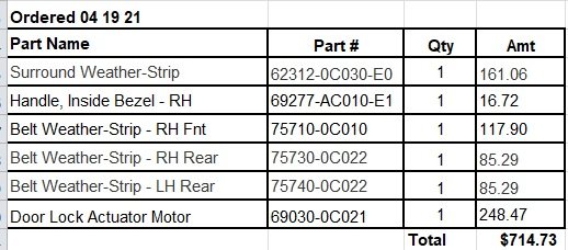

    75720 is for DC and 68210 is for Without/DC.
    LF: Toyota 75720-0C010 Moulding Assy, Front Door Belt, LH | Toyota Tundra Forum (tundras.com)
    Changed mine a couple years back on my 04 DC from McGeorge.
    If you deal with McGeorge, be sure to provide VIN # and email address. They are good about answering back if you by chance selected wrong part.
    2001-2007 Toyota Door Window Belt Weatherstrip (Left, Front) 75720-0C010 | Toyota Parts (mcgeorgetoyota.com)
