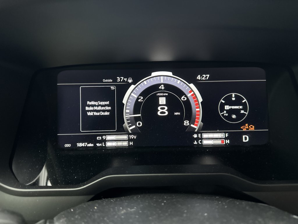

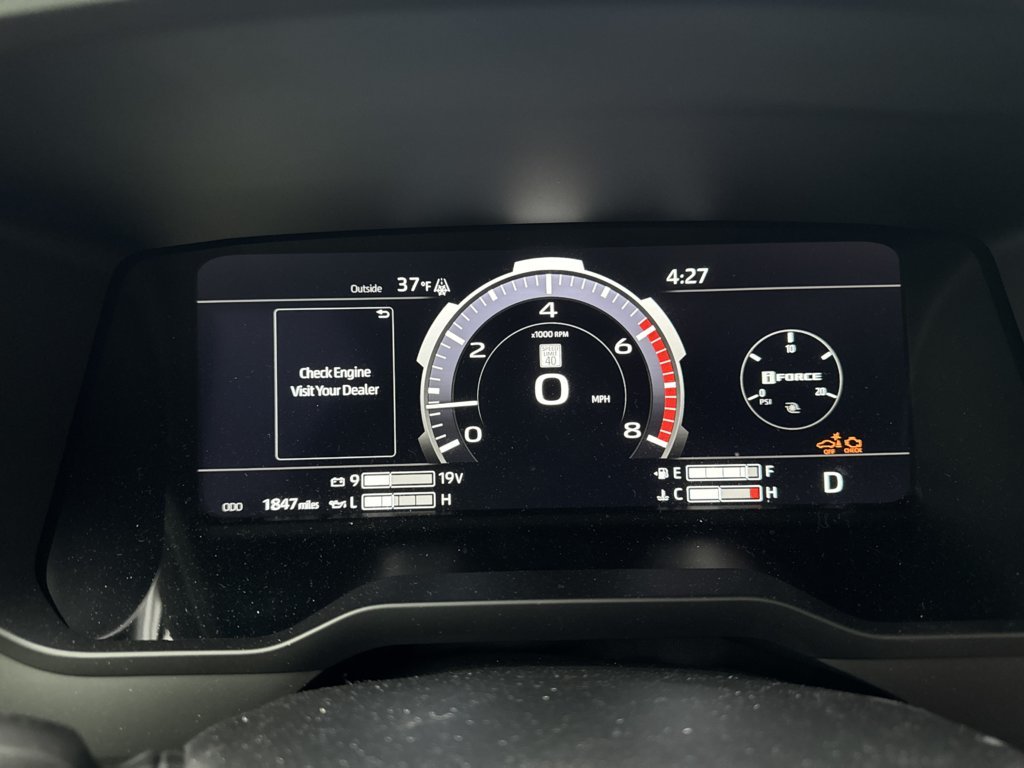

  13. Feb 12, 2025 at 4:11 PM
    #43
    tweezy
    tweezy New Member
    Feb 12, 2025
    #130231
    15
    Penna
    2024 Blueprint Tundra 1794
    IMG_1321.jpg IMG_1322.jpg This happened to me yesterday leaving work I have both lights on at every start up now. Appointment for the dealer next week.
    my truck is a 2024 model year with an April order date and June build date. Just shy of 2k miles on the just almost 3 months of from my purchase dates
  14. Feb 18, 2025 at 2:19 PM
    #44
    tweezy
    tweezy New Member
    Feb 12, 2025
    #130231
    15
    Penna
    So leave work and all my codes disappear. I get to the dealer after driving about 200 with both of these codes on.
    They scan the port and it’s a code for leak detected in the gas. They stated the gas cap wasn’t sealed all the way. Cleared the codes and sent me on the way.
    I live on the border of PA / NJ where they pump gas for you they have seen this numerous times the tech said.
    Cleared the codes sent me on my way
