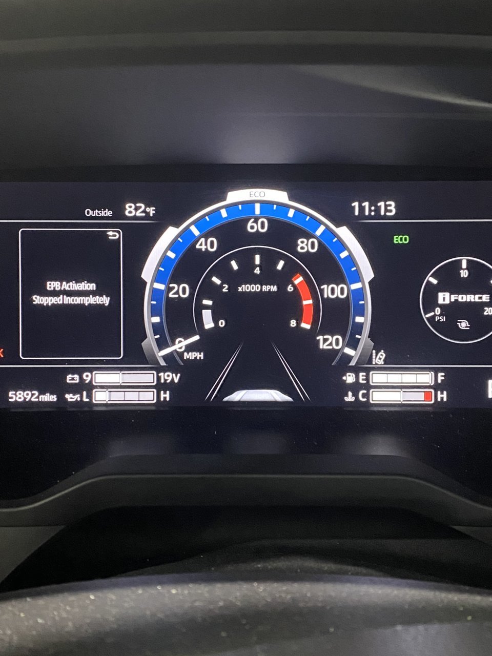

    I keep getting a parking break, cruise control malfunction error code. Toyota has no idea what's wrong and has not been able to fix it. Anyone else having this issue?

    Does it actually say "break" on your dash, or is something broken when parking?

    Turns out it was ABS Module. Once replaced it works fine.

    I have the same issue, been going on for a couple weeks, I don't drive much as I work from home. Usually turn it off and back on resets it for a short term. Also seems to be heat related, living up know we recently have warmer weather and it is acting up more often. Your last statement says ABS module, good to know. Thank you.

    I have this pop up occasionally but it goes away when I engage and disengage the electronic brake

    That tends to happen when you don't pause long enough between shifting into Park and shutting the truck off. If you shift into park and then immediately turn off the truck, it doesn't give the Emergency Parking Brake (EPB) time to engage before the truck shuts off.
    Just give it an extra second (literally...that's about all it takes) between putting the truck in park and shutting the engine off.

    that’s probably what it is. I will definitely keep this in mind.
    Thank you @KroppDuster
