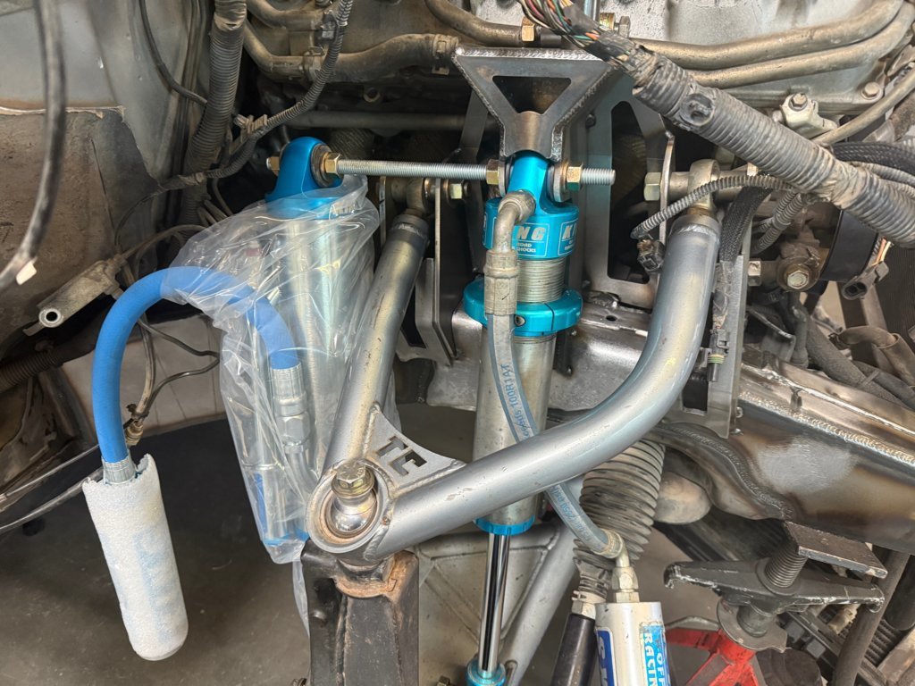

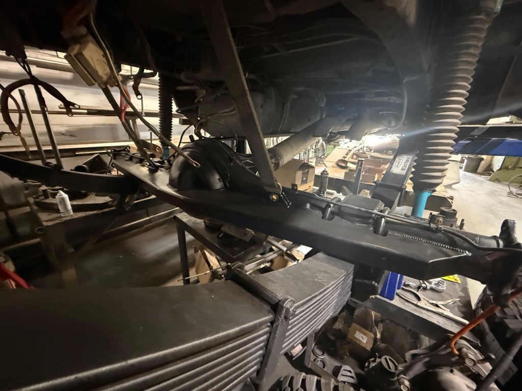

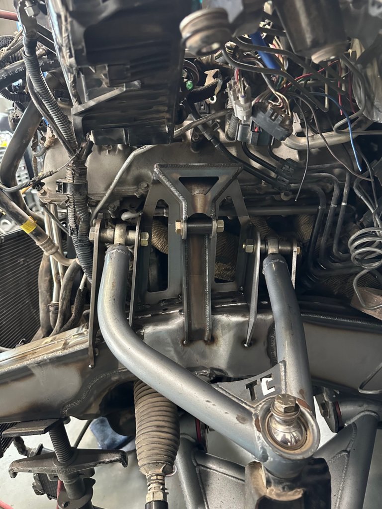

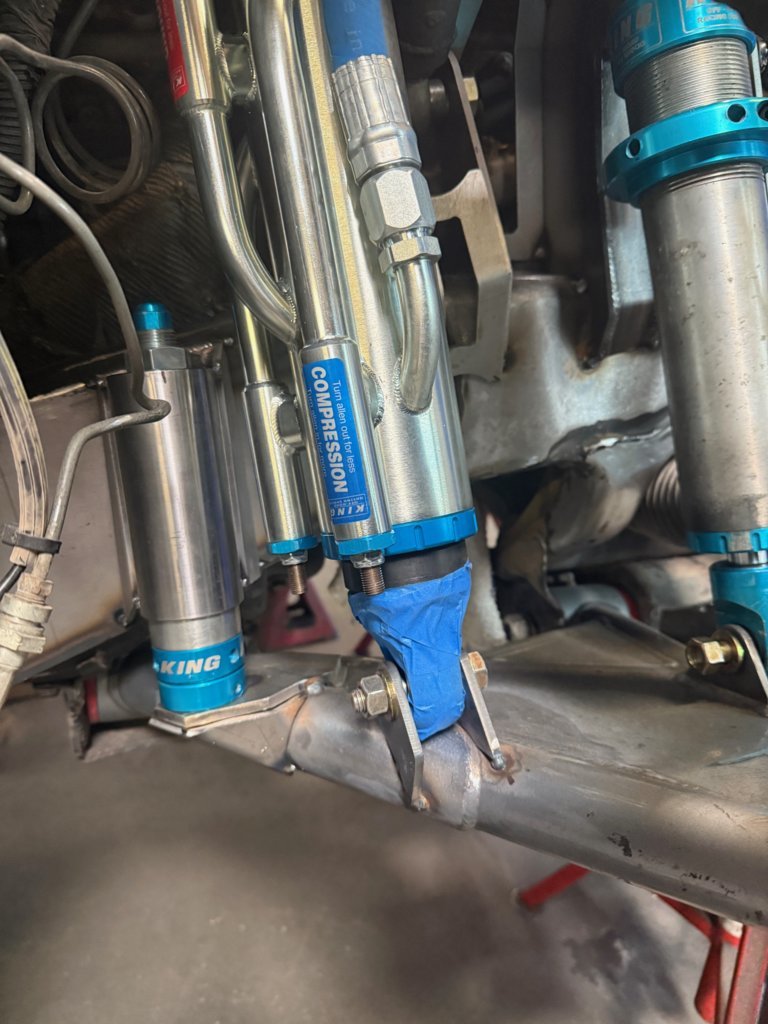

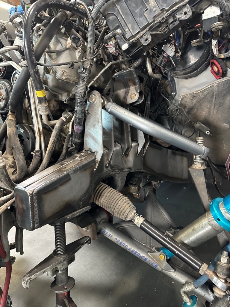

    And the rebuild is complete....
    new upper and lower control arms uniballs, and new hardware with new misalignments
    new rotors and pads, and fully refreshed shocks back in...
    and now shes sitting on the ground.
    What's left :frusty:
    New wrap - this is delayed till after Tundras to Sedona due to delays in materials :annoyed:
    New storage boxes for tools, spare parts, recovery gear had to rethink this since I changed out my back seat... but I have a plan. :spending:
    new onboard water pump to be swapped (old one gave up the ghost):boink:
    needs a bath:mudding:
    figure out why my 5150 whip isn't working, I'm told they are sensitive with ground connections, so need to check my wiring on that. :rant:
    Fix gas filler neck:welder:
    Pin trans cooler open:monocle:
    that's it for now :fingerscrossed:

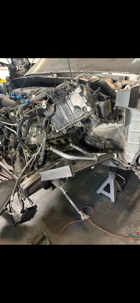

    So on that topic, I ended up with one of his cars. A 2011 Maserati Gran Turismo Cabrio (convertible for the layman), got shipped out here end of march from Maryland.
    It wasn't in the best shape (although nothing majorly wrong), dad rarely drove it only has 11,8XX miles on it, he recently had it serviced but the tires were original the clear bra was 9 years old and the car needed some love both interior and exterior. So what does any car junky do, get to work and have stuff done and mod sh!t! LOL
    The first step was organizing the garage and yes I have a new problem:anonymous:, an addiction to Chemical Guys products to keep the fleet clean. :spending:
    I started with the basics. I took it to my wrap shop where the truck currently is (Pics to follow after this topic) and had the shop remove the old clear bra, detail, polish and paint correct the car, and install a new PPF wrap on the front half the car.
    After that, I addressed the smaller items.
    Tires were original so got on a forum, of course, asked questions like a Newb, and figured out the best tire combo and sizing. upsized the tires 10mm on front and rear and installed some spacers to fill the gaps better. Went with Pilot Sport 4S in 255/35/20 front and 295/35/20 rear. You can see sorta in the first pics that the wheels were inset a bit, so now they are pushed out and the tires fit better than the stock Pirellis.
    Had to clean up the wheels before new tires.
    Then on to the mechanical stuff, figured id let her breathe a little better so installed a BMC air filter and a non resonated X-pipe. If anyone complains about installing an air filter, let me tell you it took me almost an hour for this thing, its not mechanic friendly :frusty:
    So all that being said the car is much happier now!
    Here is a vid of the cold startup with xpipe. :burnrubber:

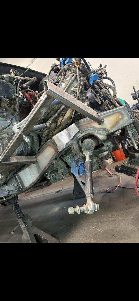

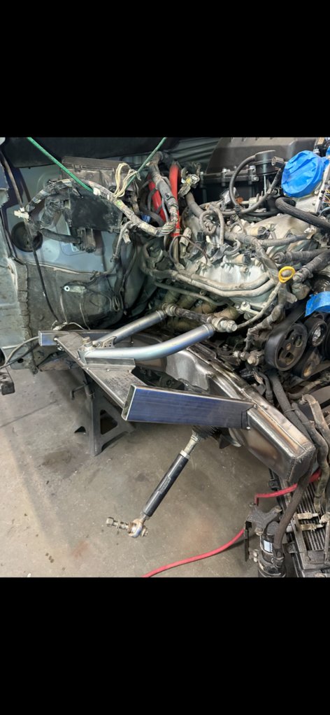

    Well, folks I have been busy and gone for a bit. Not that I haven't been busy with tundra stuff, either, but I haven't had a ton of time to spend on the forums.
    But it's time for another big update. The truck is under the knife again, this time at an off-road fab shop. I'm getting the following things done in the next 6-8 weeks.
    Magnuson 2650 Supercharger
    New Rear Axle full trussed
    The front end is gonna be fully tubed (removing all stock sheet metal)
    Rehanging fenders, lights, hood mounts etc.
    Custom wheel wells (with all the fuse boxes and accessories removed to be mounted to the new front cage)
    stock shock towers and TC bypass hoops removed
    New 10" 3.0 coil overs and 10" 3.0 bypasses
    New mounting for shocks and bypasses
    front top mount bumps mounted
    New hard-mounted seat mounts and harness bar tied into the B pillar
    I'll post pics as I get them.

    07 Silver Sky 4x4 | Total Chaos LT | 2.5 King Coil overs & Bypasses | Camburg Bed Cage | 3.0 King Bypasses | 2.0 King Bumps | Custom Deavers | Nitro 4.88's | ARB Locker | Demello Sliders | 17" Double Standards | BFGKO2 37's |

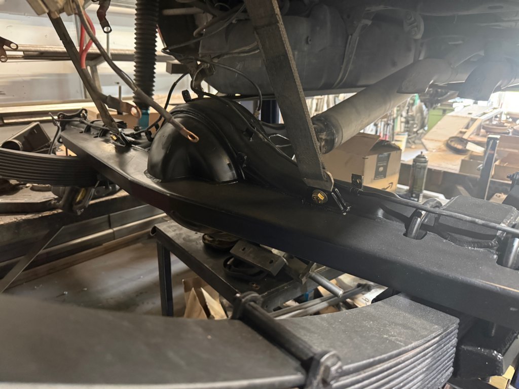

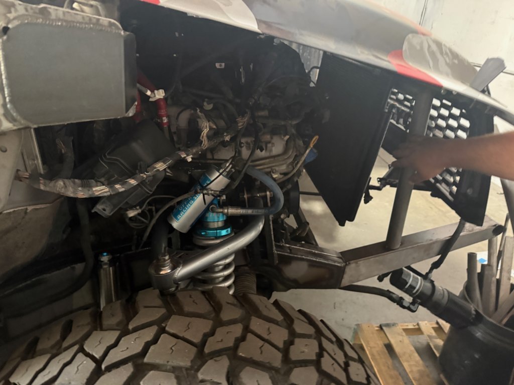

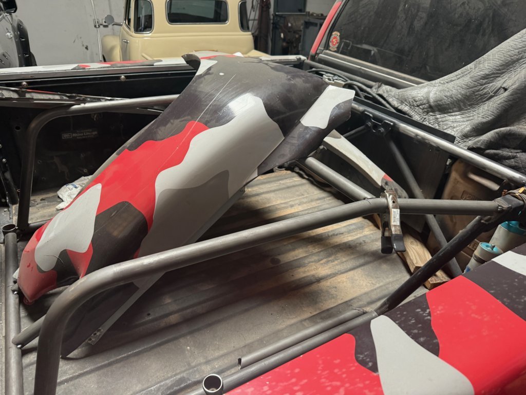

    Status update on the old girl....
    the shop is making
    2650 blower installed.. just seemed easier to remove the fenders, hood, and inner structure for install... just kidding... thats all getting replaced.
    new Rear axle with full trussing, and new mounting of bumps and pads, and limit straps.
    the front end was bent and cracking
    so they cut off the shock towers, building all new ones, then adding frame plates, and integrating the new bumper into the strengthend frame.
    new front pumps being integrated.
    in the bed we are moving the tires all the way to the back of the bed, moving the trans cooler to the back, and moving the main and house battery to the back as well.
    Lastly now they are starting the front tube work now
