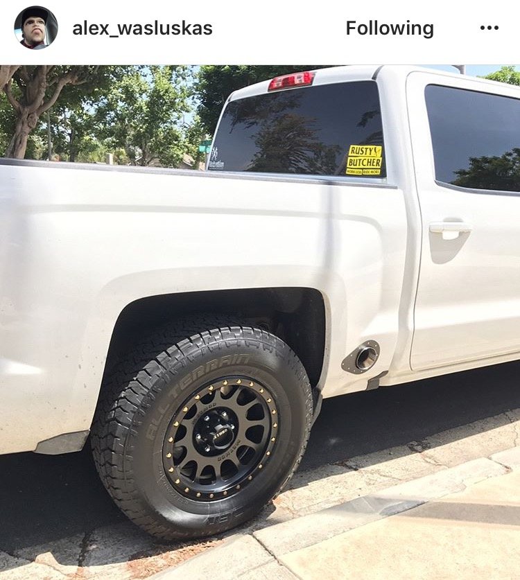

    Do you think your exhaust will cause issues with that strap? I made the mistake of cutting the tip off of our FJ exhaust for clearance and now have a pretty decent melted chunk missing out of the plastic bumper close to 12” away. Just food for thought...

    Thought about it, its pretty far away, but im going to put some short downturns on the exhaust to direct it to the ground.

    Bruce after looking at that last picture of your bump, I take it back. You have similar distance to the frame at full bump as I do.
    Don't point it straight down to the ground. It blows straight onto the dirt and kicks up a massive dust cloud at WOT and when you turn on your truck. If you have your door open when you fire it up, you'll have a cab full of dust. I had mine like that and it was obnoxious. I cut it again so that its more like a 45 degree downturn and its much better. Still kicks up dust, but no where near as bad as before.

    Agreed I just re-did my 2017's exhaust this way, much better, going to do the same with my 09

    Haha..... I learned that one the uhhhh,,,, dusty way too. It was kinda cool the way it blew the leaves off the driveway though.

    @osidepunker @Bo-Hunter @831Tun thanks gents good to know! Deff don’t want to create a new problem.. I’ll look at some 45 degree options.. I could run them to the side of the truck and put the bed side like this...

    I'm a neophyte compared to what you're doing. That said, would the side exit allow for the flex/ movement of the various components involved??

    nah wouldnt change anything, and it actually wont work because the leafs would be in the way..
    look in this picture where the muffler ends in relation to the leaf spring. the fender is further forward. id have to move the muffler and other stuff, thats a lot of work for something that has an easy fix. Would be cool but wont work.
