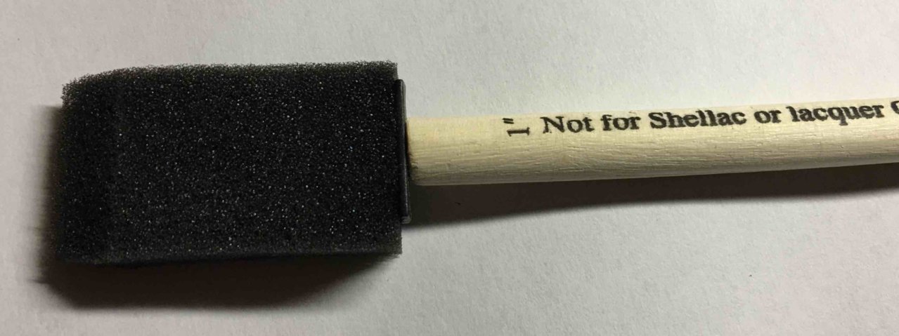

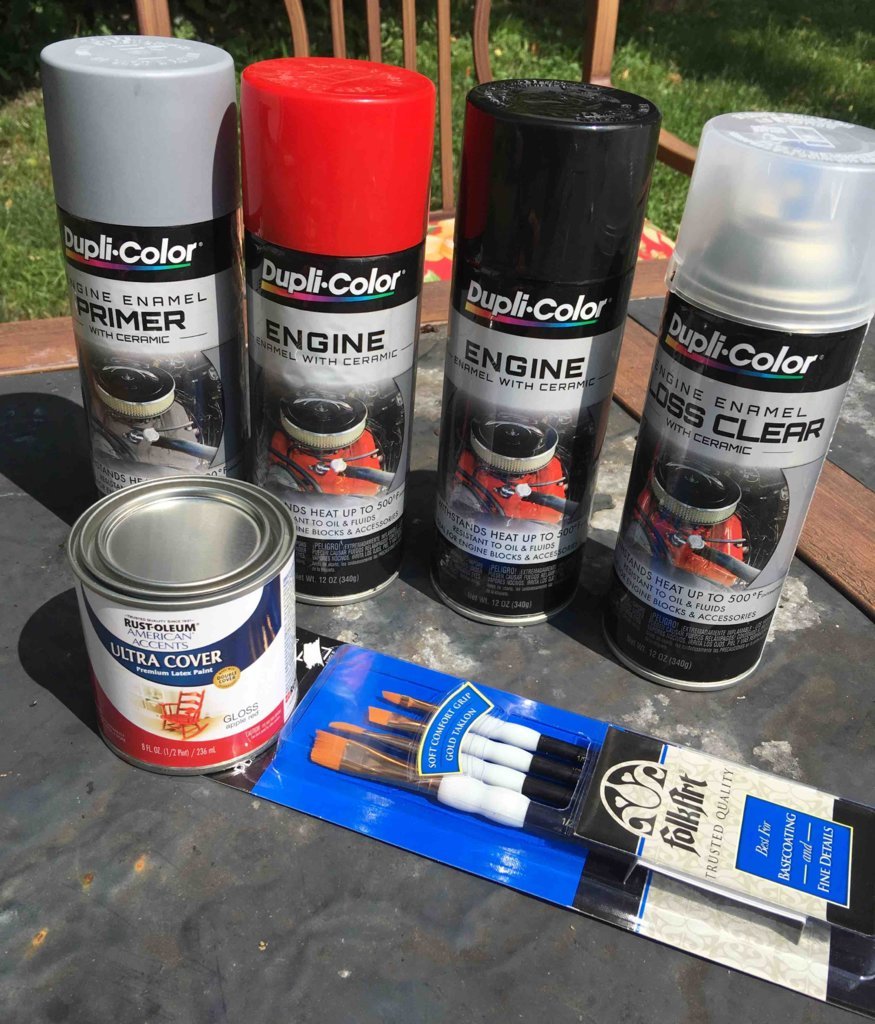

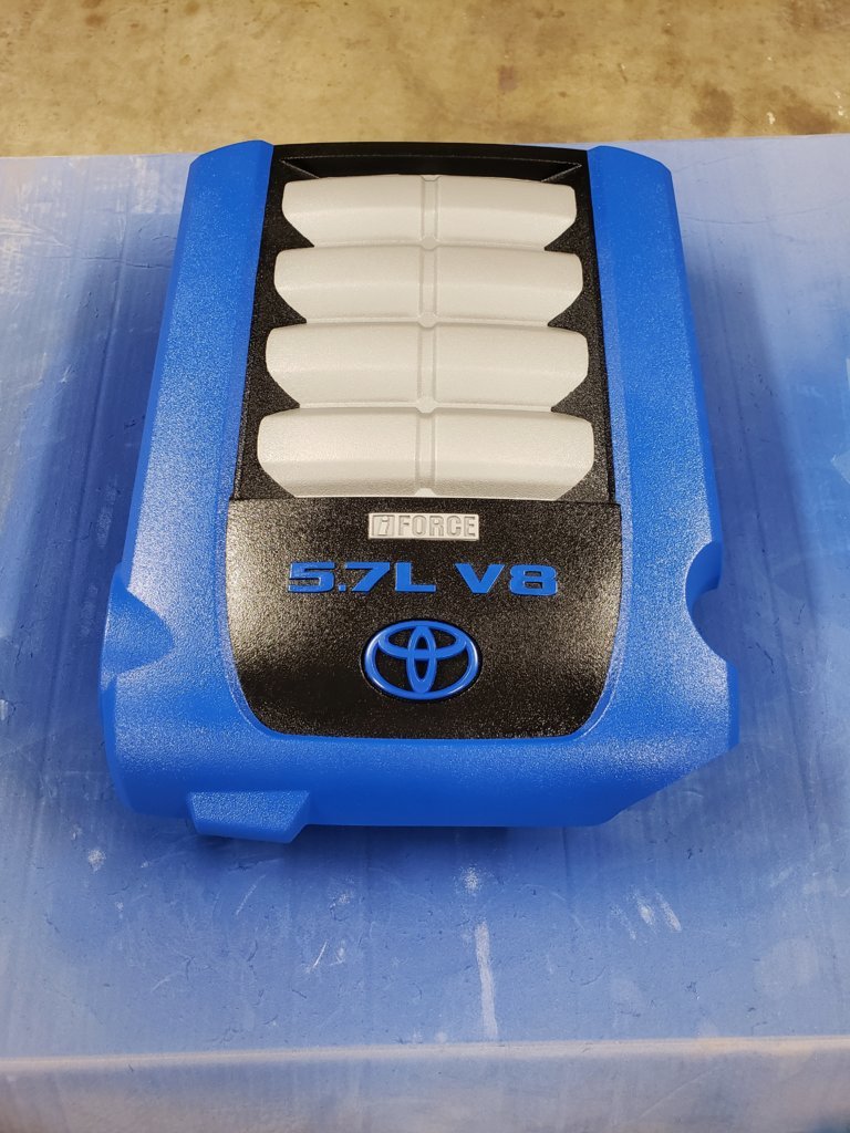

    Ron and others were a very bad influence on me to spend time and money on this mod. The second gen engine cover is silver, so I painted it black first. Here are paints I used.
    First I used paint brushes, but I discovered that it's easier to use one of these.

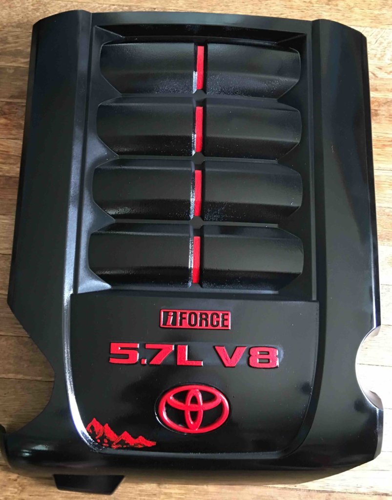

    I was not as patient as Ron, so even though I let the base paint to dry overnight, when I put some clear coat on it, it became milky. So I had to repaint the black part.
    Final result.
    Installed.

    Chphilo how did you get just the letter red? Brush? I would like to do close to what you did. Nice job

    Did you tape and spray the 4 red lines or paint brush it

    I used the brush shown in the picture for the letter. Then I used sponge for the iForce letter. In hindsight, using the sponge for both would've made it a lot easier.
    I paint brushed it. Since I was just going for four short lines, I thought it would be easier to use a brush. Man, it took a long time especially since I am not too good with brushes.

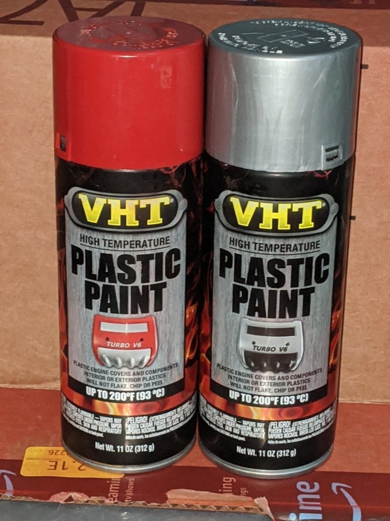

    old (zombie) thread, and apologies in advance, but what paint did you use for the various colors?
    I’ve seen some RC hobby paints specifically made for plastics, but not sure how they’re going to hold up in heat!
    Krylon, VHT (and probably others) have high(er) heat plastic paints that may/will be better.

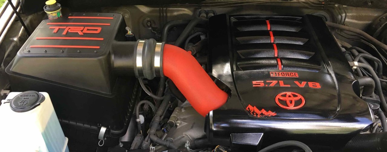

    Didn't know this thread existed. The person you quoted hasn't posted since Jan 2024 but he may still respond.
    You definitely want a high heat paint. A few of us have used the VHT high heat paint and it seems to do well. (Image of cans is one I saved, I used the same products just not the red). Image with the intake cover visible is after about 2 years of painting the engine cover. Photo of just the cover is right after painting it.

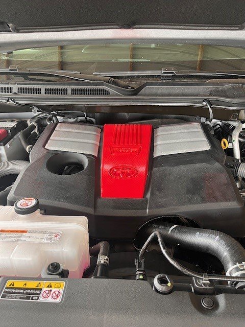

    2025-should I leave the unpainted as is or paint black or possibly silver?

    Have no idea what pieces you are asking about. But in the red: I'd personally paint the T logo black or silver, the rectangular stamp above that (no idea what it says) something besides red, and those vertical lines at the back maybe silver to match the sides.
    Besides that, it's all about what you want.
