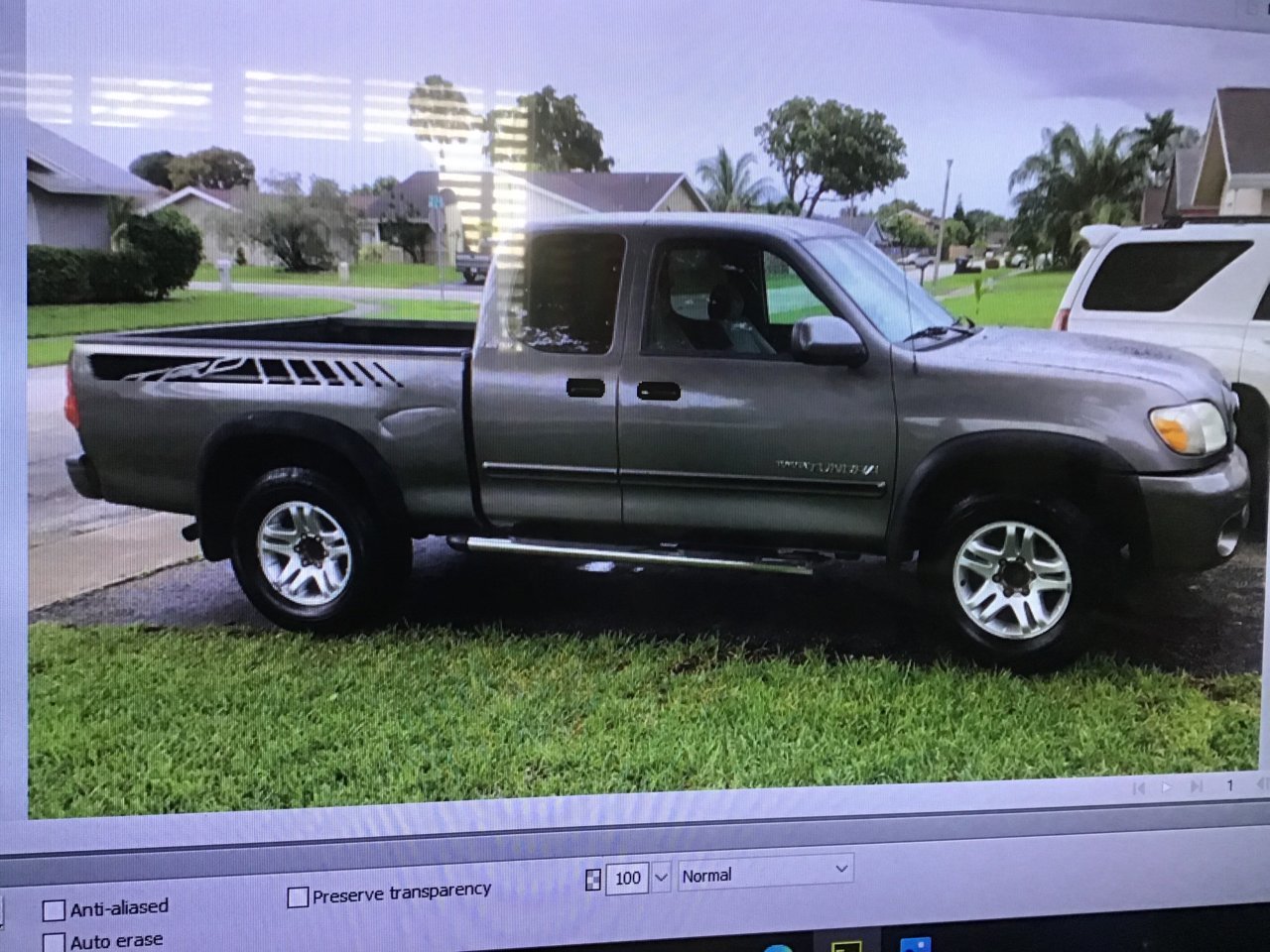

    Thanks For the feedback guys, Much appreciated! I”m pretty happy with it so far. The more I look at it, I’m thinking I have to black out the badges now, Door handles too. Maybe spray bedliner and then top that with the jet black like in the front.
    Only thing I’m not sure about is the door jambs. I was thinking about spraying those areas with my airbrush, but I’m not sure. I don’t think I would be able to airbrush the clear coat and have it look right. Still working it out in my head I guess.

    Glock40 What do you think of this? I photoshopped the trd symbol and blacked out the handles. Too much? It’s not a trd but I would cut the stencil to say tun

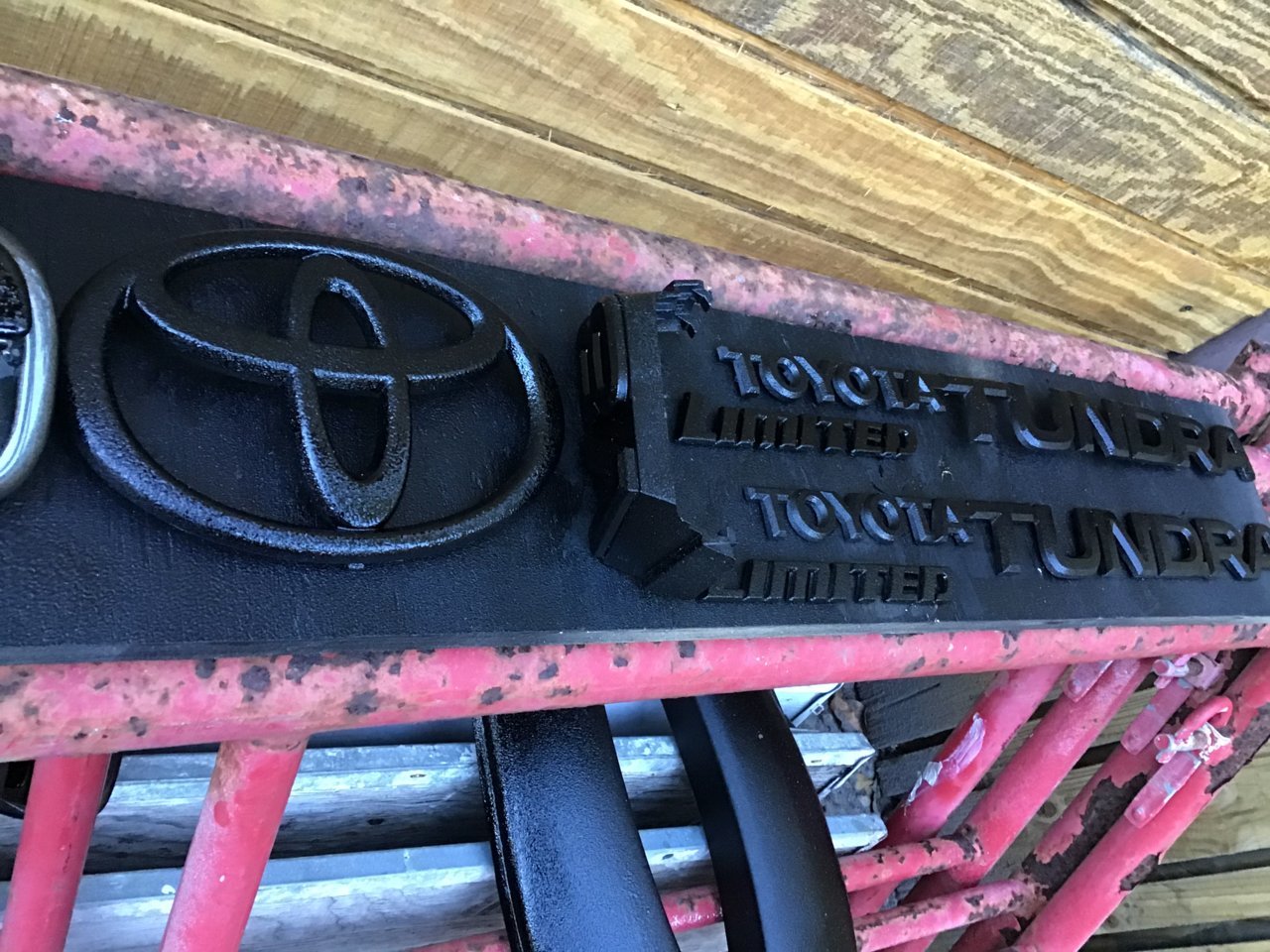

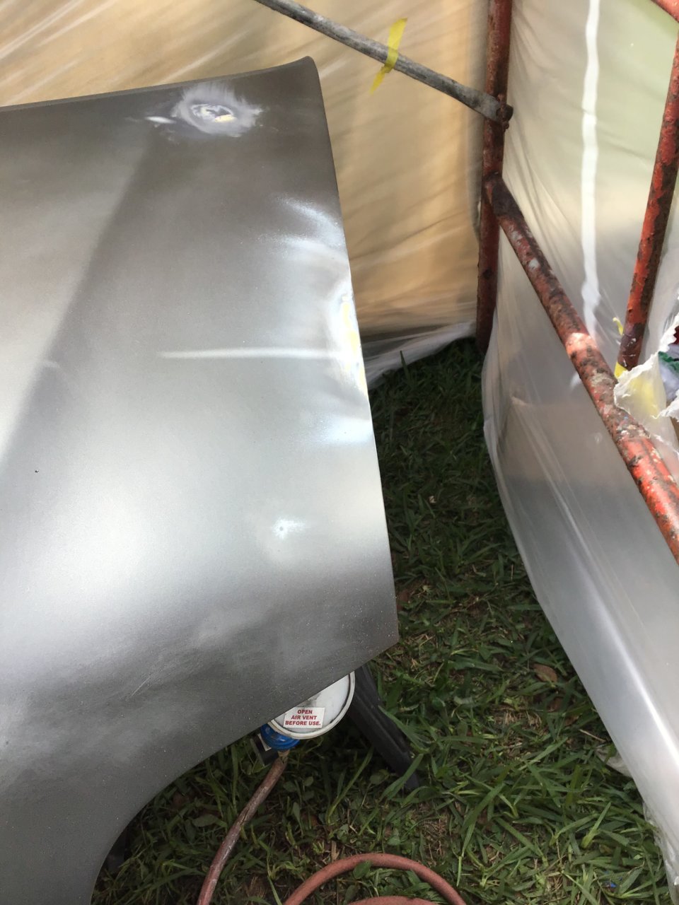

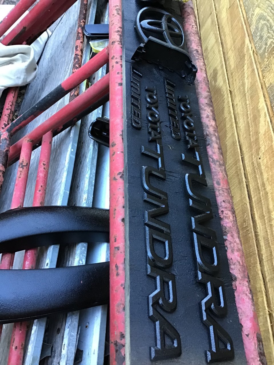

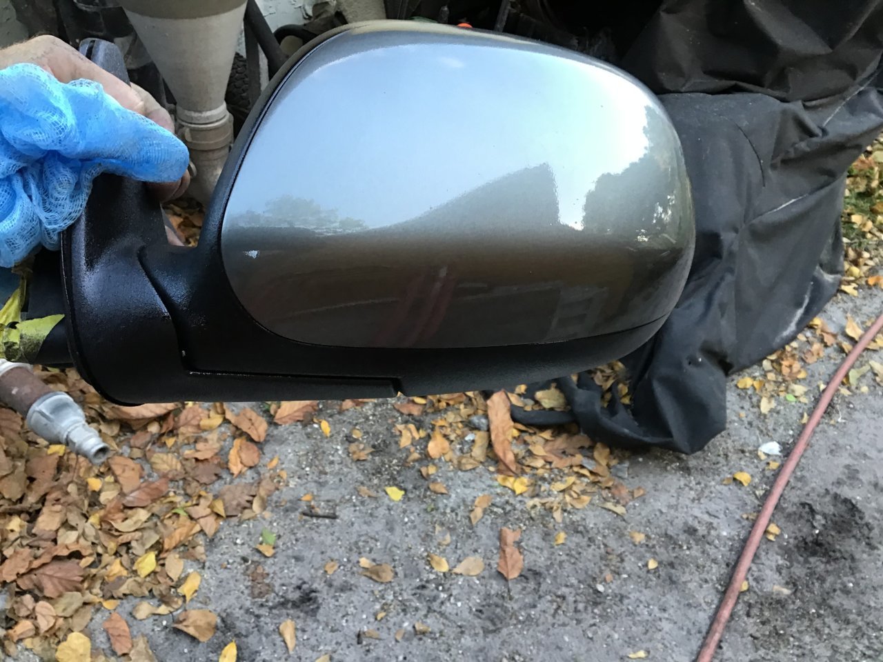

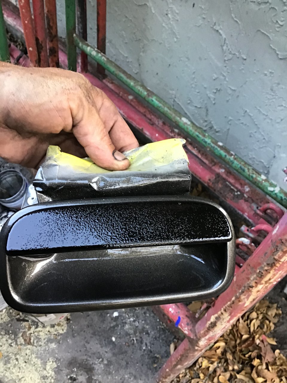

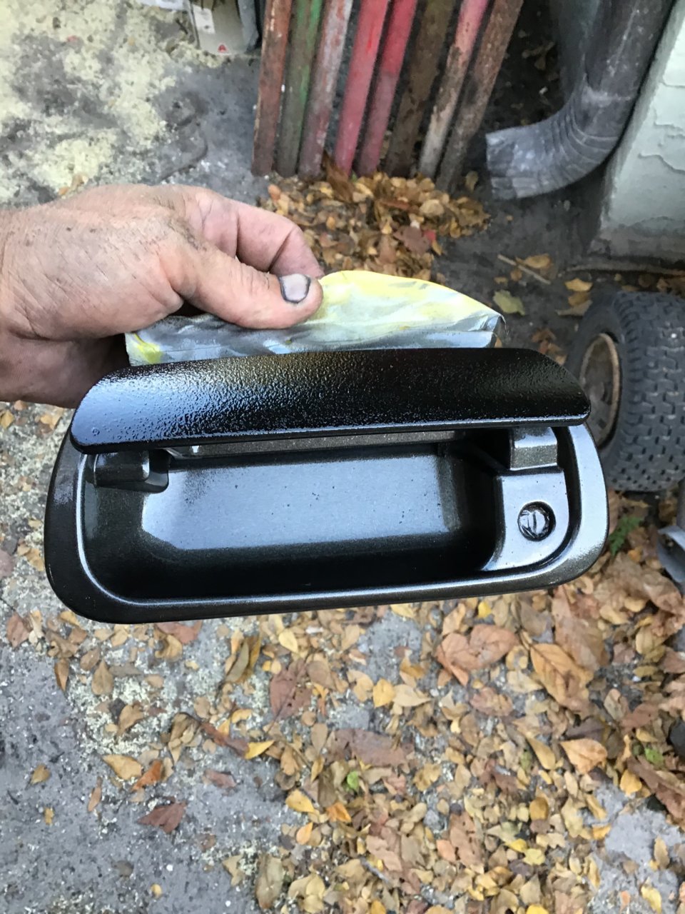

    Got to the door handles, mirrors and most of the trim today. Coming along nicely so far with minimal issues. I did the base of the handles a couple shades darker than the body, then sprayed Dulpi-Color bedliner on the handles themselves, then nason jet black bc/cc on top of that. (adhesion promoter between coats). Fenders got re-done the other day too. Didn’t get pics yet, though. Everything super shiny! I think it’ll buff well.

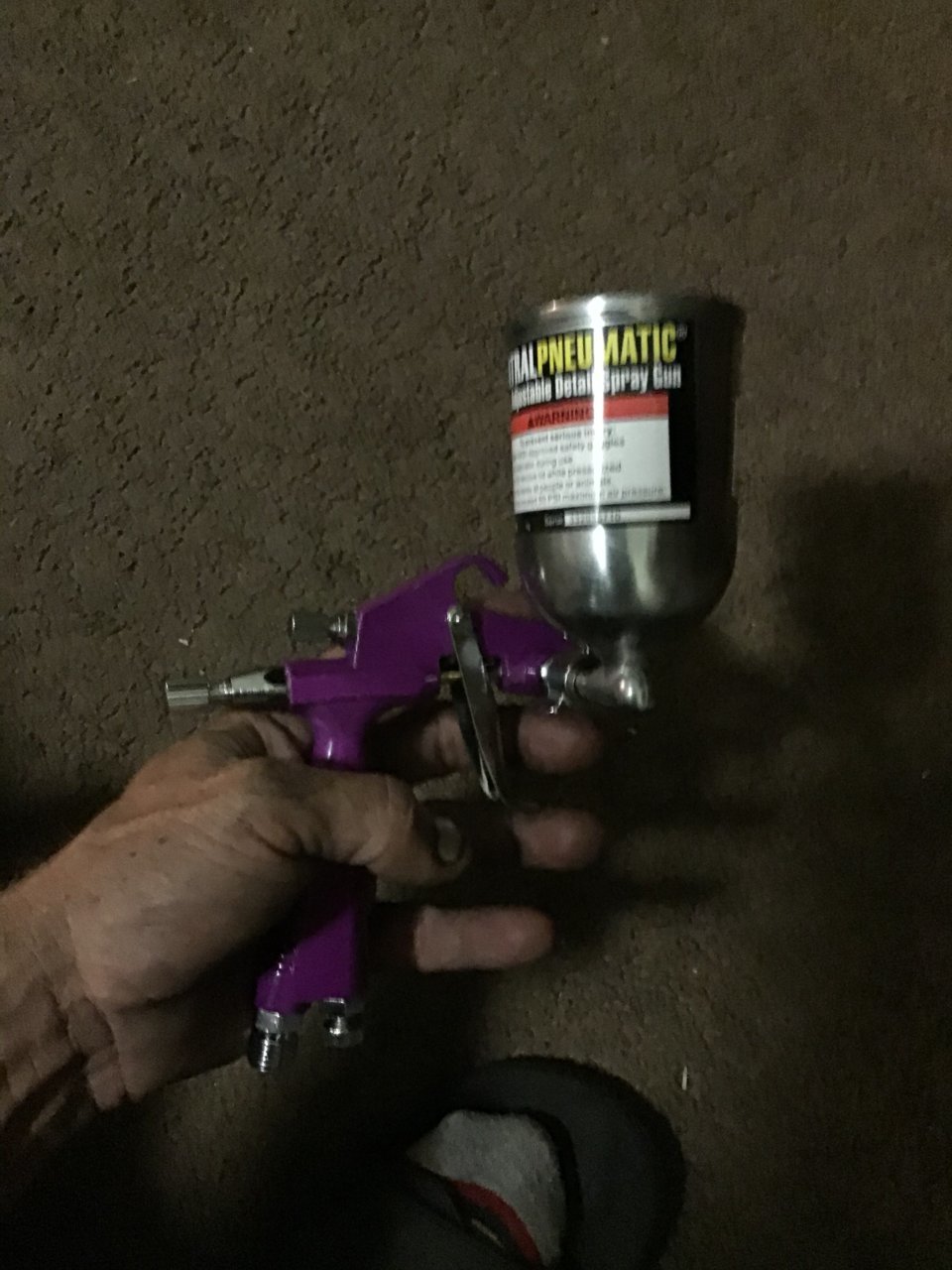

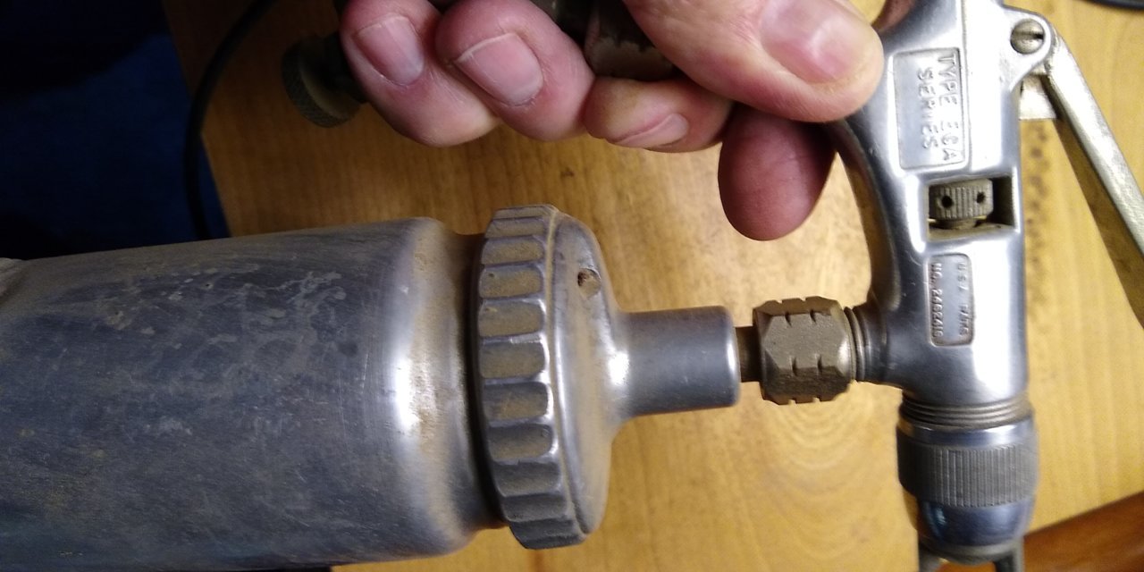

    harbor freight $15 mini-gun

  13. Mar 10, 2021 at 6:35 PM
    #43
    831Tun
    831Tun heartless Bastrd
    Jun 7, 2016
    #3549
    11,597
    Warren
    Santa Cruz
    '16 CM limited
    Curious to know what you think about it's performance.
  14. Mar 10, 2021 at 6:58 PM
    #44
    kenadavis
    kenadavis [OP] New Member
    Feb 14, 2021
    #59095
    40
    Ken
    South Florida
    2006 Tundra Limited Access Cab
    I haven’t tried it yet, just picked it up.
    I’ve seen videos with guys saying it’s great though and their guns are typically pretty good.
    I’ll let u know as soon as the wind stops blowing and I get a chance to use it.
